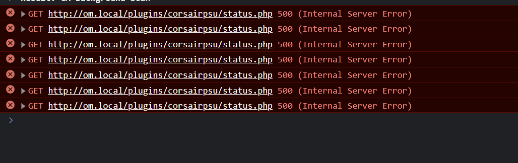

  3. Ok I'm not alone, I was here for the same issue, I see in the browser console, network tab, the post return a 500 error. /plugins/community.applications/include/exec.php 500 (Internal Server Error)

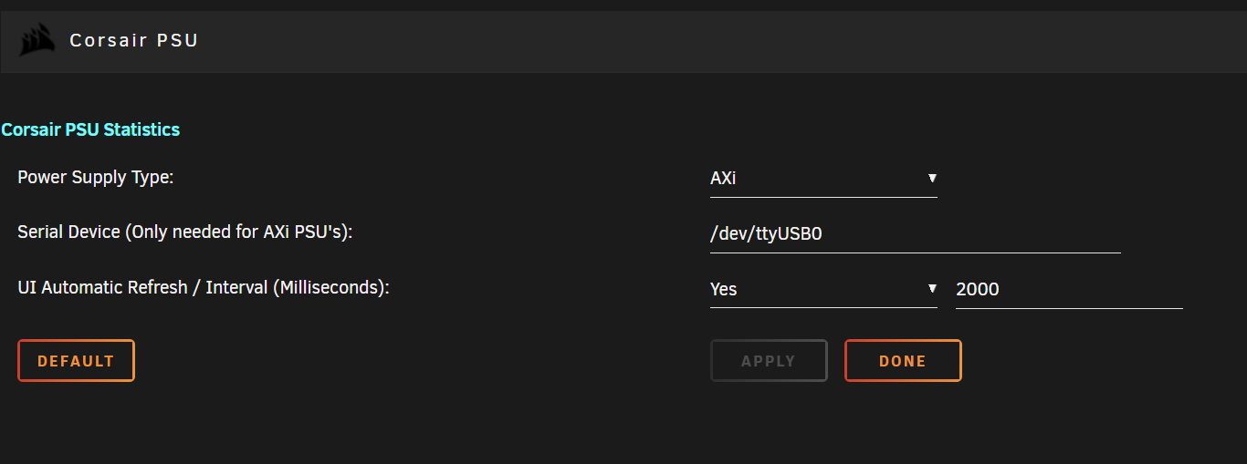

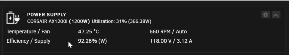

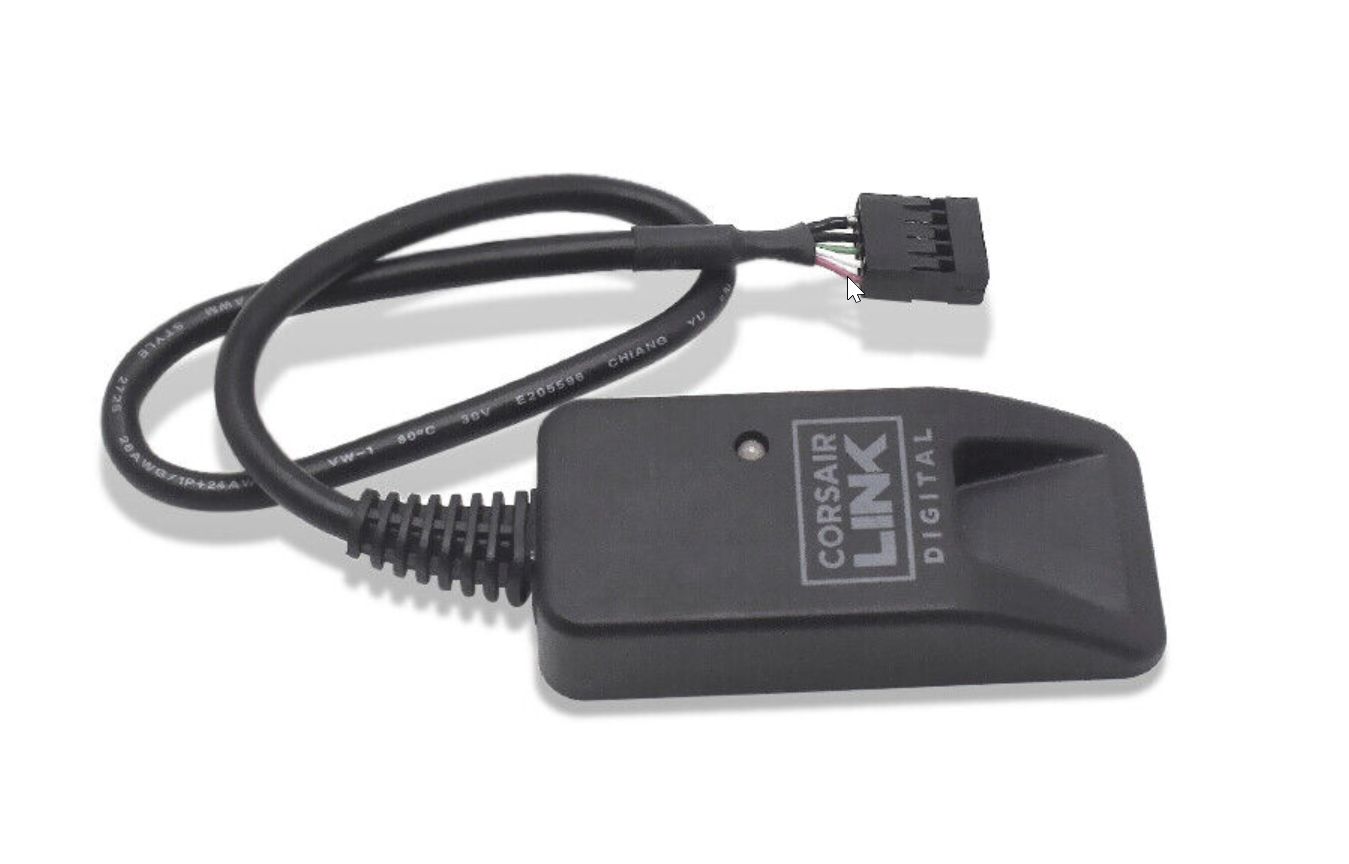

  5. Yes the one that came with the AX1200i, I use a adapter so it is connected to a external USB port.

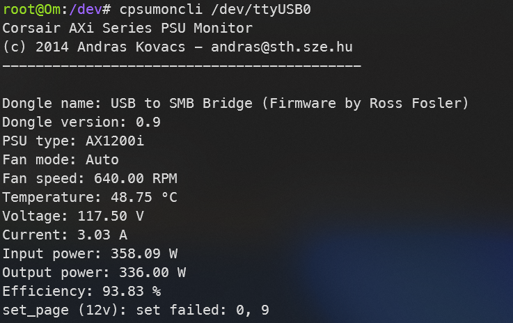

  6. I made a new fork, feel free to reuse my change https://raw.githubusercontent.com/cristiandeschamps/corsairpsu-unraid/fix-cpsumoncli-path/corsairpsu.plg I fixed various issue and added more information. with the AX1200i and maybe other model, the rails are not available. cpsumoncli return "set_page (12v): set failed: 0, 9", I have tried to fix cpsumoncli but I'm not really experienced in c++ but I will definitively give it a shot when I have some time.

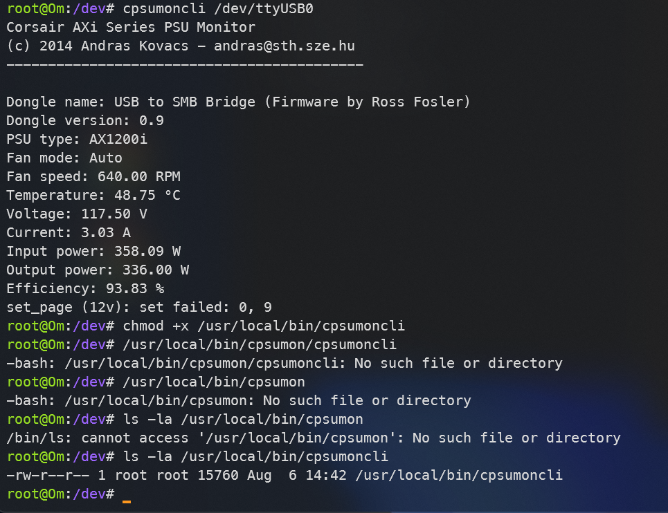

  7. looking at the code, there is something strange, the path seem wrong for me (and from others in previous post) I didn't do any customization.. $stdout = shell_exec('/usr/local/bin/cpsumon/cpsumoncli ' . $settings["TTY"] . ' 2>&1'); https://github.com/CyanLabs/corsairpsu-unraid/blob/master/src/corsairpsu/usr/local/emhttp/plugins/corsairpsu/status.php#L11C35-L11C38 The path correct path should be: /usr/local/bin/cpsumoncli I just forked the code plugins and I will give it a try.

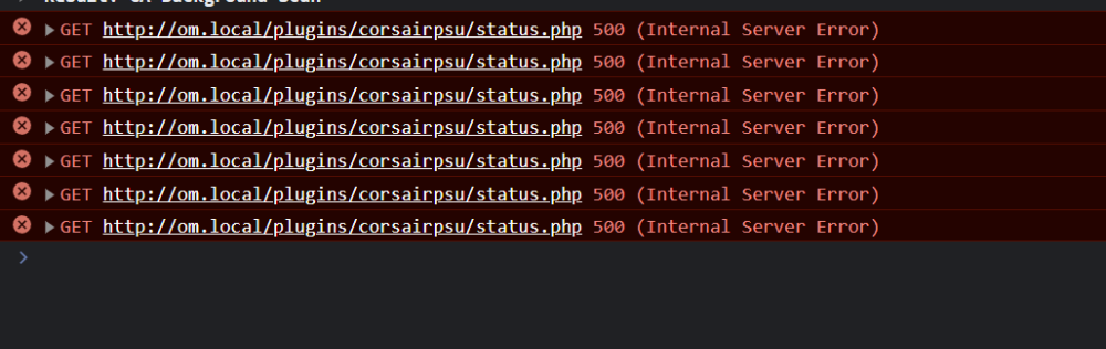

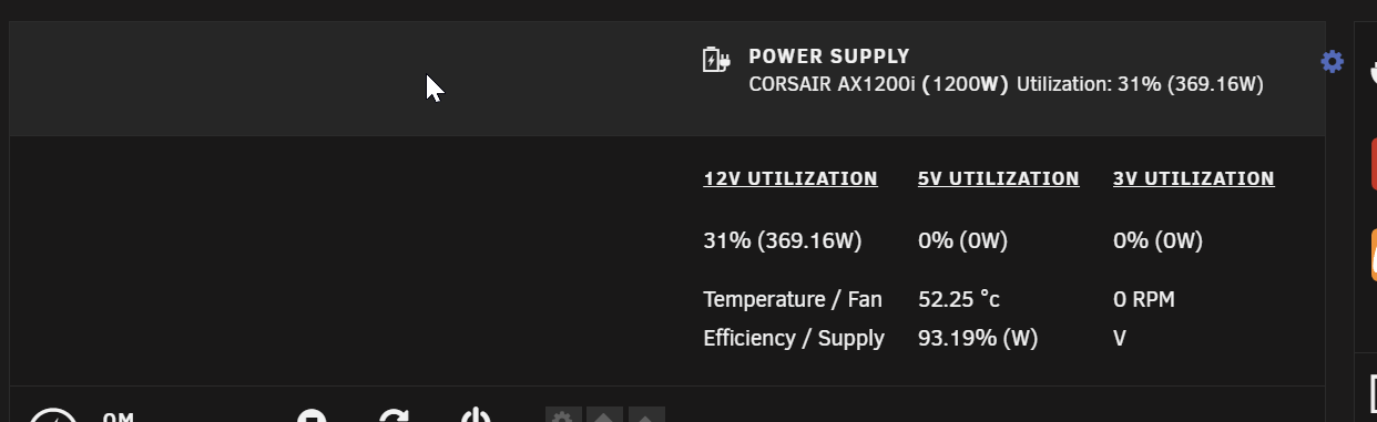

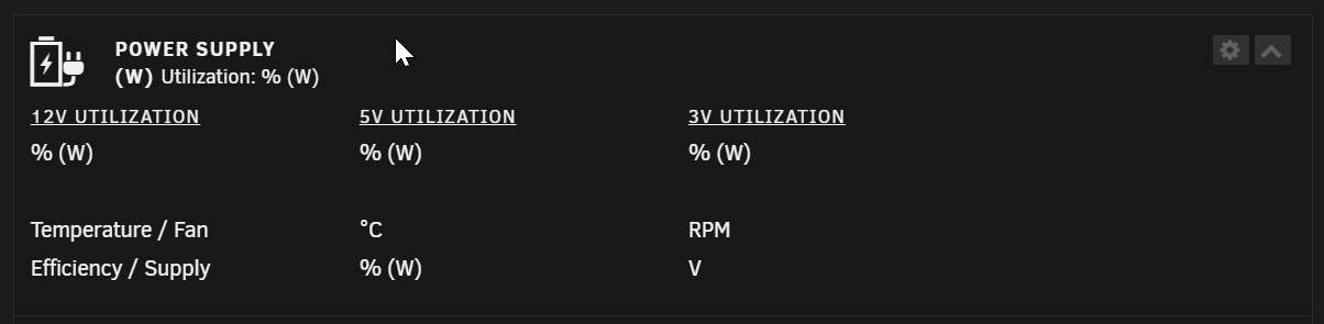

  8. Hi @giganode I have a AX1200i and like the others it doesn't show any data, but I can confirm the `cpsumoncli /dev/ttyUSB0` return the PSU I also needed to run the `chmod +x /usr/local/bin/cpsumoncli` I also made sure I loaded your plugins. But if I try with the old version (https://raw.githubusercontent.com/Cyanlabs/corsairpsu-unraid/master/corsairpsu.plg) And config it (same config as yours) then it works, the only issue is the panel is not compatible with the new dashboard and break the UI. When using your version (https://raw.githubusercontent.com/giganode/corsairpsu-unraid/master/corsairpsu.plg) I see this error in the browser console Maybe that can help you figuring out what is going on for the AXi? Thanks! Old Output New Config
