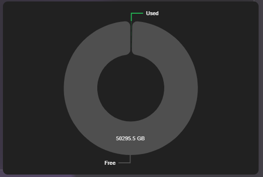

I'm having an issue after installing where it doesn't read the used space properly.
Yes, it's a known bug. You can keep track of it here.
For me is happening exactly the same thing.

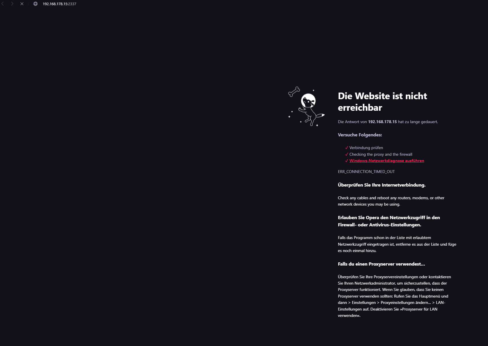

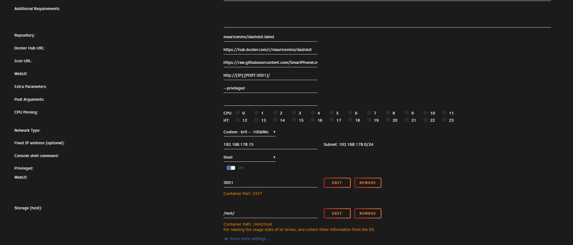

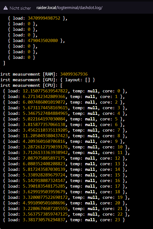

somehow im not really able to use it. i dont know what i´ve done wrong.
if i open the log, its clearly doing something.
but if i try to open the webgui i dont get anything...
Is there a tutorial i can follow? or does anyone have an idea what i´ve done wrong?
Hi, check the documentation. All is there.
In your case, seems you have changed the port but didn't adjust the internal port accordingly: LINK.
In other words, if you want to use another port other than the default one for the internal one, you must declare it with the DASHDOT_PORT variable. After that, you can use your own port.
Edited by SmartPhoneLover

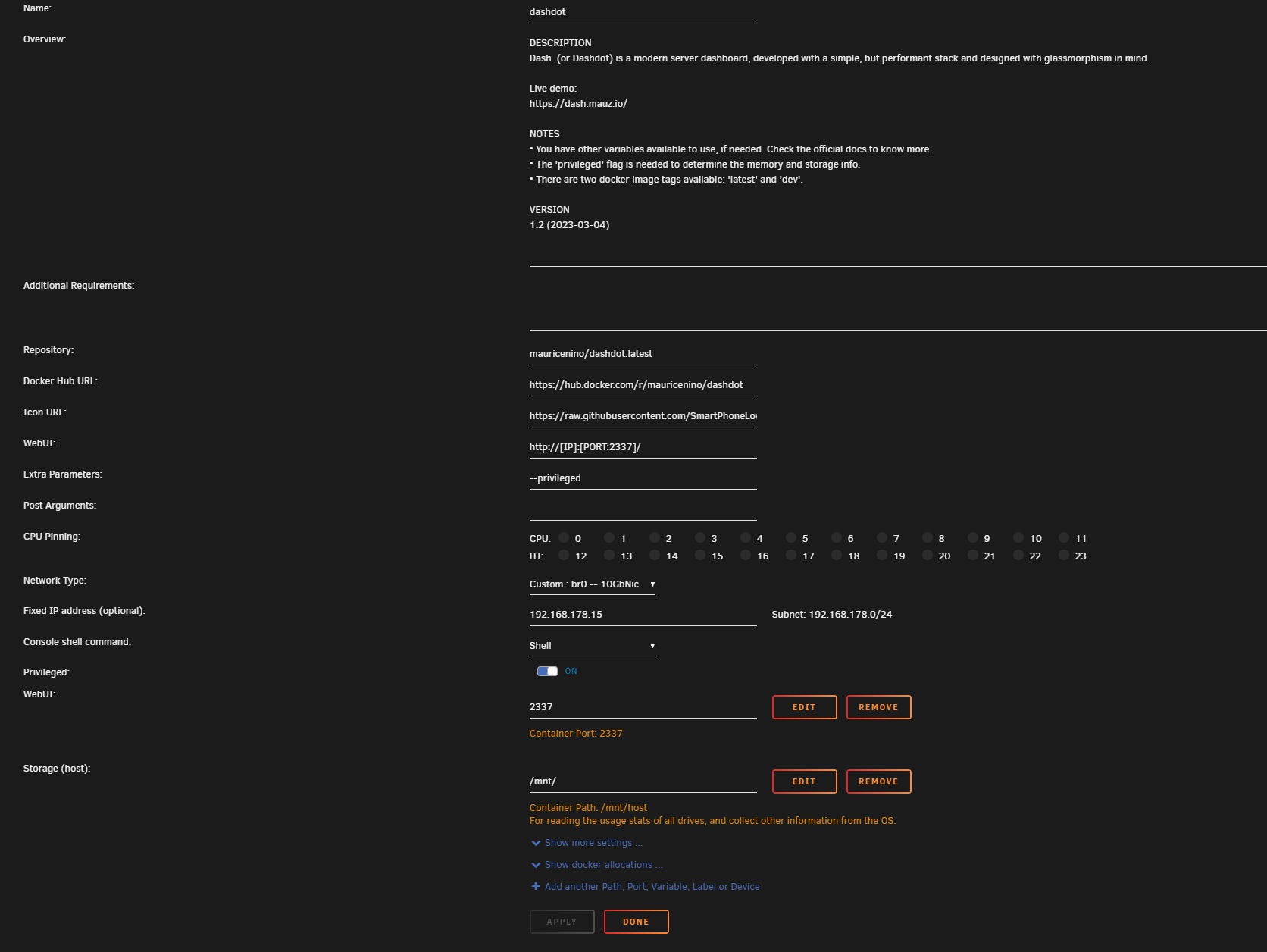

sorry im a noob.
but even if i change the port back it does not work. (don tknow why the orange port number is still the one i´ve changed it to)

OK i found out why its not wokring...
the gpu variable seems to be not working. when i delete that variable it works.
Same. I attempted adding --runtime=nvidia and exposing my NVIDIA card to the container but no dice.

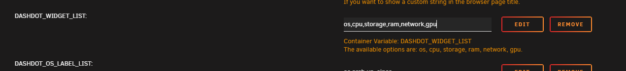

Has anyone been able to get 'gpu' working on this?  I'm curious to hear how you accomplished it.  I've done everything I've known to do with a passing a GPU through a container in Unraid (--runtime=nvidia; NVIDIA_VISIBLE_DEVICES; NVIDIA_DRIVER_CAPABILITIES) but can't get it to work.
I can't make web ui working :(
  • 1 year later...
The problem for me was `DASHDOT_GPU_LABEL_LIST = brand,model,memory` without spaces like in the example. The GPU worked after that. Also make sure you're using the nvidia tag `mauricenino/dashdot:nvidia`
Its only show drive stats for the USB stick. Raid and Cache Drives show -1B for used space. Am I missing a setup set? No temp shown on any drive as well.
