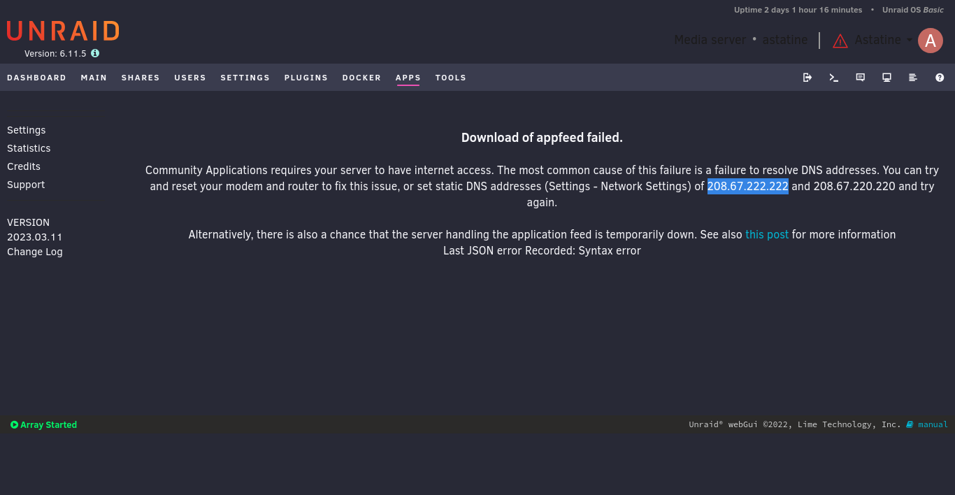

For the past few days, my unRAID server has started having severe network connection issues. I hadn't made any changes to the network settings. I went through multiple articles online about DNS issues with unRAID. I've tried use all of the following DNS addresses:
  • 1.1.1.1
  • 8.8.8.8
  • 8.8.4.4
  • <my gateway/router ip>
  • 208.67.222.222 & 208.67.220.220

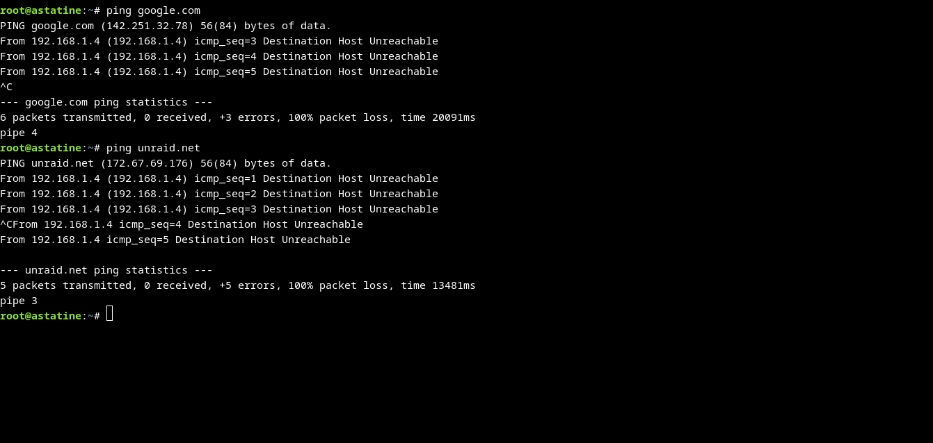

But every time I am done changing the DNS, the server works fine for a few minutes, i.e., is able to connect to the internet. However, after a few minutes, I looses connection. I am unable to load the CA tab, I tried pinging both unraid.net & google.com and they were unreachable

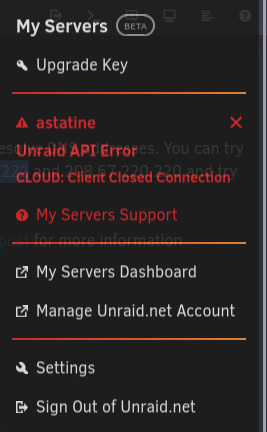

1409131002_Screenshot2023-03-12at21-01-51astatine_Apps.thumb.png.2e9fe6146da5928351f85e63a53afc6d.png
810021787_Screenshot2023-03-12at18-14-56root@astatinebash--login(astatine).png.9802a55ce02900d6ddf74a66d2880c63.png
973353286_Screenshot2023-03-12at20-59-37root@astatinebash--login(astatine).thumb.png.460d849179fa75f8ea127d6da3fea4b9.png
This has gotten very frustrating.

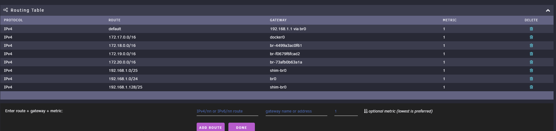

you do not have a dns issue, you have a routing problem. The gateway at 192.168.1.1 is unable to forward your packets.
Line gone? Wrong Gateway?

I'm not sure how it could be routing when I'm using a simple fritzbox
Or you have serious problems with wakeup after sleep mode of your server ("ntp:no peer for too long, server running free now")
Too much powersaving maybe.
I don't think it is a routing issue because rest of the devices in my home are working just fine. I made no changes to the router/modem. I have a separate machine running Home Assistant and it works great. I am able to control it remotely as expected. It's only this unRAID machine that has been facing connection issues. Besides, can you mention what specific setting in the router you want me check just so I can make sure it indeed is not a routing issue?

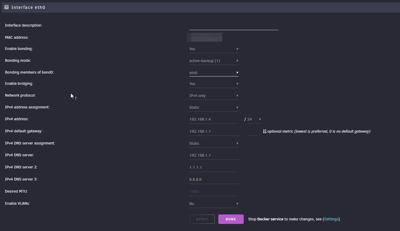

Also, here are the network settings from my unraid instance

try to delete network.cfg and setup network again,   but why do you enable bonding if you only has nic
I haven't touched the network setting. They are as is as they came with the install. I only changed the DNS trying to fix my issue. Bonding is enabled out of the box with 'active-backup' as default bonding mode.

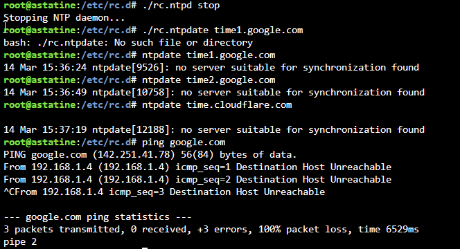

So, I deleted the network.cfg and rebooted, setup the network. Everything was working just fine for about 10 minutes and then unRAID server again lost connect to the internet. However, this time a new error message came in the logs
Mar 13 10:47:56 astatine  ntpd[1172]: kernel reports TIME_ERROR: 0x41: Clock Unsynchronized

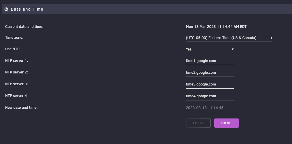

I then checked the time in Settings > Date and Time and the time looks okay to me. It's the correct timezone and datetime.
Is there a way to reset this?

So I end up with the basics: check your cables, switch and LAN Card. And, like somebody above already noted: get rid of that bonding stuff!
@MAM59 Okay, I got rid of bonding stuff. But the issue didn't go away. After changing network settings, everything works fine for about 10-15 minutes and then it's back to square one. When I ping anything, I get 'Destination Host Unreachable'. I've attached the new diagnostics to this post as bonding settings were changed.

@JorgeB@itimpi So, I gave up on the server last night and left it on its own. Turns out a couple hours after the network reset yesterday, the server behavior changed. Now the server is connecting on and off. And I am getting new errors in the log(s). I have attached the latest diagnostics to this post. Here's a snippet of the new error(s) that I am seeing.
