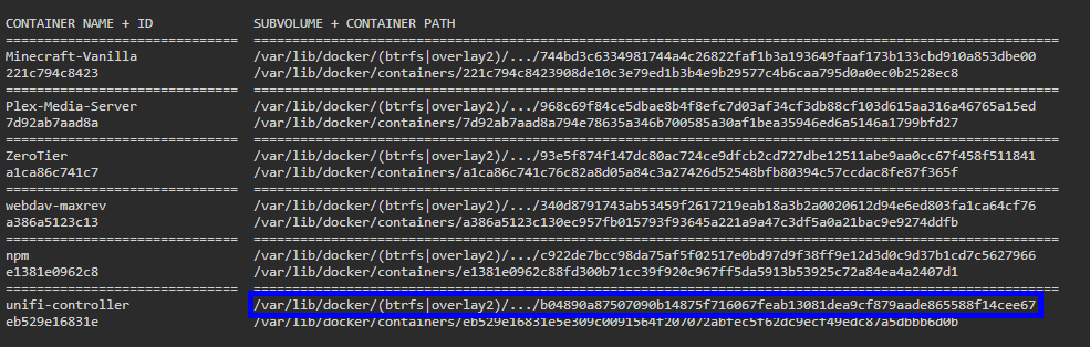

 Lets say there is one file updated frequently like this one
/var/lib/docker/overlay2/b04890a87507090b14875f716067feab13081dea9cf879aade865588f14cee67/merged/tmp/hsperfdata_abc/296
Problem: You don't know which container is writing to the path "b04890...". So you need this command to obtain this information:
csv="CONTAINER;PATHS\n"; for f in /var/lib/docker/image/*/layerdb/mounts/*/mount-id; do subid=$(cat $f); idlong=$(dirname $f | xargs basename); id="$(echo $idlong | cut -c 1-12)"; name=$(docker ps --format "{{.Names}}" -f "id=$id"); [[ -z $name ]] && continue; csv+="\n"$(printf '=%.0s' {1..20})";"$(printf '=%.0s' {1..100})"\n"; [[ -n $name ]] && csv+="$name;" csv+="/var/lib/docker/(btrfs|overlay2).../$subid\n"; csv+="$id;"; csv+="/var/lib/docker/containers/$idlong\n"; for vol in $(docker inspect -f '{{ range .Mounts }}{{ if eq .Type "volume" }}{{ .Destination }}{{ printf ";" }}{{ .Source }}{{ end }}{{ end }}' $id); do csv+="$vol\n"; done; done; echo ""; echo -e $csv | column -t -s';'; echo "";
Lets say it returns this and now you know which container caused this:
Now you could think about how to solve your problem. Maybe the container is writing logs inside the container volume? Or permanently writes to a /tmp dir? Then you could add this path to your container settings and link it to Unraid's "/tmp" (Which is already a RAM Disk - and those files will be lost on reboot of course):

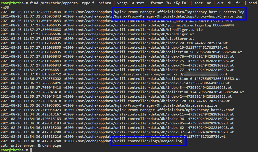

Another step could be to analyze most recent writes in the appdata directory:
find /mnt/cache/appdata -type f -print0 | xargs -0 stat --format '%Y :%y %n' | sort -nr | cut -d: -f2- | head -n30
By that I found out that Nginx Proxy Manager wrote permanently logs:
And again I created a new path to Unraid's /tmp path (which is already a RAM-Disk):
That's how I reduced my writes by 90%.

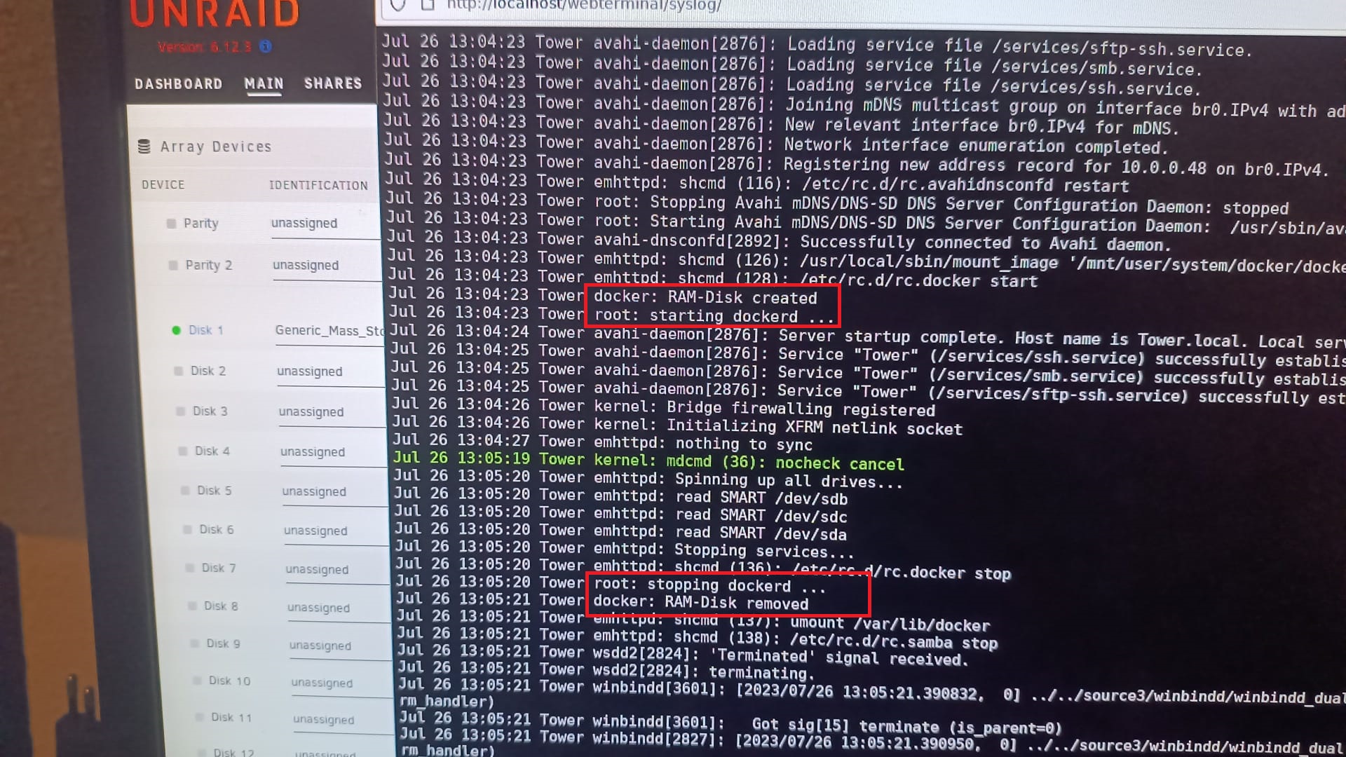

Either im going completely coo-coo or in 12.3 something changed. I tested it with 12.2 a while back and it just worked but now ive updated to 12.3 and the /etc/rc.d/rc.docker file wont get edited at all. /usr/local/emhttp/plugins/dynamix/scripts/monitor is still recieving the change.
Update:
I can gladly announce, i am not going crazy. The comments in the file are gone.
sed -i '/^  echo "starting \$BASE ..."$/i \
can be worked around with
sed -i '/^  echo "starting \$DOCKERD ..."$/i \
but stopping docker has changed the
sed -i '/^  # tear down the bridge$/i \
into a 15 count loop that has the comment. I would at least expect that one to be inserted there but for some reason it didnt. So there might be more funky magic going on.
Update #2
Got it to work
# RAM-Disk for Docker json/log files v1.4 for 6.12.3
# create RAM-Disk on starting the docker service
  # move json/logs to ram disk\
  rsync -aH --delete /var/lib/docker/containers/ ${DOCKER_APP_CONFIG_PATH%/}/containers_backup\
  mountpoint -q /var/lib/docker/containers || mount -t tmpfs tmpfs /var/lib/docker/containers || logger -t docker Error: RAM-Disk could not be mounted!\
  rsync -aH --delete ${DOCKER_APP_CONFIG_PATH%/}/containers_backup/ /var/lib/docker/containers\
  logger -t docker RAM-Disk created' /etc/rc.d/rc.docker
# remove RAM-Disk on stopping the docker service
sed -i '/^        # tear down the bridge/i \
  # backup json/logs and remove RAM-Disk\
  umount /var/lib/docker/containers || logger -t docker Error: RAM-Disk could not be unmounted!\
  if [[ -d /var/lib/docker_bind ]]; then umount /var/lib/docker_bind || logger -t docker Error: RAM-Disk bind unmount failed while docker stops!; fi\
  logger -t docker RAM-Disk removed' /etc/rc.d/rc.docker

Is the /etc/rc.d/rc.docker file changed at all?
You gotta excuse me for my awful picture quality.
