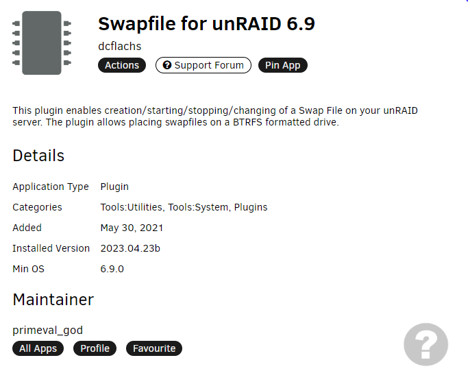

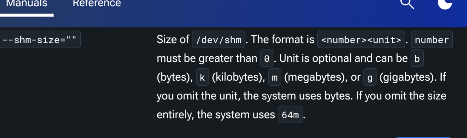

?Is this now a page file of sorts....
This is what docker shm and the swap plugin can do?
Docker extra parameter add --shm-size="3G"
My script moves files which are NOT in /dev/shm and/or in the swap partition, into a ram disk. All of them are doing completely different things.
You COULD in addition use shm-size for your containers, but I think 99% of the containers won't benefit, as I never faced a container, which permanently writes to /dev/shm. Does anyone know some?
And you should NOT think about a swap partition if you have enough ram. The main reason for a swap partition is to avoid going out of ram. You won't gain any benefits from a swap disk, instead it produces more wear on your SSD (which is the opposite of the target if this thread).
