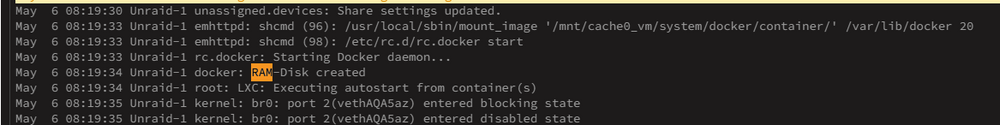

But the RAM-Disk seems to be created without errors when starting Docker and I also get the Success message every 30 minutes
Jul 28 20:06:07 smartserver root: starting dockerd ...
Jul 28 20:06:07 smartserver docker: RAM-Disk created
root@smartserver:~# mount | grep tmpfs | grep docker
tmpfs on /var/lib/docker/containers type tmpfs (rw,relatime,inode64)
tmpfs on /mnt/cache/system/docker/docker/containers type tmpfs (rw,relatime,inode64)

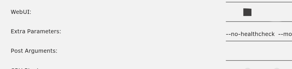

It’s the same version. I did run without the compatibility check, and everything is working from what I see. The RAM disk shows is created in the logs. But I am gonna update it and run again.
I remember we used to change the settings for each docker and added additional parameters. It sounds like is no longer the case with the updated script?
