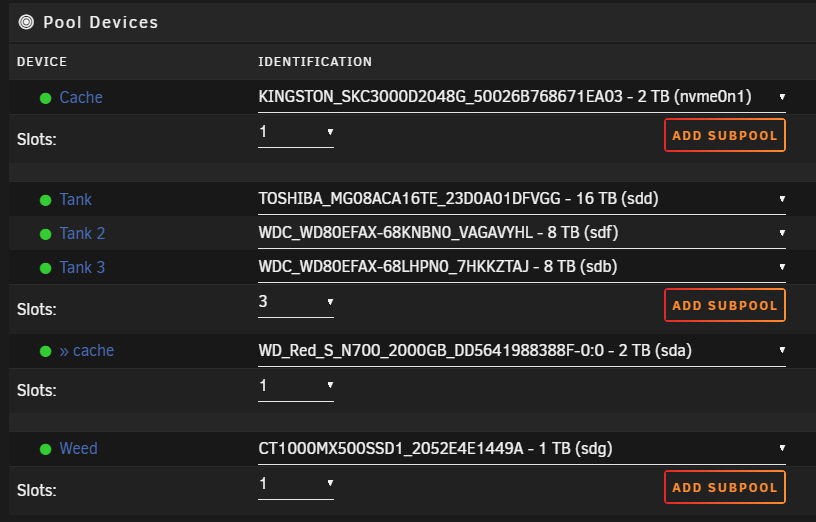

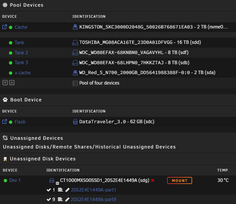

# zpool status pool: cache state: ONLINE scan: scrub repaired 0B in 00:25:09 with 0 errors on Wed Jan 1 08:25:10 2025 config: NAME STATE READ WRITE CKSUM cache ONLINE 0 0 0 nvme0n1 ONLINE 0 0 0 errors: No known data errors pool: fox state: ONLINE config: NAME STATE READ WRITE CKSUM fox ONLINE 0 0 0 sda ONLINE 0 0 0 errors: No known data errors pool: tank state: ONLINE scan: scrub repaired 0B in 08:42:34 with 0 errors on Wed Jan 1 17:12:47 2025 config: NAME STATE READ WRITE CKSUM tank ONLINE 0 0 0 raidz1-0 ONLINE 0 0 0 sdd1 ONLINE 0 0 0 sdf1 ONLINE 0 0 0 sdb1 ONLINE 0 0 0 cache sdg ONLINE 0 0 0 errors: No known data errors In now configured my pools the way I want them. The thing is, that now the system and the webui are out of sync. - sda should be pool "Fox" - sdg should now be "Tank >> cache" - Tank will no longer be imported on arry startup Is there a way to init the webinterface data?

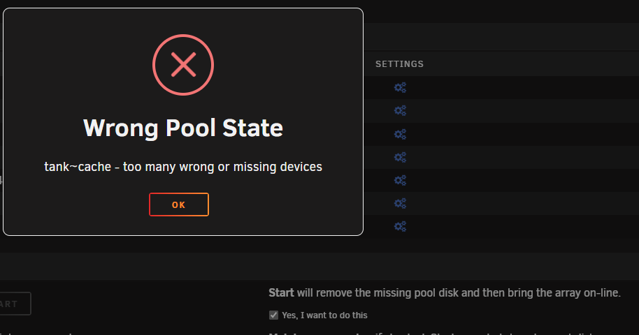

When I try to remove the cache of Tank I get an error. Removing within the shell works fine but results in async webui informations. What should I do to perform the removal?

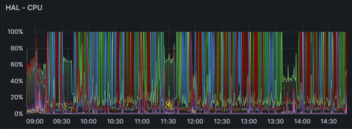

1 Core stuck at 100%, idle

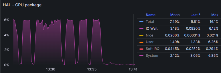

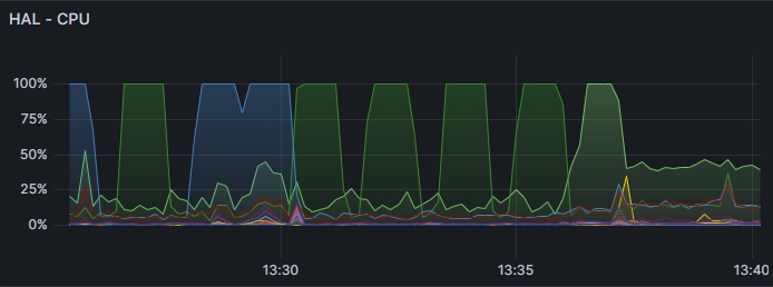

after some hours investigation I found the reason for my issue: I'm using an USB3.2 enclosure IB-1817M-C31 of Icy-Box. After pulling the plug the waits and the CPU utilization were gone. I then decided to do a firmware update of the enclosure. This solved the issue for now.

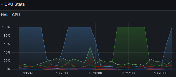

Me too. In Grafana I'm investigation exactly the same. But tools like iotop, htop, top or btop seem not to realize that. If the CPU is almost idle, it looks like this. In the moment the CPU gets some preasure this behavior vanishes. In case of CPU is again on low preasure the behavior comes back. Interestingly the behavior correlates with IO Waits It does not matter if Docker Service (with all the container) and VM Manager is running or not. It is always the exact same behavior. This is a six hour perspective: My setup: Unraid system: Unraid server Plus, version 6.12.5 Motherboard: Intel Corporation NUC12WSBi7, Version: M46422-303 Processor: 12th Gen Intel® Core™ i7-1260P @ 3762 MHz All drives are sleeping except my KINGSTON_SKC3000D2048G_50026B768671EA03 (nvme0n1) with ZFS Pool Eigther it is an kernel issue or it is some kind of ghosty "organizer" process. Tried intel_pstate=passive in syslinux.cfg -> did not have any effect on this behavior

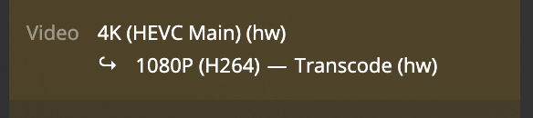

***GUIDE*** Plex Hardware Acceleration using Intel Quick Sync
Hi folks, just want to share this one: I had big issues to get HW acceleration working. This is my setup: ASUS PN41 with Intel Celeron N5100 (very nice mini PC) Docker setup and permissions of /dev/dri were correct but never the less HWA was not working. I spent hours investigating this. Finally I got it. Do following, if you have a similar setup: rmmod i915 echo "options i915 enable_fbc=1 enable_guc=3" > /etc/modprobe.d/i915.conf modprobe i915 Then check Plex again Works now like a charm for me. For persistence add the "echo" line into /boot/config/go Good luck! ------- I forgot a mutual thing: Inside the docker container I also installed "vainfo" to check if the GPU and driver is working as expected. This seams to install some drives which help to enable HW acceleration. apt install vainfo (within the docker) To make this persistent check this URL for the linuxserver.io container: https://docs.linuxserver.io/general/container-customization This is my script I start on each container start: #!/bin/bash echo ##### Install vainfo packages dpkg -l vainfo > /dev/null 2>&1 || ( apt update && apt install -y vainfo && apt clean )
