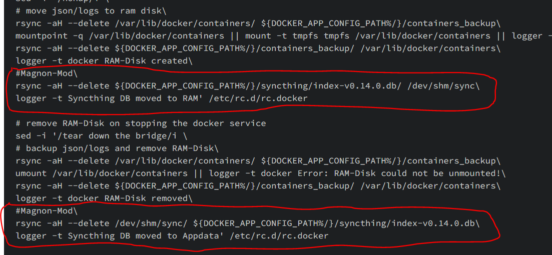

Thank you for create script work and being source for really useful RAM-Disk for Docker logs.
Would it be possible to extend(or separate script/plugin) this ram-disk support for the Plex dockers database folder.
For me the remaining unneccesary writes to appdata are from plex mediaserver and they happen every 30 seconds constantly.
It happens to specific file but ramdisking that whole folder would help. So far i havent figured out the root cause of those constant "modify" actions. all regular healtchecks and scheduled actions in plex are off.
Thu Jan 23 19:14:48 2025 MODIFY /mnt/user/appdata/plex/Library/Application Support/Plex Media Server/Plug-in Support/Databases/ com.plexapp.plugins.library.db-wal
Thu Jan 23 19:16:18 2025 MODIFY /mnt/user/appdata/plex/Library/Application Support/Plex Media Server/Plug-in Support/Databases/ com.plexapp.plugins.library.db-wal
Did you already disable healthcheck? Maybe this stops those writes.
You have to add --no-healthcheck to extra parameters:
I have it with some extra stuff.
--no-healthcheck --log-driver syslog --log-opt syslog-address=udp://127.0.0.1:541
Unfortunately no help. Thats why RAM-Disk seems to be easiest to reduce those writes.
Edited by VeixES
