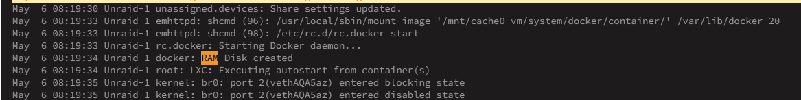

So are install instructions as follows
-set up script in user scripts
-run in background
-stop docker
-start docker
-check logs for Ram Disk Created

For future people like me, who forgot about this completely and come back to this topic to read up on what's happened:
This script is now "abandoned" and have instead been made into a plugin (Thank you Mainfrezzer!)
Go to APPS, search for "ram-disk".
Install "RAM-Disk for Docker logs" by Mainfrezzer.
If you have the script from this thread in your go file. Go in there and delete it.
If you have the script in your UserScripts. Go in there and either disable the schedule or delete the script.
Reboot your server and go to SETTINGS / RAM-DISK for Docker logs. Here you can see if it is running as it should and you can edit the backup schedule.
