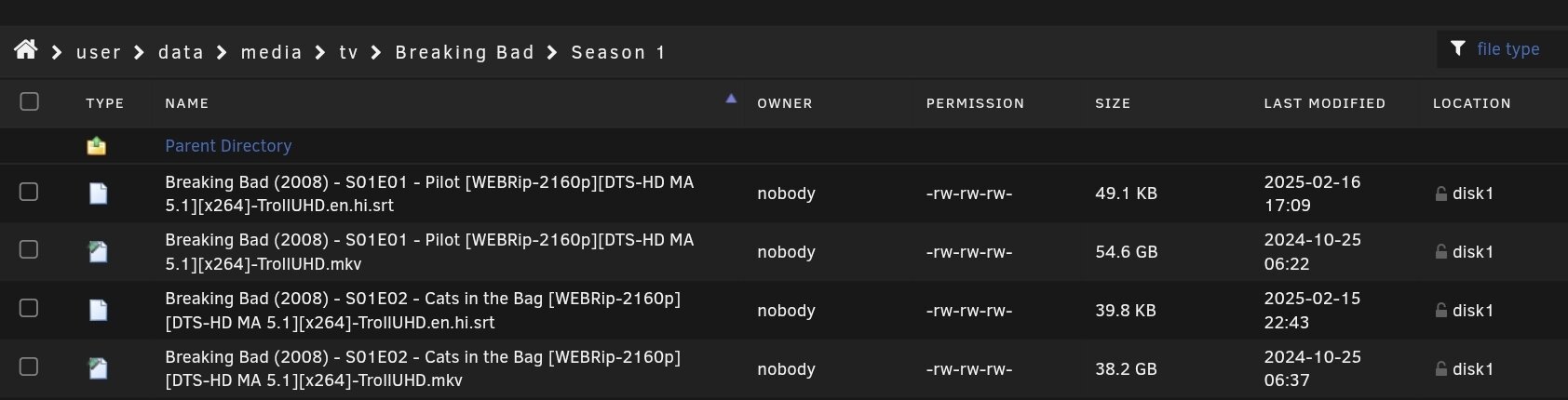

  7. @alturismo updated to the latest version and tested without any other changes, it worked perfectly this time. Thanks again for all your work on this plugin, as someone who (unfortunately for now) has their server in the same room as the tv, this plugin makes the viewing experience so much better.

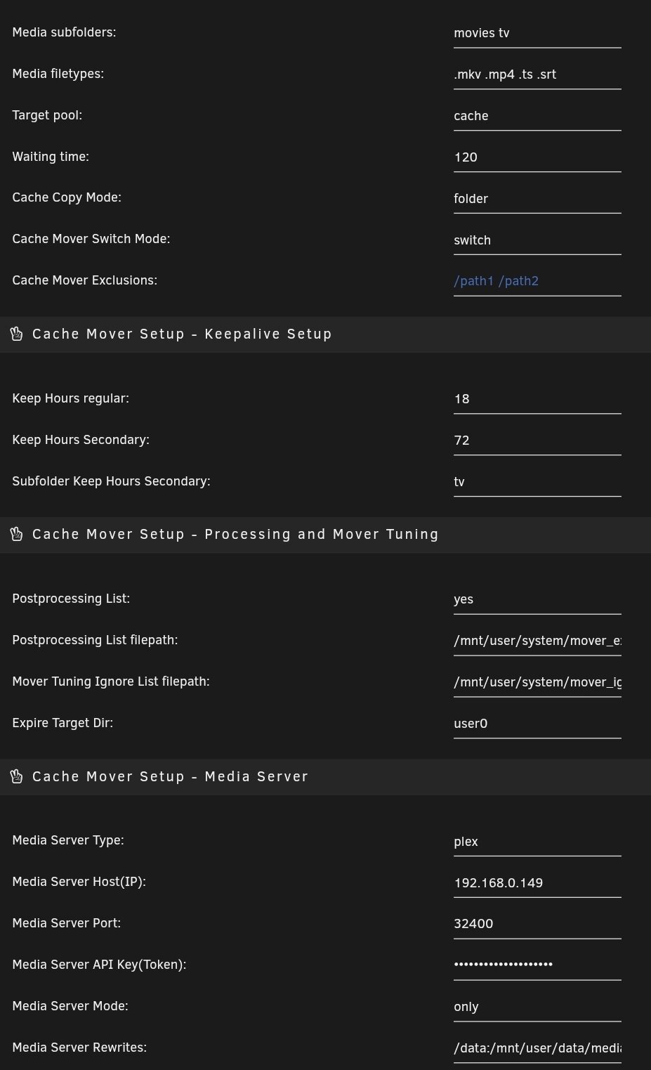

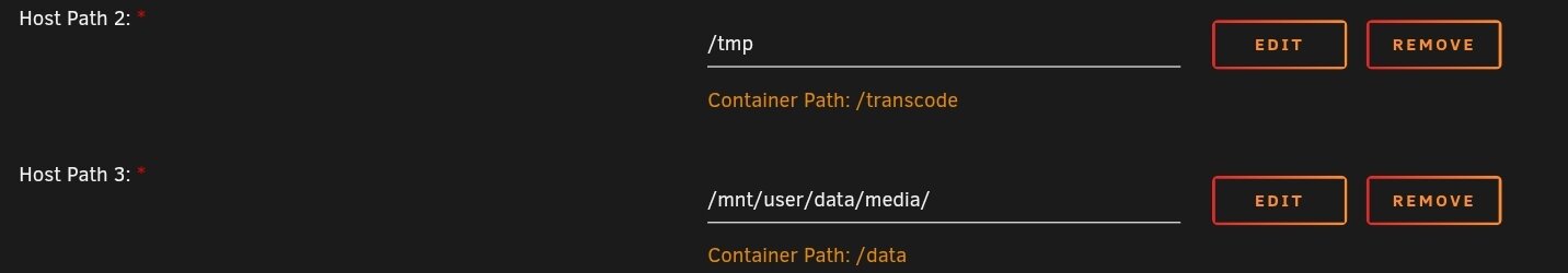

  8. I'm using xfs. I'll update tomorrow and test, apologies I missed that update! Regarding the special characters, I saw that during the initial setup however with like 95% of my files that typically follow a similar pattern it works perfectly. Even now I could open another file that follows the same or at least a very similar naming structure and it would probably work perfectly, I'll try get logs with it working/not working tomorrow. Would it be worthwhile to change the file name to remove the brackets and any other characters to see if it works?
  9. I updated my settings to add the plex media server info, previously didn't and i didn't have many issues without it. Since adding them if I try multi nothing happens within the log, only mode it updates the time without moving anything and regular mode gives the previous file changed issue Feb 16 21:46:02 NAS-Gul root: cache-mover: reg: file changed during wait, exiting here Feb 16 21:50:02 NAS-Gul root: cache-mover: reg: file changed during wait, exiting here Feb 16 21:52:04 NAS-Gul root: cache-mover: msm: update access time pool only dir: /mnt/user/data/media/tv/Breaking Bad/Season 1 I've changed my cron to every 2 minutes to try figure this out, normally it's 10 and 120 seconds for the check is the setting I've always used
  10. Cache mover works great for me 95% of the time, absolutely love it Alturismo. I've noticed lately that the below is coming up more and more often in the logs and not moving the media file that's playing. Haven't changed any settings and I could play something else and it could work perfectly, any suggestions? Feb 15 21:02:02 NAS-Gul root: cache-mover: reg: file changed during wait, exiting here Feb 15 21:12:02 NAS-Gul root: cache-mover: reg: file changed during wait, exiting here Feb 15 21:22:02 NAS-Gul root: cache-mover: reg: file changed during wait, exiting here Feb 15 21:32:02 NAS-Gul root: cache-mover: reg: file changed during wait, exiting here Feb 15 21:42:02 NAS-Gul root: cache-mover: reg: file changed during wait, exiting here Feb 15 21:52:02 NAS-Gul root: cache-mover: reg: file changed during wait, exiting here
