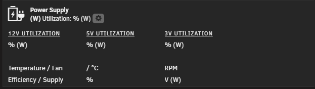

Please see screenshots below of the new design on the Unraid Dashboard,
