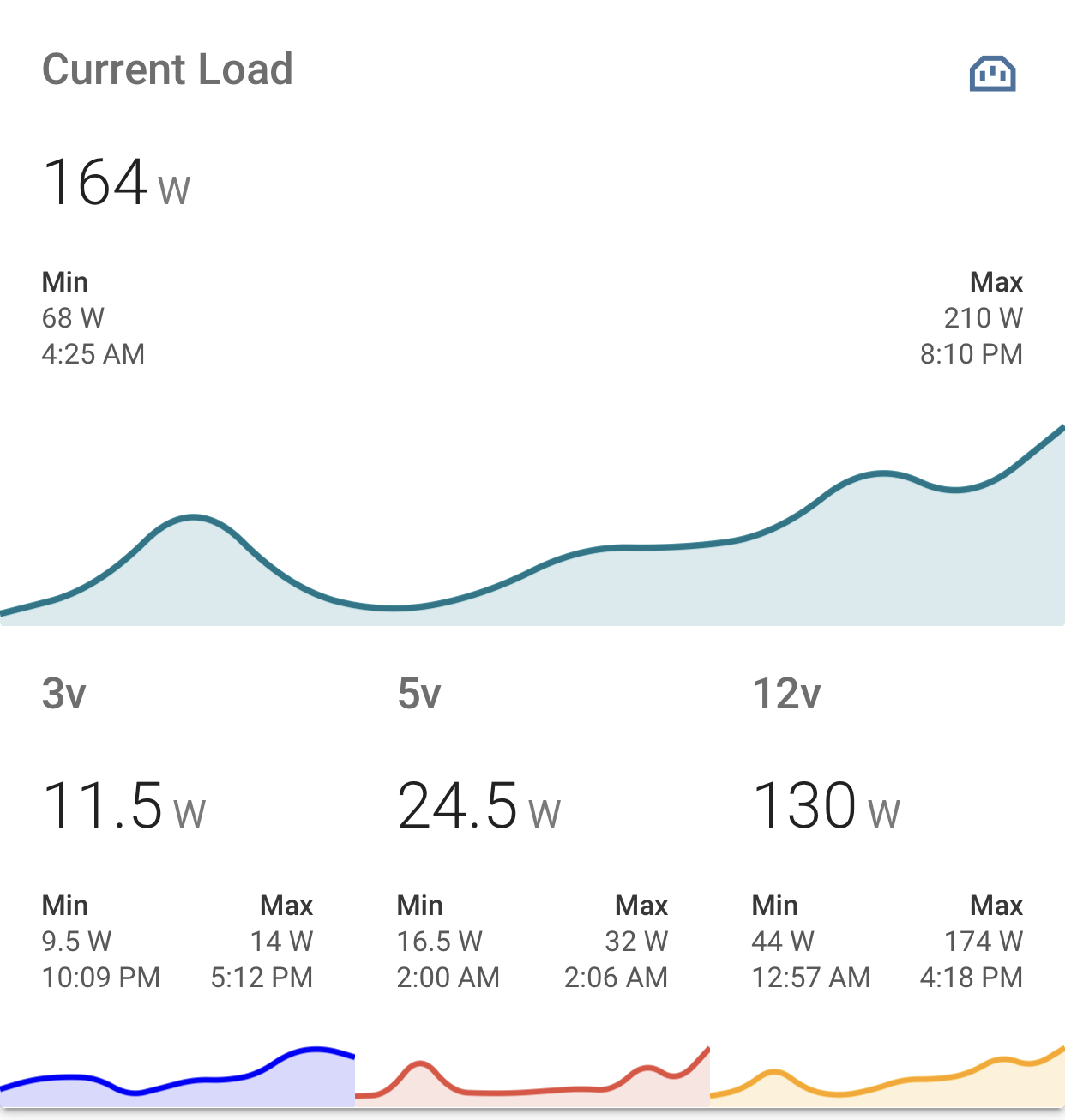

Hey @Fma965 I asked willnnotdan on discord how he tackled the new auth on 6.8 for Unraid-API if you ever think you’d like to give it a go. “Hey, I got it working with the new Auth but it was a pain! Essentially it makes a post request to /login and blocks the attempt to redirect (it'll redirect to main, find you don't have the cookie and then redirect you back to login) it then grabs the cookie from the headers and stores it so it can be used in future requests. Happy for him to message me directly if I can be of assistance :)” https://discord.gg/Qa3Bjr9
Corsair RMi, HXi, AXi PSU Statistics - CyanLabs's fork
cards: - type: custom:mini-graph-card entities: - sensor.psu_watts # - sensor.psu_3v_watts # - sensor.psu_5v_watts # - sensor.psu_12v_watts icon: mdi:power-socket line_color: '#00778a' line_width: 3 font_size: 75 show: extrema: true - type: horizontal-stack cards: - type: custom:mini-graph-card entities: - sensor.psu_3v_watts name: 3v line_color: blue line_width: 8 font_size: 75 show: extrema: true icon: false - type: custom:mini-graph-card entities: - sensor.psu_5v_watts name: 5v line_color: '#e74c3c' line_width: 8 font_size: 75 show: extrema: true icon: false - type: custom:mini-graph-card entities: - sensor.psu_12v_watts name: 12v line_color: orange line_width: 8 font_size: 75 show: extrema: true icon: false Requires mini graph card from HACS
