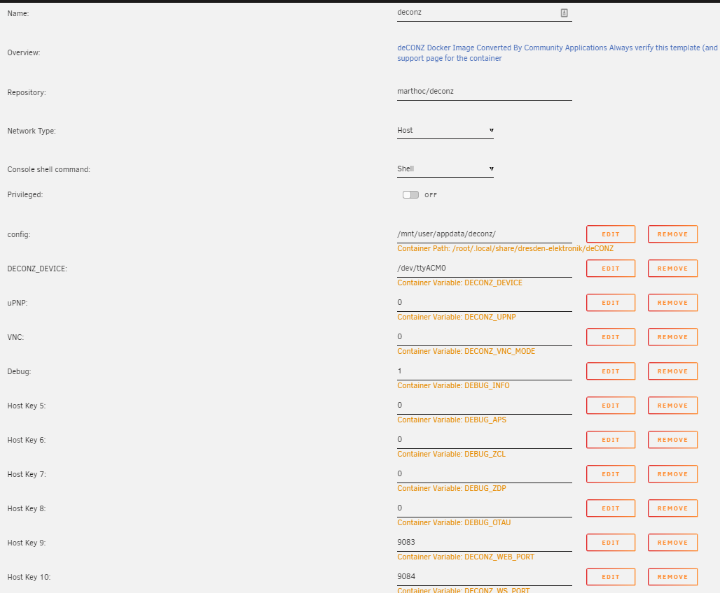

Hi I want to test this container but in my template there are not "usb conbee" and "usb device name".
Are those variables?
@Jokerigno Those two are not in the current template but are as follows
1.  Device with a value of   "/dev/ttyACM0"
2. Variable with a key of "DECONZ_DEVICE" and value of  "/dev/ttyACM0"
Hope that helps! :)

@SpaceInvaderOne, I saw your docker and tried it - it worked well until I tried to get it linked with HA, but then it wasn't able to get an API key.  I ended up using the one out of the docker hub with this post to fix my integration issues with the home assistant core docker.  I needed to set loads of environment variables and also the "dialout" usermod setting to get it working properly.  I don't know if it's worth you adding those into your docker image too?
I used the command ls -l /dev/serial/by-id to find out what my conbee2 was using.
lrwxrwxrwx 1 root root 13 May 30 02:40 usb-dresden_elektronik_ingenieurtechnik_GmbH_ConBee_II_DE2195326-if00 -> ../../ttyACM0
This is what I ended up with in my docker settings (obviously I had to remap the port from the usual port 80 to some other random port).
Hope that helps! :)
It worked!
Just like @tomwhi The use of variables are needed like VNC stuff
Link to https://github.com/marthoc/docker-deconz for variables
DECONZ_VNC_MODE=1	Set this option to enable VNC access to the container to view the deCONZ ZigBee mesh
DECONZ_VNC_PORT=5900	Default port for VNC mode is 5900; this option can be used to change this port
DECONZ_VNC_PASSWORD=changeme	Default password for VNC mode is 'changeme'; this option can (should) be used to change the default password
DECONZ_UPNP=1	Set this option to 0 to disable uPNP, see: https://github.com/dresden-elektronik/deconz-rest-plugin/issues/274
The UPNP maybe necessary for gwid to work also But so far so good!
hope it helps
