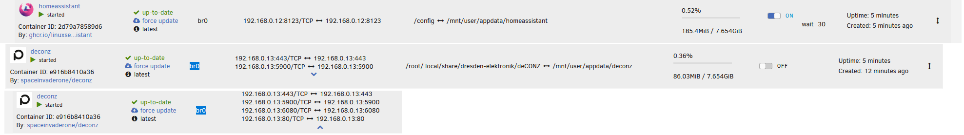

OH MY GOSH - I've just worked out why my Home Assistant couldn't talk to my Phoscon/Deconz app....   They weren't on the same docker network... DOH!!
My HA was on "host" because there was too many ports to map across, and my Phoscon was on br0 (also as shown in SIO's instructions but made the most sense because it needs it's own IP for things to find it on tcp/80 and tcp/443.
I found out by going into the console of the HA container and trying to ping my Phoscon IP - it failed!  So the "Api key couldn't not be whatever" is utter bullsh!t from an error message.
I also realised it couldn't talk to Pi-hole (which I was less worried about, but equally as annoyed with not working) - and for anyone else who lives and breaths the SIO videos - it's also on br0!!
So once my HA was moved onto the br0 network everything worked - well - not everything, now it can't talk to the host, so I can't get Sonnar or Raddar data into my HA setup but that really is the lowest of the low priorities and now I've worked this out I'll try and work out how to get it talking to both br0 and host networks.

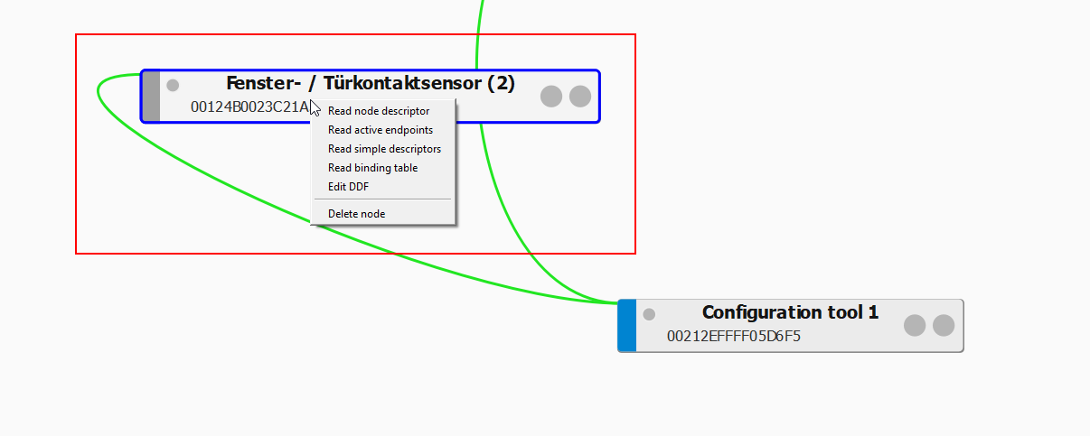

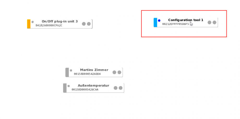

Hey there, I can't right click on the nodes via VNC viewer in this instance of deconz. Does anybody got a clue how this could work?
Here a screenshot how it is in the docker and how it is in the normal deconz installation on my PC. I need the right click menu to add some sensors.
I need the possibility to right click nodes and get the options shown there.
Thanks in advance!

1 hour ago, rikki said:
am getting the same any one have any advice
No issues like that on my setup.
Docker images:
Homeassistant (linuxservers image) br0 with fixed IP
deconz (SpaceInvaderOne image) br0 with fixed IP
Tried this solution?
They are both on the same subnet but pinging from home assistant to phoscon doesn't work.... any tips?
now i can ping from home assistant to phoscon have set them both to br0 see attach photos can someone please help been at this for well over a week and getting nowere 1616184043_homeassidenthelp.thumb.png.11dc9670e7f010f378caaa1ca52850bb.png
Edited by rikki
