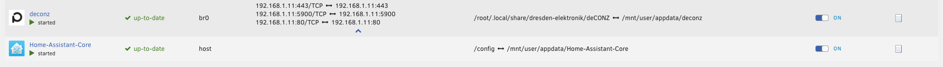

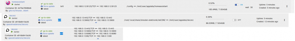

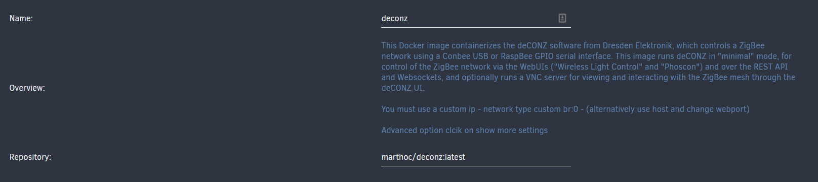

One year later... here I am. I tried all the methods mentioned in the previous answers but I still have problems with the integration of deCONZ.
I still get the "Couldn't get an API key" error.
The problem is that if I set the network type to host in the deCONZ template, I can't access the webUI. Vice versa, if I set the network type to br0 and assign an IP in the Home Assistant Core template, I can't access the webUI. If I leave the different network type configurations, both webUI work.
Can someone please help me? I really can't find a solution...
Here is my actual configuration:
2094293217_Schermata2020-12-02alle19_09_49.thumb.png.83d9210237fd9dbe308e8950d1e5785c.png

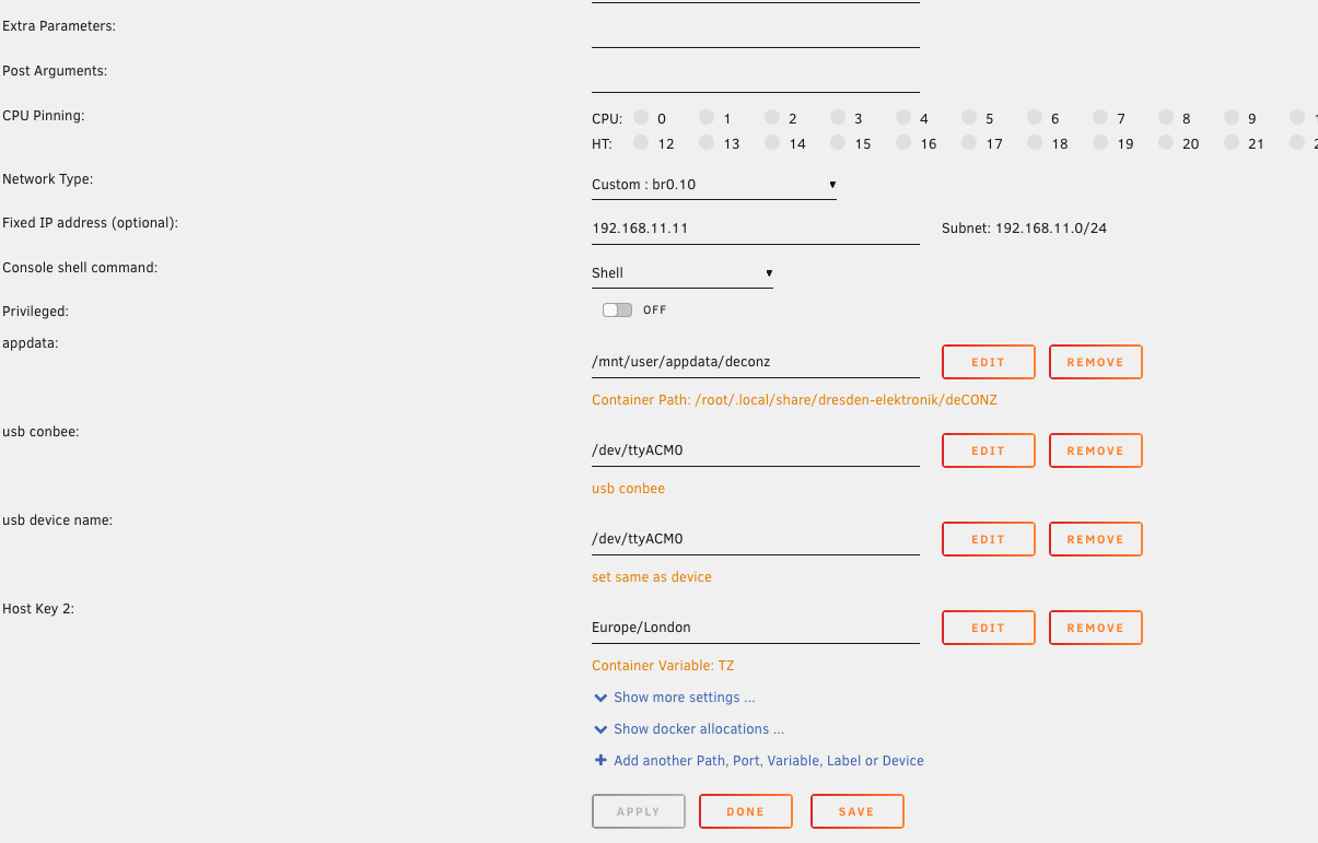

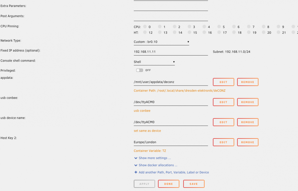

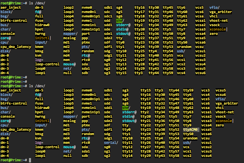

1.  Without conbee usb stick plugged into the server run the following command in a terminal window
ls /dev/
2.  Plug your conbee usb stick into the unraid server. Then run the above again. You will now see an extra device here. This is your  conbee zigbee stick.
Most likely ttyACM0    (unless you have maybe a zwave stick plugged in aswell then it might not be)
3. Now add the name of the stick to the template. (default is already ttyACM0)
    Add it to both usb conbee:  and usb device name:
1964835855_ScreenShot2020-05-27at17_42_04.thumb.png.6a82687fd359f242d29fc058da56f6ad.png
4. I think it best to set a static ip for the container. You can then access the container from  http://xxx.xxx.xxx.xxx   (the ip you set)
5. Now you can add your zigbee devices in the webui and connect deconz to home assistant for it to be able to access you zigbee devices.

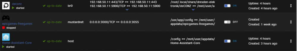

Actually I just got it, found the solution in a github issue. Move the dongle to a usb2 port or use a usb extension cable. Apparently there's an issue with using it on USB3.
