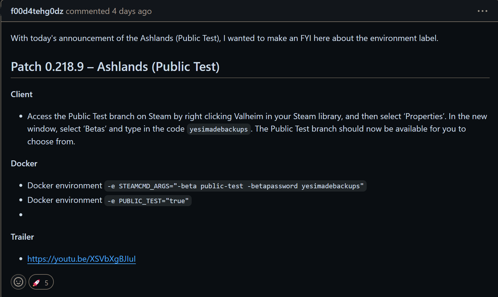

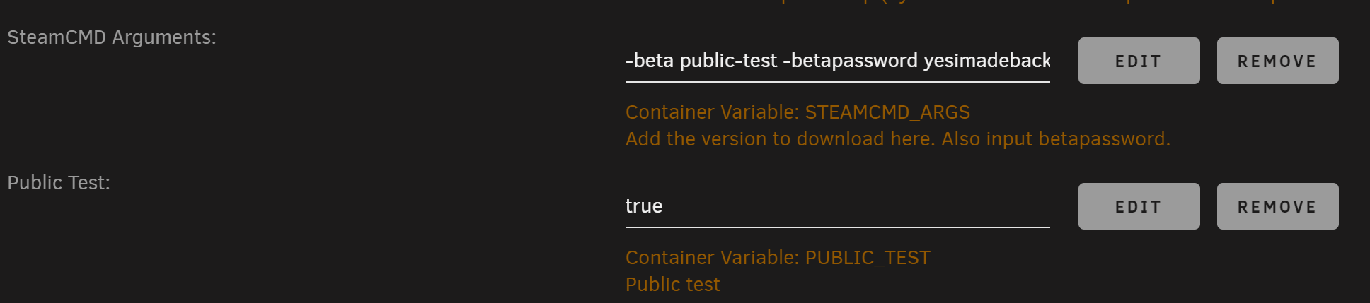

  2. First of all, thank you for the awesome docker containers! How would I best add these variables, so that I can install the public test of Ashlands? I tried adding the variables like in the attached image, but no luck. Edit: Solution: put "-beta public-test -betapassword yesimadebackups" (without quotes) in the GAME_ID field after the numbers. Also added the environment variable PUBLIC_TEST=true, but don't know if that is necessary. @ich777

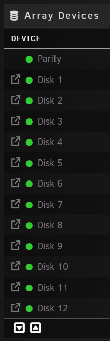

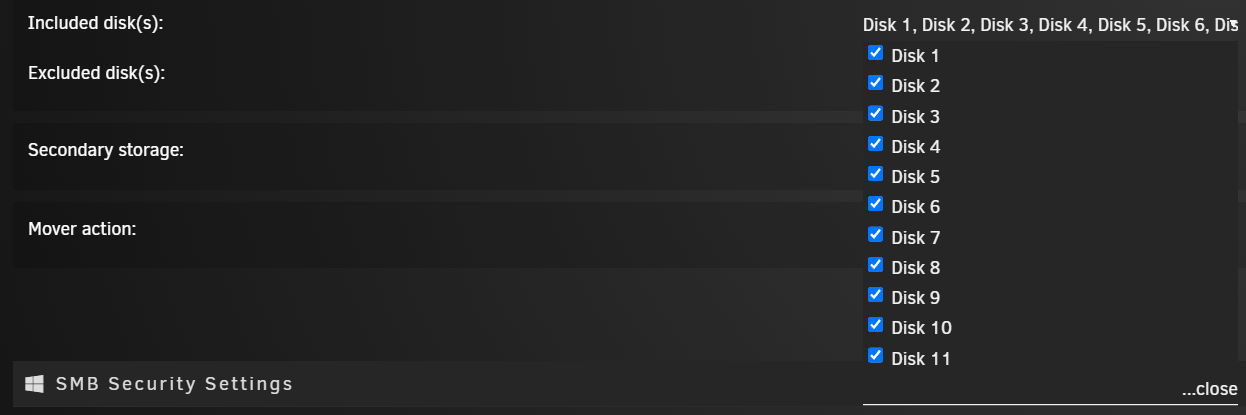

  4. For some reason the newest disk I installed doesn't seem to have been included in the array (Disk 12). It shows up as a separate disk share, but it's not possible to include it in any of my other shares. Would I need to do a new config to get it fixed?
