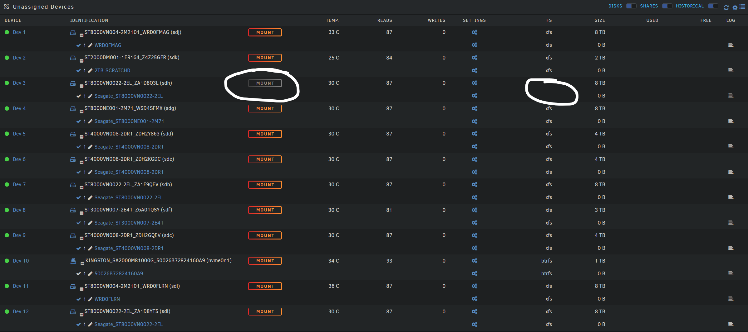

Did some homework on the forums and found the relevant guide. 😊 I haven't tried to mount any disks in read-only mode with the Unassigned Devices Plugin yet, but can I assume that the one in the image is the parity drive? Also: Does the order matter when assigning the drives with files on them? https://wiki.unraid.net/Manual/Troubleshooting#Lost_boot_drive_and_do_not_know_which_are_the_parity_drives

Hm, everything seems to work with the newly made flash drive. Apart from the error about PCI device spamming the logs that is. I think it's the onboard SATA-controller? Was there before installing the Areca card too. Installed the Areca controller card and the Dynamix SCSI plugin. All the drives show up and SMART-status shows as "passed" on all of them in Unraid GUI. Looks ok in the Areca UI as well. Assuming that the problem somehow happened when updating unraid on the other flashdrive. However.. how do I go about restoring the array now? I do have access to the old unraid flashdrive and its files. I don't have a picture or anything showing the assignments of each harddrive, unfortunately. Guess I also need to get a hold of Limetech to register this flashdrive on the Pro licence instead. Attached: Diagnostics with all hardware connected running 6.10.3 w/SCSI plugin unraid-diagnostics-20220625-2325.zip
