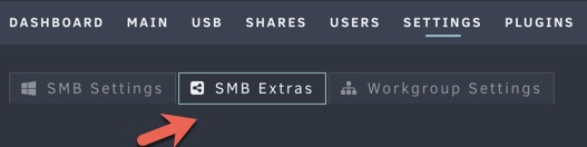

  7. Yes indeed . Your ghost share is [Backup] Between brackets you define the name you want the share to be visible by in windows. So you could reuse that and just change the "path" variable underneath to the actual mountpoint of your zfs (eg /mnt/disks/zfs) The only thing extra i have (which you may or may not need) is write list = yourusername valid users = yourusername With yourusername to be replaced with your unraid share user you want it to have access to. Last thing you need to do is open up the permissions of the zfs mountpoint on unraid. chmod 777 /mnt/disks/zfs chown nobody:users /mnt/disks/zfs Then restart samba (or the whole array )
  8. check my previous screenshot for the content you can add to smb extra to share your zfs. Maybe the ghost share you see is also in there So in your case you could add something like this: [My-AMAZING-ZFS-SHARE] path = /mnt/disks/zfs comment = browseable = yes # Public writeable = yes read list = write list = yourusername valid users = yourusername vfs objects =
