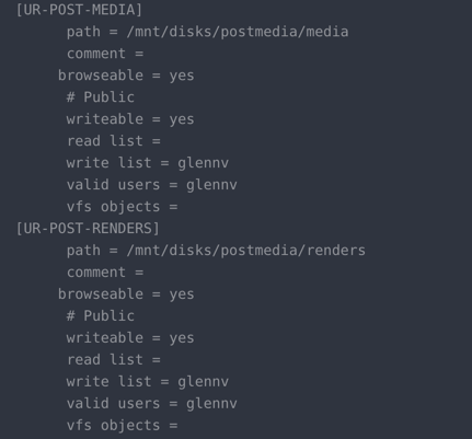

  8. check my previous screenshot for the content you can add to smb extra to share your zfs. Maybe the ghost share you see is also in there So in your case you could add something like this: [My-AMAZING-ZFS-SHARE] path = /mnt/disks/zfs comment = browseable = yes # Public writeable = yes read list = write list = yourusername valid users = yourusername vfs objects =

  20. Yeah i get why you though that would be smart , but unfortunately in this case that is not the way and pretty dangerous. Check the main zfs thread where it is explained how the share your zfs datasets over smb. Basicaly you have to use smb-extras. p.s. here an example how i shared 2 of my ZFS pools so they are available on my Mac and Windows clients
