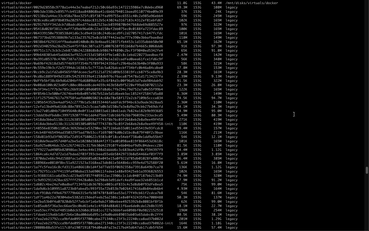

  17. Why havent you moved yet to hosting docker in a folder on zfs instead of hosting a docker image on top of zfs ? I moved to it last week and works fine and dont have to worrie about a docker.img file anymore. Its also more transparent as you can just browse the content of all images etc etc.
