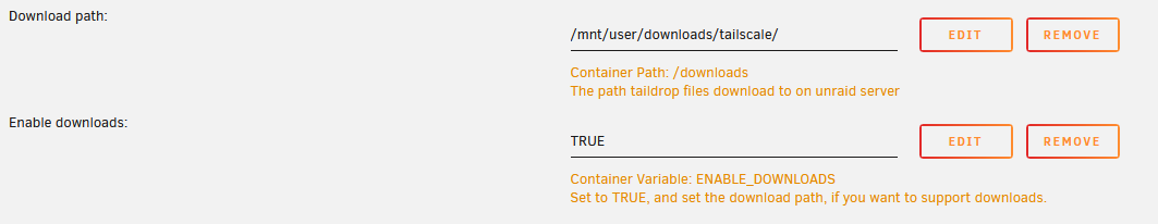

Downloads
Starting with release 1.24.2-downloads you can now support automatic downloads with taildrop.
If you have already installed tailscale you will need to add some extra paramaters manually as shown below.
