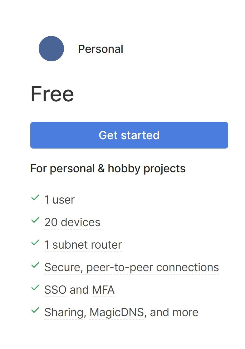

Has anyone ran into issues using more than "20 free" devices Tailscale limits too? Or is it unlimited since self-hosted? Would or is it possible to run a second instance of Tailscale on Unraid server?
See refernced pic attached.
Edited by blaine07
Thank you, all the thanks!
I don’t think you can use more than 20 devices without a separate account, and therefore network.
You aren’t self hosting either as all the clever stuff is in their cloud. This is just an end point. Running another instance on the same server would therefore be pointless.
I think they do have a free multi user as well, I’ve just noticed, bottom of this page.
https://tailscale.com/pricing/
I couldn't find that information but I saw you can share a device with your Tailscale network to another user. That user will only have access to that specific device you shared.
And that works with the personal free plan.
