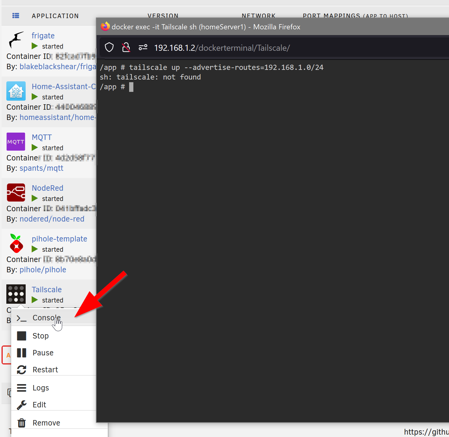

1 hour ago, maha said:
Trying to do the same as in the quoted posted.
But i'm getting this in the console?
what am i doing wrong?
I guess you need to start the command like this :
./tailscale up...
You need to add it to UP_FLAGS on your docker.
Here's a great video that shows how to do it:
