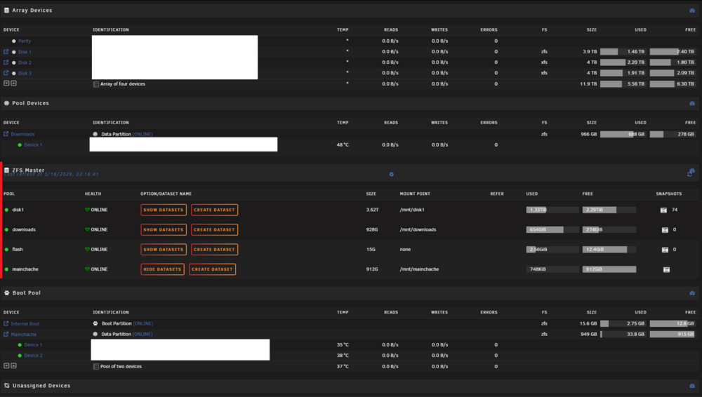

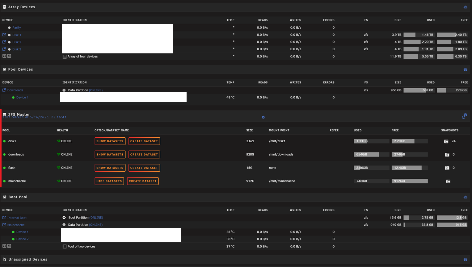

  3. Frick... With the release of 7.3 this is even more of an issue... ZFS master sits itself in between pool devices and boot pools. Since you can now use the internal boot pool as a data partition having something sit in between is VERRY annoying... Is there any way to force ZFS master down bellow the Boot pool?

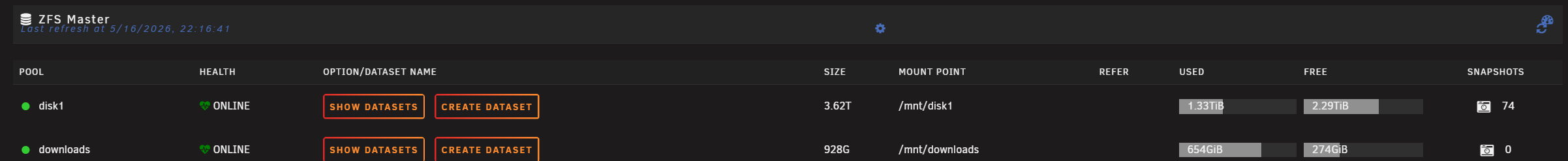

  4. For a while I've noticed that ZFS master information is kinda fcked up on the Main tab. Is it on my side somehow? Updates don't seem to resolve it...

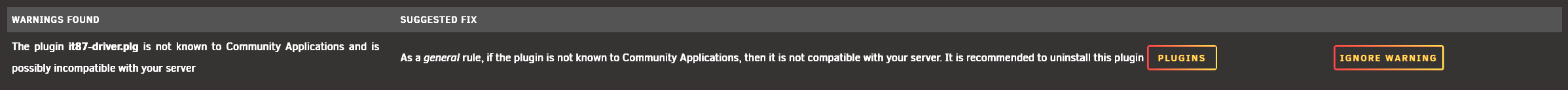

  5. Why is this plugin no longer in community apps? If I remember correctly there was 2 different IT87 plugins? Was one of them removed? The current one I have installed seems to not be linked with the one in community apps...
