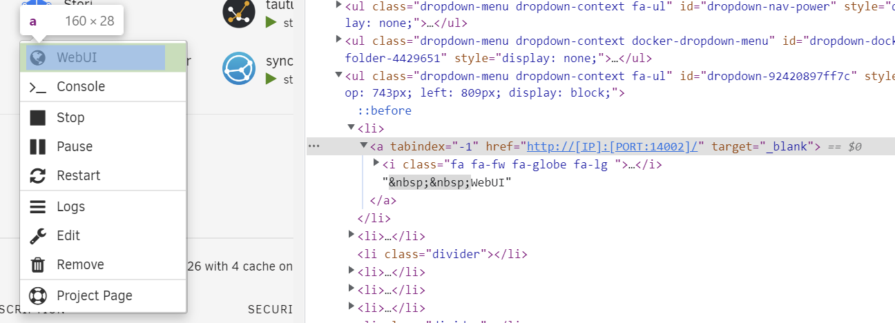

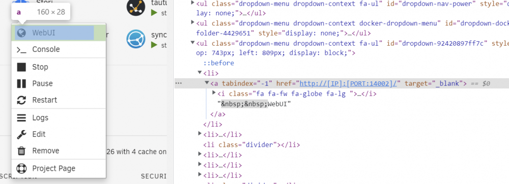

  3. I'm also observing this issue in Microsoft Edge. Does anyone see anything off with my XML?

  5. Hmm, if I inspect the actual link itself is it supposed to be literally the [IP]:[PORT] syntax?

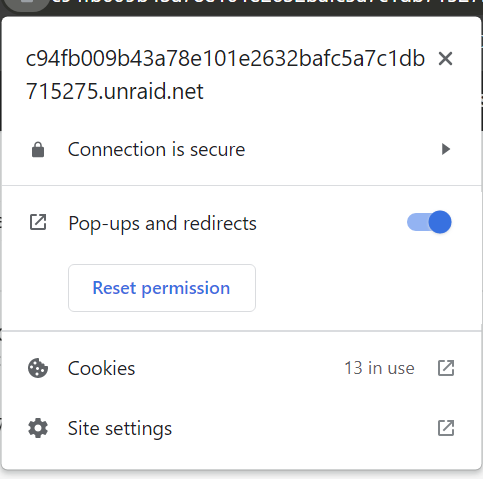

  6. Hmm, that's so strange. I tried earlier in Incognito and I just tried as well in --disable-extensions mode (which completely disables extensions) and it still does the about:blank#blocked thing. It doesn't seem to, and I manually enabled popups as well because I heard that might be an issue.
  7. Hi all, Recently I've started noticing that all of my Docker WebUI links open a new window to about:blank#blocked rather than their destination. I've checked and the links themselves seem fine (e.g. http://[IP]:[PORT:14002]/) and I've also tested with no extensions and no AV other than Windows Defender. I'm wondering if this is perhaps an upcoming security change in Chrome Dev? (I'm running Chrome Dev Version 105.0.5148.2 (Official Build) dev (64-bit)) Has anyone else observed this behavior?
