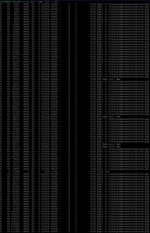

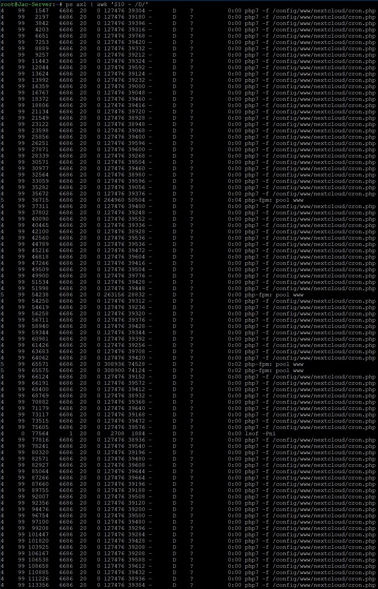

December 12, 20205 yr 16 hours ago, jcsnider said: If you ssh into your servers what is the output of the following command? Wow, so I started up my container to get the version info for my previous comment and a couple of minutes later it 504'd. I ran the command and got the following: root@Nighthawk:~# ps axl | awk '$10 ~ /D/' 4 99 6321 14590 20 0 127440 37480 - D ? 0:00 php7 -f /config/www/nextcloud/cron.php 4 99 7676 14590 20 0 127440 39696 - D ? 0:00 php7 -f /config/www/nextcloud/cron.php 5 99 19593 14579 20 0 260996 24004 - D ? 0:00 php-fpm: pool www 5 99 20230 14579 20 0 261060 23412 - D ? 0:00 php-fpm: pool www 4 99 25703 14590 20 0 127440 39340 - D ? 0:00 php7 -f /config/www/nextcloud/cron.php

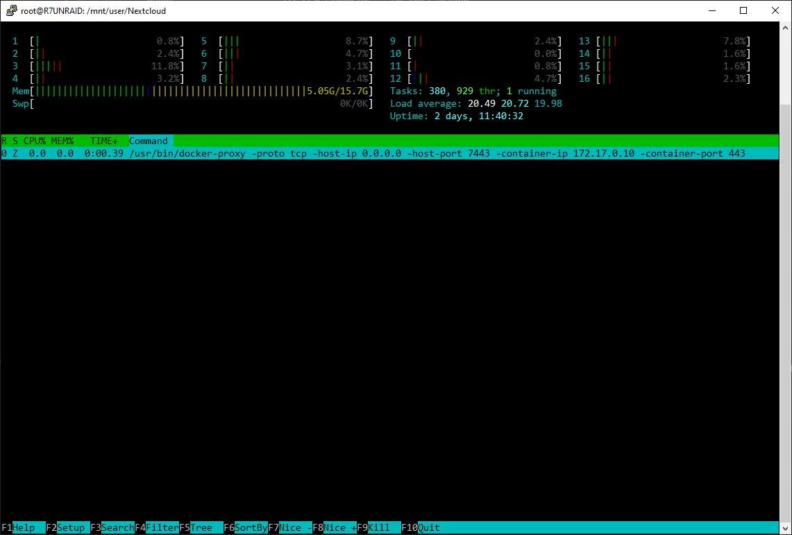

December 12, 20205 yr I'm guessing if you ssh into your unraid server and try to run lsof on any location (ie: lsof /mnt/user) that will also never finish executing (requiring a new terminal instance in order to issue further commands). If you try to fetch diagnostics it will never finish executing either, and if you try to collect those through the WebUI then eventually the WebUI will start giving 500 errors until it's restarted. I never assigned a /tmp docker path, but I modified the php config within NextCloud to use a subdirectory in the /data folder to store upload data as it's being recieved so effectively I am doing the same thing to avoid my docker file increasing in usage dramatically. I needed to get everything back up and running last night so I rebooted. I went into my NextCloud config and changed all my shared paths access properties to 'Read/Write - Shared' instead of just 'Read/Write'. My instance is working for now but I don't expect that it will last. I guess in each of our cases we have designated a temporary upload location that is on our arrays - I don't see how that'd be a problem but for debugging purposes maybe I will change it to an unassigned device and see how that works. Edit: Are either if you all using the filesystem_check_changes’ => 1, flag in your NextCloud config.php? Edited December 12, 20205 yr by jcsnider

December 13, 20205 yr 19 hours ago, jcsnider said: I'm guessing if you ssh into your unraid server and try to run lsof on any location (ie: lsof /mnt/user) that will also never finish executing (requiring a new terminal instance in order to issue further commands). By the way, I just wanted to confirm that this was true for me. After it locked up, I performed a shutdown and though it took an extra minute or two, it was actually able to safely shutdown. The other 2-3 times this has happened, I could not shutdown because the docker service couldn't stop nextcloud. Maybe because I caught it so fast yesterday it didn't completely lock everything up.

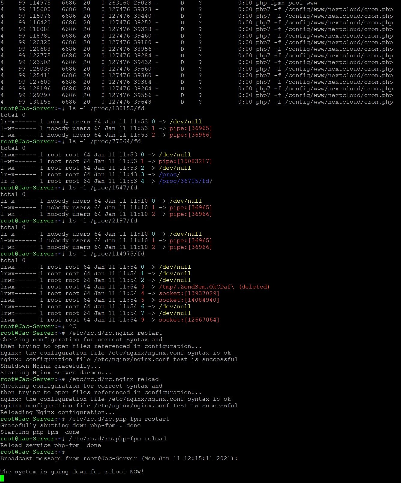

December 15, 20205 yr Mine has locked up again twice today so I am attempting to dig a little deeper. It appears that if you get the process ids from the processes found in D states using the command I posted above (ps axl | awk '$10 ~ /D/'), you can take those pids and get a list of file handles for those processes using the following command: ls -l /proc/pid/fd Here's my output: If my assumption is that all of these php-fpm workers are getting stuck on disk io, having 4 processes trying to write to that sqlite db could be the problem. I don't have redis or anything setup to handle transactional file locking either so my db is likely getting hit a lot for that. Are you all using sqlite databases? I was previously using mariadb (I think things were well) but the mariadb docker kept getting corrupted and it was tedious having to run commands all the time to fix it and get it running again. Edit: Switching to a mysql database and using a redis container for cache did not solve the issue. It seems as if I can recreate the problem fairly consistently by booting up my mobile app for some reason. Next debugging step is to use a temporary upload location that is off the array/primary cache. Edit 2: Moving my upload and php tmp directories off onto an unassigned disk seems to have helped, but the temporary directory was getting a lot of sess_XXXXXXXXXXXXXXXXXXXX files written to it. Turns out they are encrypted php session files. To further optimize and reduce disk usage I added the following lines to my nextcloud/php/php-local.ini file so that sessions would also be handled by redis session.save_handler = redis session.save_path = tcp://172.17.0.X:6379 After rebooting my NextCloud container again things seem to be working well. I will let it run for awhile and see if it lasts. Edited December 15, 20205 yr by jcsnider
