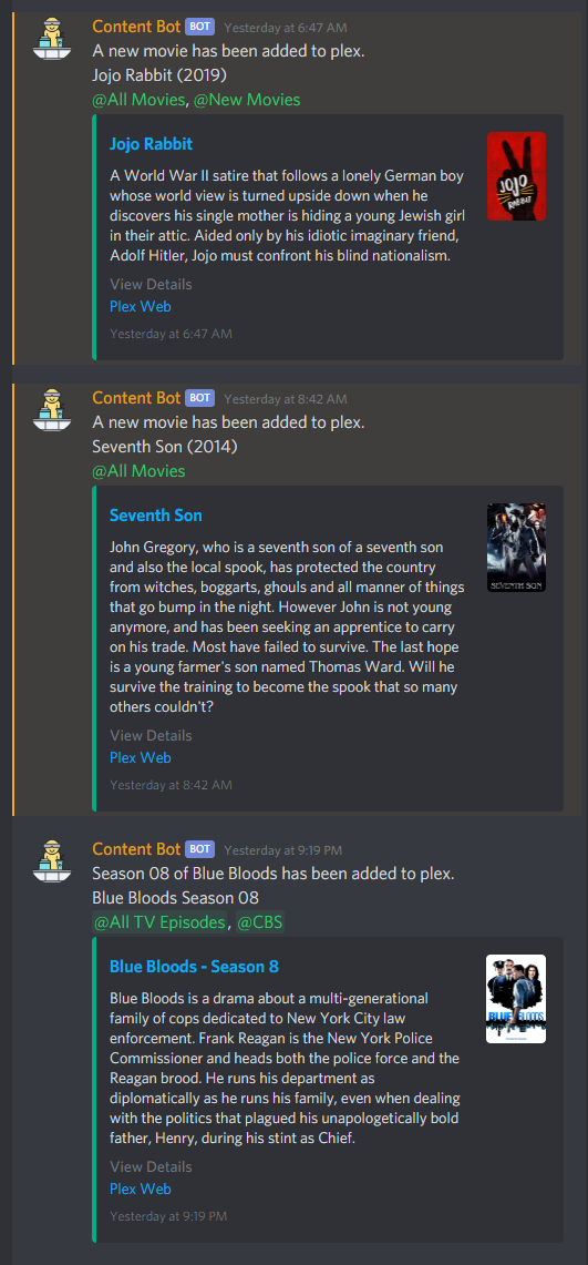

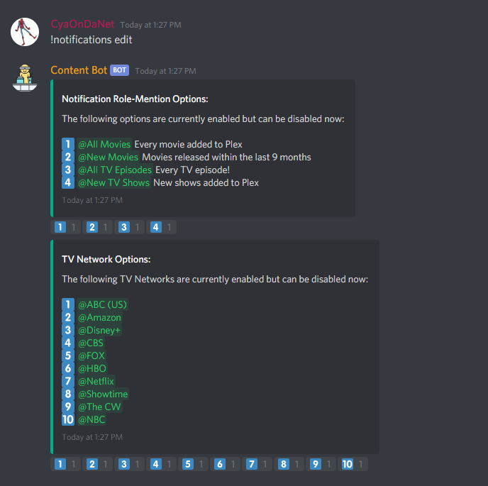

  11. @KINO The intention behind the role mentions is that the channel the notifications feed into is muted and set to notify @mentions only. That way the user is not constantly spammed by all notifications but rather the ones that matter to them. You can manually give shows a role using the bot commands if it didn't auto create it for the desired show. Firing off messages once per day is not currently possible. That gave me the idea of being able to set quiet hours, where the bot caches all messages during the window and sends them out once quiet hours are over. I will look into adding that; it should be possible to have it fire off once a day by just setting the quiet hours to only allow a 1 minute opening. It will be a little while before I can get to that as I need to refactor my code to work with Discord.js 12 first.

  14. Even if you don't select the movie react roles with `!notifications edit`, the #notifications channel you set up will still receive recently added movie notifications, just with no roles if none are enabled.
