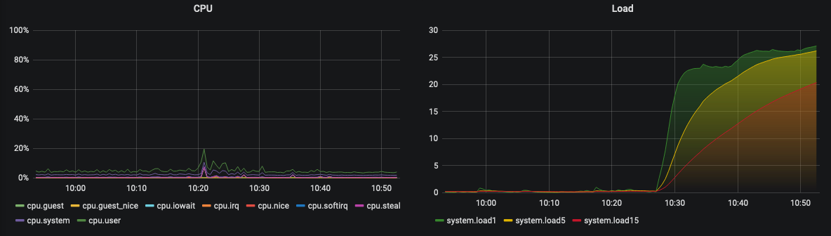

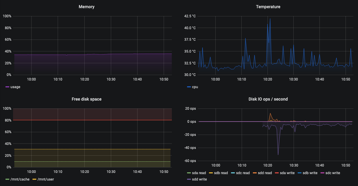

April 6, 20206 yr Hi, This is the fourth time this happened on my server: This has multiple impacts: - I cannot access certain Docker containers anymore (Nextcloud e.g.), but most of them are still running fine (all behind Traefik as reverse proxy). - Stopping (also forced), restarting, creating, deleting of Docker containers is no longer possible. Not via the GUI, terminal or Portainer. Commands are hanging. - Creating a diagnostics file is no longer possible. Not via GUI or terminal. - Stopping array is not possible anymore (hangs, think because docker is not responding) The only way to solve this is a (unclean) reboot. I think it is related to Nextcloud. All four times I was doing something with Nextcloud (altough Nextcloud is used often, so why only these four times?). Also since Nextcloud is not accessible anymore (gateway timeout). My guess is that it is network related, or could it be something else? And how to verify that? Like I said, its impossible to get a diagnostics report. I'm currently on 6.8.3, but happened also on 6.8.1. Some more graphs: Thanks! Edited April 6, 20206 yr by Rubene

May 3, 20206 yr Author 7 minutes ago, bonienl said: The load values which Linux reports includes IOWAIT time. If your drives have issues or are very busy, this is reflected in the load and makes your system sluggish. One cause can be that the folder "appdata" is located on the array instead of the cache and consequently all containers make heavy use of the array. Indeed, looks like it has something to do with IO. But I don't suspect the disks. The appdata folder is located on the cache drive. The 2 hard drives were both asleep. Also the cache drive had barely any ops (see also the screenshot in my first post). I suspect it has something to do with network. There I see the most correlation, but i'm not entirely sure yet.
