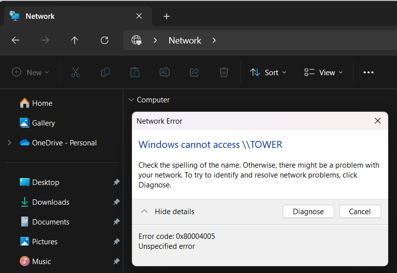

Hi, I’ve setup Tailscale on my unraid server and I’m also running the Up_flags:
--advertise-ex-route --advertise-routes=HomeVlan,IoTVlan
I’ve enabled the routes and the exit node in the admin console. I’ve also installed Tailscale on my laptop.
From my laptop (remotely) I can get to physical devices on my ‘IoTvlan’ and my 'HomeVlan' however I’m not able to access any of the docker containers running in unraid on the either of the vlans.
e.g from my laptop I can access my smart switches directly, but I’m not able to access HomeAssistant or Sonarr / Radarr etc. Each of my docker containers are assigned their own IP address on interface either br0 (safe vlan), or br0.12, my IoT vlan) - Locally this works with no issues. I use individual ip's on each of the dockers so that I can use port forwarding and firewall rules on my UDMP accordingly.
I’ve tried:
Assigning Tailscale it’s own ip in both vlans (one at a time)
Running Tailscale as Bridge and hosts
(Both of the options above throw a warning about IPv6 routing not working - despite being able to access physical device.)
I’ve enabled host device has access to custom networks.
I've ensured that the subnets are enabled in tailscale admin.
I've enabled the exit route on the remote device.
From the tailscale docker container console I’m able to ping all of the containers and physical devices on both vlan's by their IP addresses with no issues, from the connected clients I can ping other devices on the two subnets / vlands, but none of the docker containers.
I assume that any traffic coming from the tailscale network will appear to be coming from the unraid server if being looked at internally (i.e. from the perspective of the UDMP); so I do not believe this is a UDMP/Firewall issue.
I’m now out of ideas. - Can anyone advise how I might be able to fix this please? Thank you.

3 hours ago, karldonteljames said:
Is there no solution or support to this particular issue?
Ok, anything to do with advertise routes is specifically unsupported. It's custom networking, and at that point you need the tailscale forums, not unraid. I've added some more info to the front page to make this clear.
However on the plex front I'm not even sure what you are saying exactly.
Are you saying with a vanilla tailscale setup, no routes, no extra flags, when tailscale is running remote users can't use plex ?
They wouldn't be going over tailscale in this instance anyway.
Mine works completly fine in this situation, so if your install isn't we can try and debug that, but not with routes, sorry.
Edited by dsmith44
Yes I am using routes, but i'm not having issues with plex. My issue is the inability to access ANY docker images via their ip address, but I CAN access other physical devices on the network. (As outlined above on the 22nd January)
The issue I am having seems to be very similar to the one posted after with the plex issue and being able access docker images.
If you want to use routes, and get onto you network, I can only advise not using unraid as the place to run tailscale, put it on your firewall or even a raspberry pi. It's not the inteded use.
If someone wanted to add tailscale network vpn to unraid, should be in a plugin, not a container.
Running a vpn endpoint, inside a docker container, on a NAS, is asking for trouble/complexity.
I would connect to the console of the tailscale docker, and see if you can ping the other thing, if you can't this isn't a tailscale issue, it's a docker networking issue.
This may also be a place to start to get it running outside of docker.
https://gist.github.com/shayne/25e194e068751e281937ef68edefb99b
Last follow up on this, I connected to the console of my tailscale docker container and tried to ping another container that I have with a static ip address on my lan.
I cannot ping this, and so there is no hope of tailscale being able to route traffic to it.
I think the reason for this is:-
arp packets will be sent onto the ethernet from tailscale to get the mac address of the host with the ip addres, these arp packets will hit your ethernet switch, where it will broadcast them to all ports, except will not send them back the way they came and so the docker container never sees them, and doesn't respond. So the tailscale docker never sees an arp response, so can't send the packet to the right mac address, so cannot connect to it.
As I said, this isn't supported, and in fact cannot ever work now I've thought about it.
