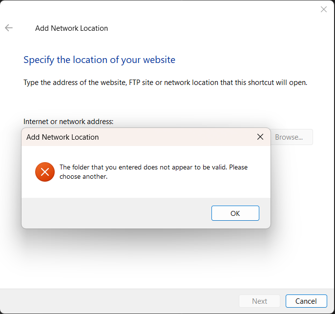

I cannot for the life of me get this to work with my samba shares on Unraid... It USED to work, but it hasn't worked at all for quite a few versions.
Here is my setup:
1. Installed Tailscale on my Unraid with this docker container (also set available as an exit node)
2. Installed Tailscale on my Laptop
3. Set up a DNS via Talscale blah-blah.ts.net
4. Connected both machines via Tailscale
5. On my laptop I've tried //TOWER/storage (cannot find) and mapping a network drive. eg. //tailscale_ip/share1, http://tailscale_dns/share1 and basically every single combination.
It was some many months ago I could simply go into my Network Locations in Windows and just type //TOWER and all my shares would show up. Now after an update of Tailscale or Unraid etc. this no longer happens. I could also map the network drives with simply: //tailscale_dns/share1
Nothing like this works anymore. It seems to try and connect because there's a lag whilst it attempts a connection but I just keep getting errors from Windows like:

It never even asks me for my share username and password.
Please someone, some help? Doesn't matter if I set to use an exit node or not. What could I be missing?

At this point @plantsandbinary I would stop using this and install the plugin instead.
This is really for special used cases using docker and private networks only now.
I would also try using ip addresses only to exclude dns issues in the first instance for troubleshooting.

this happened to me during unraid upgrade, it was not tailscale related --
i had to go into each SMB share and re-enable Export. They all worked after that.
