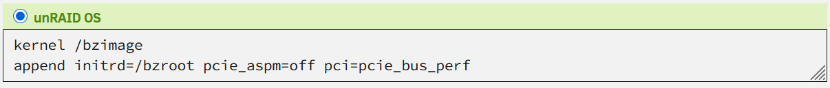

  2. Not sure on the partition I just orignally formatted in Windows (does Automount now in Unraid), see attached how UD shows it on boot. I ran chkdsk in Windows and seems to have fixed the initial mount problem. I've attached what I now have in Flash section. First option was Enabled, I've now Enabled Boot Support and disabled Resizable BAR - I couldn't find the GPIO3 option. This was the Syslog portion after that command. Mar 18 21:10:59 UNRAID kernel: pcieport 0000:40:00.0: bridge configuration invalid ([bus 00-00]), reconfiguring Mar 18 21:10:59 UNRAID kernel: pcieport 0000:41:01.0: bridge configuration invalid ([bus 00-00]), reconfiguring Mar 18 21:10:59 UNRAID kernel: pcieport 0000:41:02.0: bridge configuration invalid ([bus 00-00]), reconfiguring Mar 18 21:10:59 UNRAID kernel: pcieport 0000:41:04.0: bridge configuration invalid ([bus 00-00]), reconfiguring Mar 18 21:10:59 UNRAID kernel: pci_bus 0000:42: busn_res: [bus 42-59] end is updated to 59 Mar 18 21:10:59 UNRAID kernel: pci_bus 0000:5a: busn_res: [bus 5a] end is updated to 5a Mar 18 21:10:59 UNRAID kernel: pci_bus 0000:5b: busn_res: [bus 5b-72] end is updated to 72 Mar 18 21:10:59 UNRAID kernel: pci_bus 0000:41: busn_res: [bus 41-72] end is updated to 72Also have have attached Diags as of now - device back in. Maybe just the Thunderbolt on this motherboard isn't compatible, might just have to give up on this one. unraid-diagnostics-20260318-2114.zip

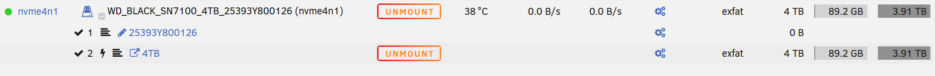

  5. WD Black SN7100 4TB is the drive inside the TB3 enclosure. nvme4n1 is what unassigned devices had as the reference when it showed up.

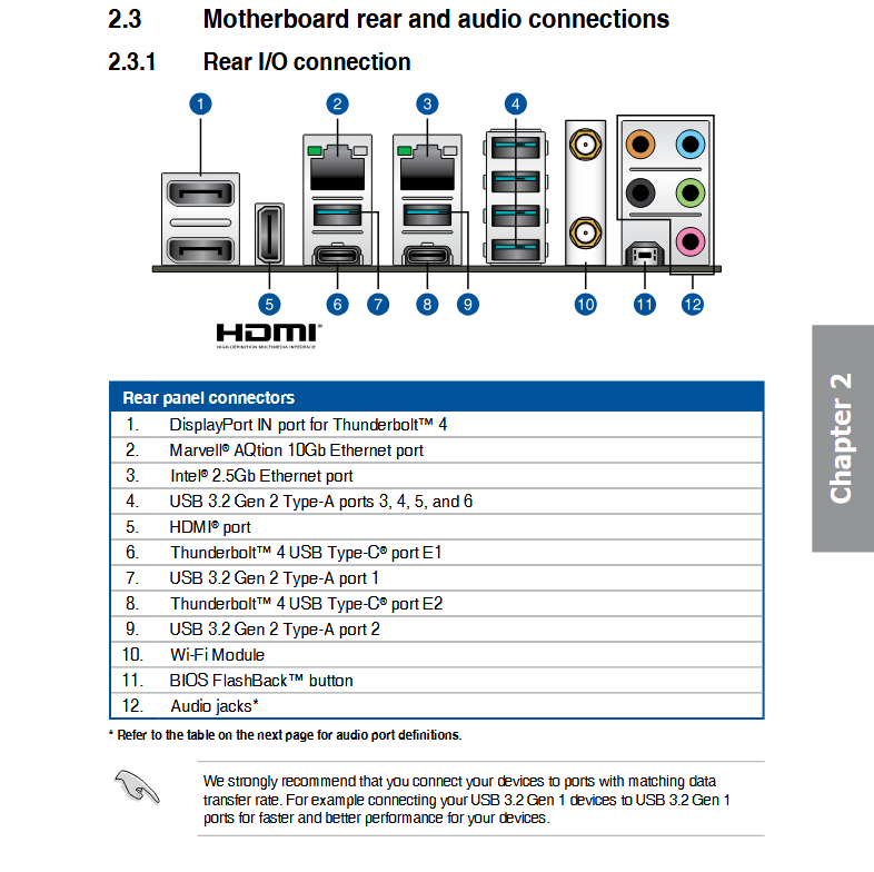

  10. Yes, that's the drive, not sure why it's showing those speeds for these ports but It's definitely connected correctly. See attached, drive is connected to port 8 (USB C TB4/USB4) and the Sandisk is connected to port 7 (slower USB A port) Would there be a reason it only shows on boot and can't be unplugged and plugged back in? (drive does light up) It's make it unusable at this point.
