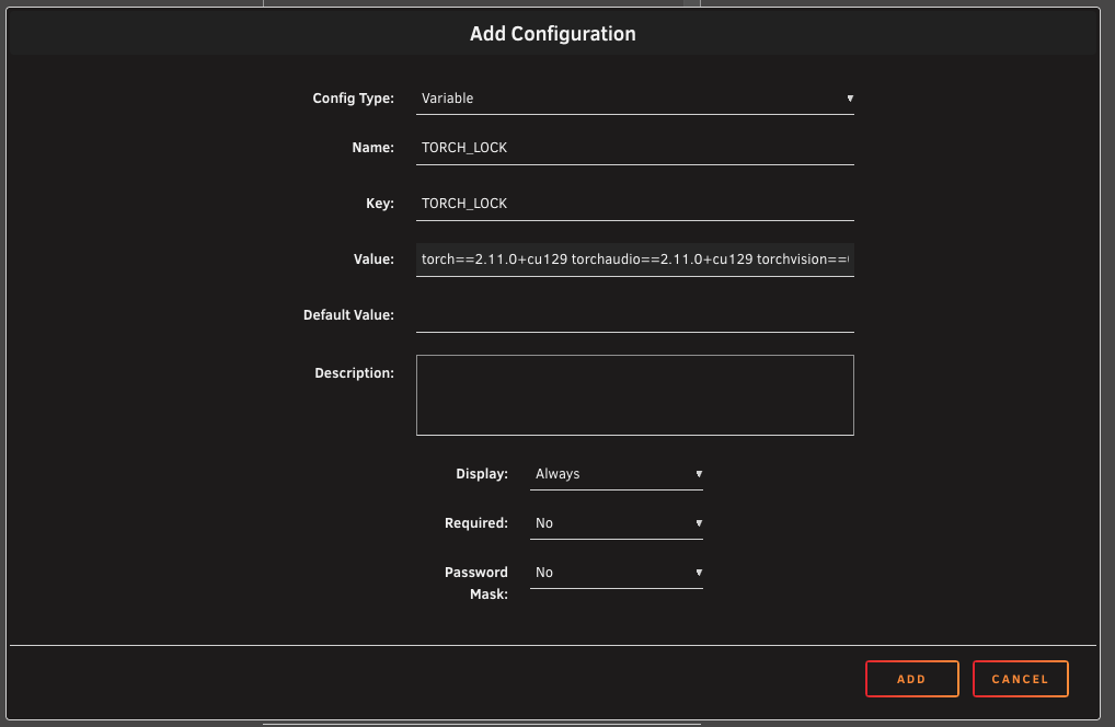

  11. I run the ubuntu24_cuda12.9 version on Unraid. It uses: torch==2.11.0+cu129 torchaudio==2.11.0+cu129 torchvision==0.26.0+cu129 From the "Docker" tab, click on the application icon and use "Edit" So I could add "Add another Path, Port, Variable, Label or Device" with the following parameters:

  14. I see: TorchAudio 2.11 "this release is compatible with torch 2.11 and is compatible with future versions of torch."
