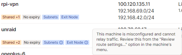

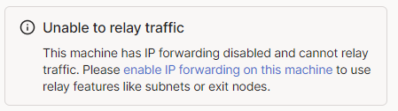

Did you have a chance to look into the warning about exit nodes I mentioned above? I'm definitely still getting this on the container vs my Raspberry Pi, but the subnet and exit route features are 100% working, so I'm not sure the cause for the warning.
UPDATE: This turned out to be because I had IPv6 forwarding off on my host.
