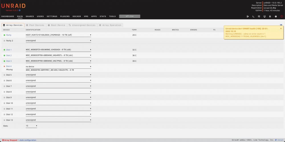

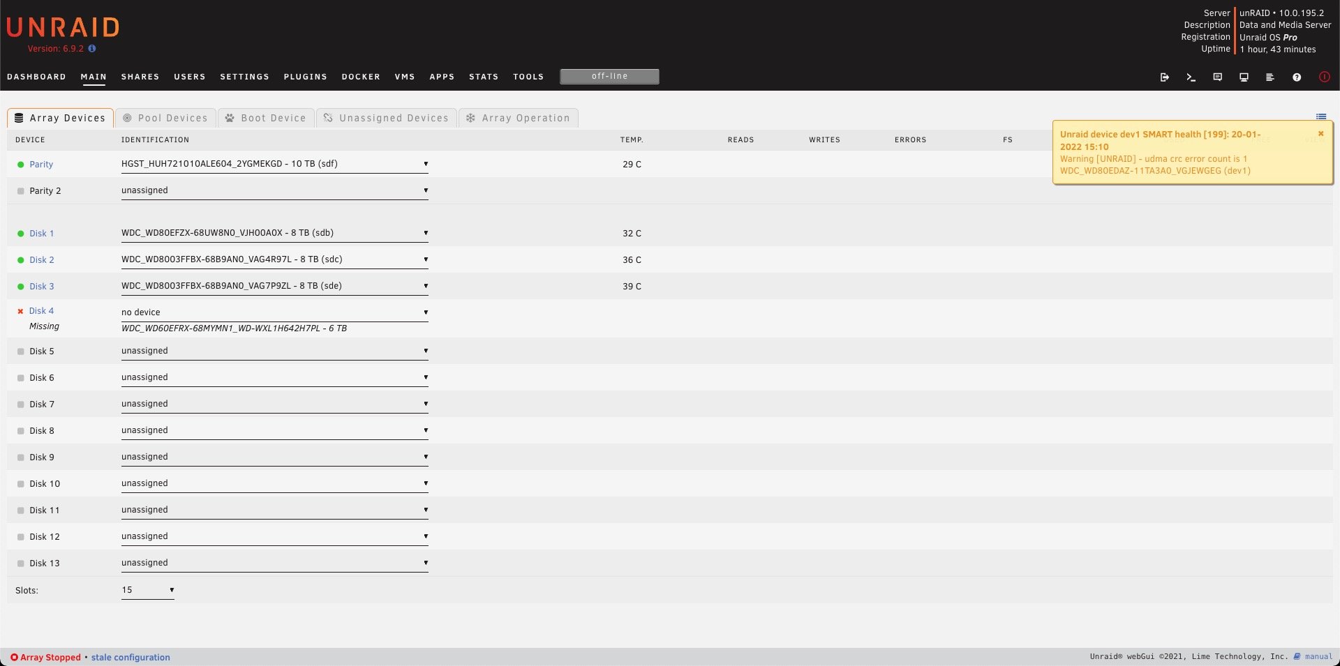

  10. It's been a while (a year or more) that I've had to change anything on my unRAID server, but today, I wanted to upgrade the only remaining 6TB drive to an 8TB. I did a clean shutdown via terminal, directly on my unRAID, then took out the 6TB and replaced it with an 8TB WD80EDAZ shucked from a new WD My Drive enclosure. Now that I am back at home and have taken a look at what I am faced with, I am greeted by the following situation (see attached). So, the new drive shows a CRC error, and I don't want to do anything to jeopardize the health of my array. What is the safest way to proceed? If possible, could anyone give me very specific step-by-step directions to properly have this 8TB take the place of the removed 6TB drive? I faintly remember having to do a Preclear first, or is that not correct? Anyway, what to do, what to do?
