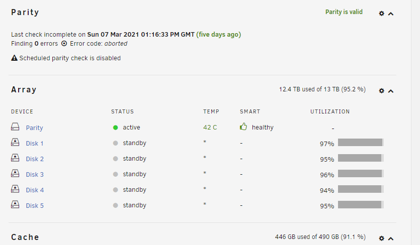

This is my test/dev server, I was coping VM img(500Gb) files at the time from Prod to the secondpool as backing up before I upgrade it to 6.9
tower-diagnostics-20210312-0708.zip
Also as a side note, when I collected the dags, all the drives where spun down, so it spins up to provide the smartctl.
But now the array doesn't show this, all the drives show as spun down. Parity is only showing active as I did a manual spin up. Guessing this is due to the additional fix Tom put in for 6.9.1.
Is there a way with emcmd to trigger a spin up like we used to be able to do with mdcmd or an array check. Poll doesn't check as array believes they are down?
or add processing into sdspin to tell the arrary if used outside of gui?
What is your Settings -> Disk Settings -> Tunable (poll_attributes) set to? The spin up/down status will lag that many seconds behind reality.
Oh, I have your diagnostics :) Looks like that tunable is set to 1800 seconds (a half hour). I have mine set to 300 (5 minutes)
30mins but it was hours after I noticed then spinning. Issue array wont notice now after 6.9.1 for smartctl fix. Poll wont action as array thinks they are spun down.
OK TBH I have not been following the spin up/down issues too closely, plenty of other bits to focus on ;) Maybe you can find another thread to add your experience to? I don't recall anyone mentioning diags in relation to spin up/down.  it will probably be missed in this thread
