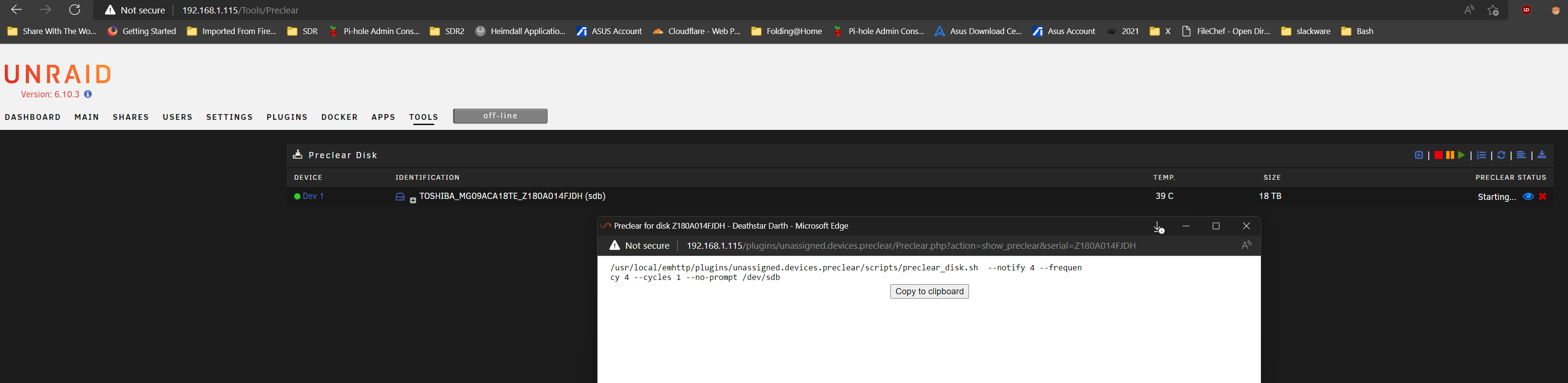

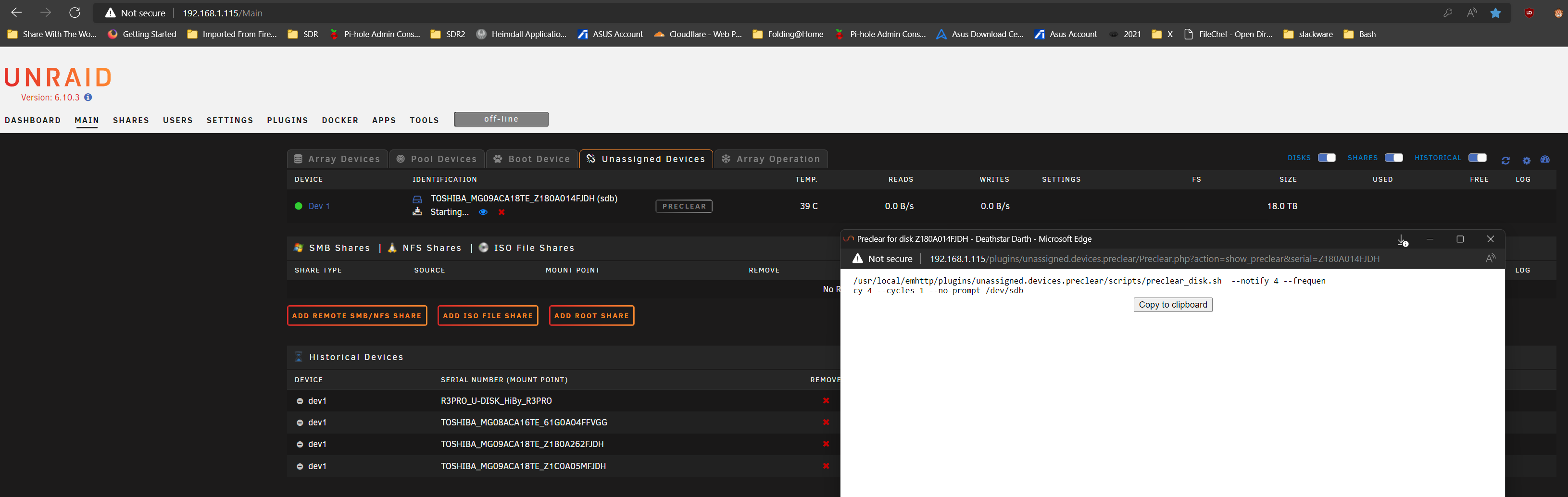

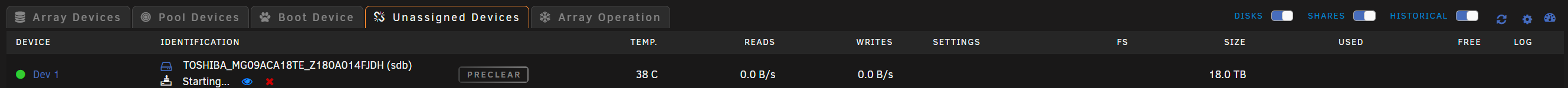

  13. yes, that's correct. I replied late last night whilst away but didn't have my forum login details to hand so it looks like it gets blocked pending a moderator (just in case you see a similar post later). I rebooted in regular (rather than safe) mode, installed the binhex preclear docker, ran that, and it behaved well I forgot to disable the weekly backup and the law of sod being what it is, it was scheduled for early this morning so got interrupted. I restarted it earlier and its 45% of the way through the read cycle....so fingers crossed from here on in. Update 2022-09-08 07:45 BST - still running happily. Fully expect it to complete Update 2022-09-09 13:45 BST - at 94% of stage 10/10 so unless there is final 'gotcha', we look good.
