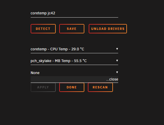

click unload drivers, then add the smsc driver, then load, then save.
but i still don't think it will work without hwmon support

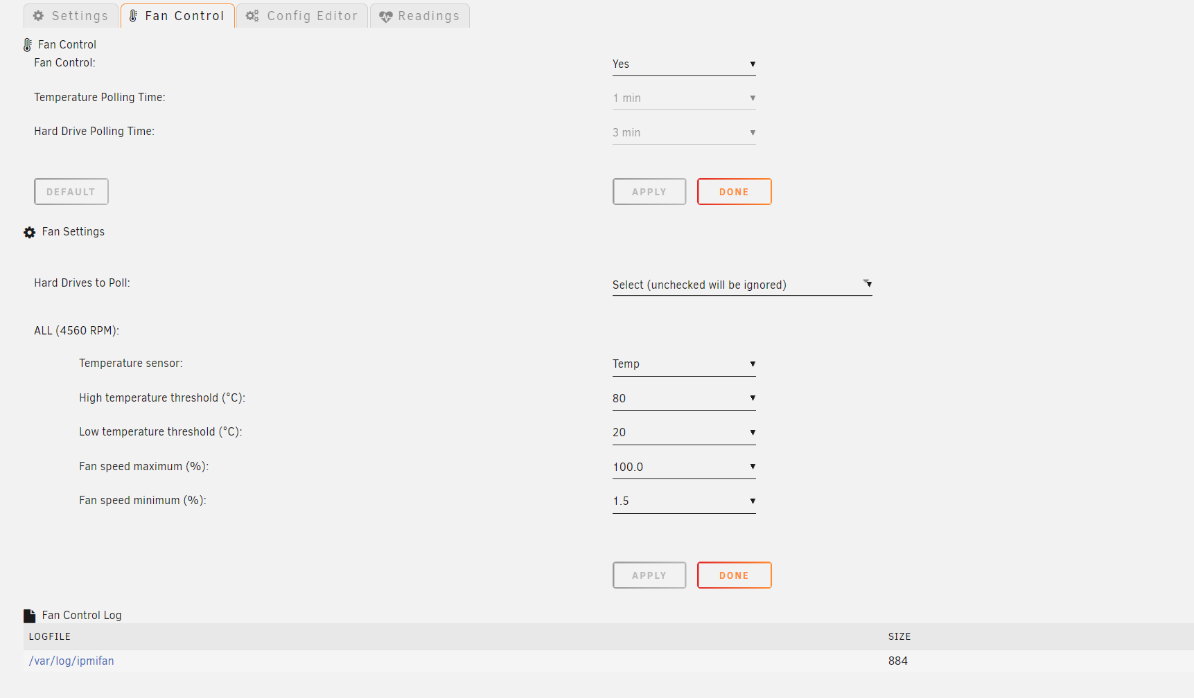

I have a test/dev version for Dell Servers. https://raw.githubusercontent.com/SimonFair/IPMI-unRAID/Dell-support/plugin/ipmi.plg
At present I there is only 1 fan group. But I think we can extend to others.
Values are likley needed to be adjusted for Dell. As may fans are
2023-12-01 16:59:24 Starting Fan Control
2023-12-01 16:59:24 Setting fans to manual
2023-12-01 16:59:24 Fan:Temp, FAN1234(39%):Temp(43°C)
2023-12-01 17:02:25 Fan:Temp, FAN1234(33%):Temp(39°C)
Any ASRock users able to test? the dev release to confirm working ok still?
seems to be working. i agree the log entries do not match the fan name
Fan name ALL and log says FAN1234

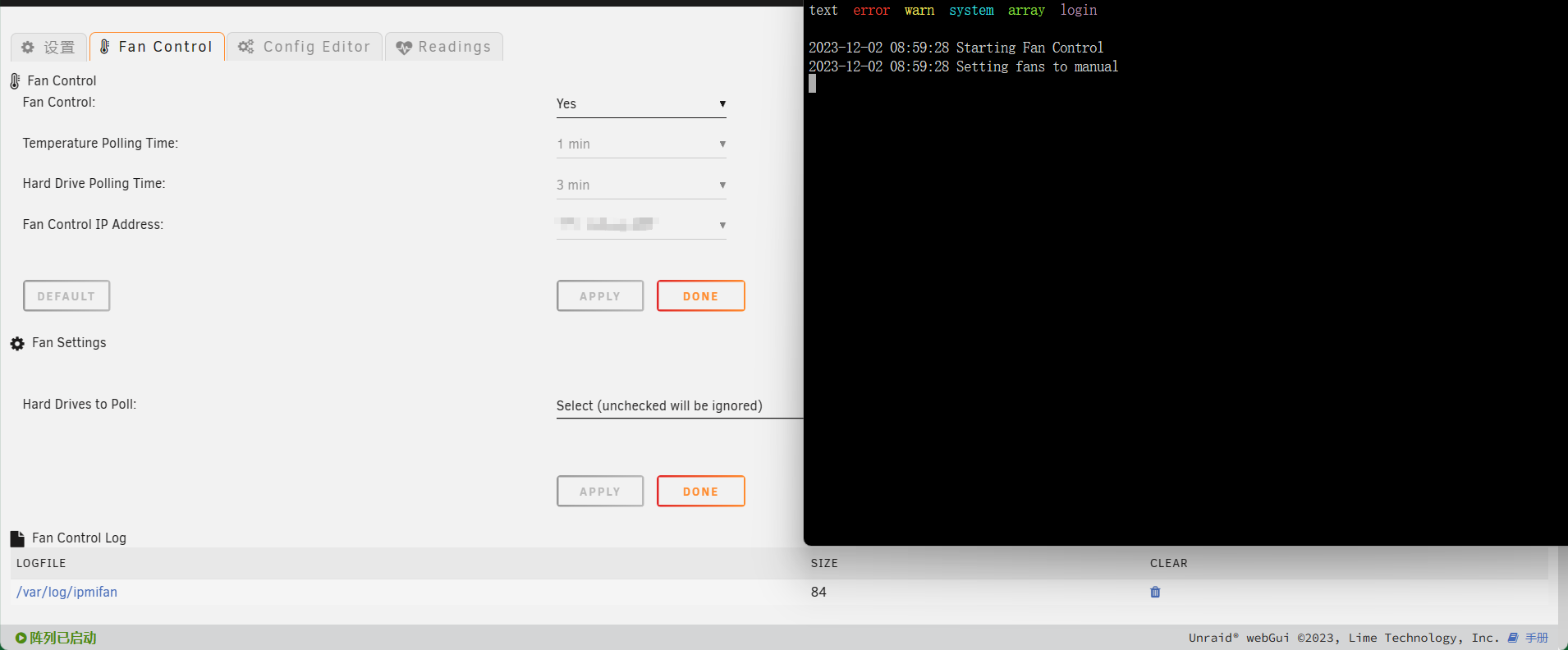

Dell r730xd:
seems to be not working(Dell r730xd).
