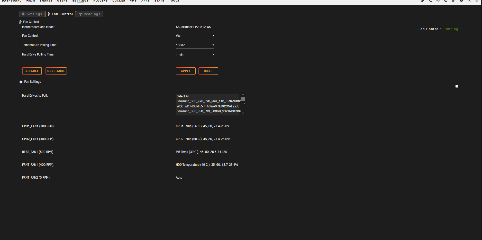

    I have been using IPMI tools for quite some time and for some reason it stopped working but wont allow me to enter new username or password. How do I go about this?

44 minutes ago, mikeyosm said:
Yep, here's the content of the file...
/boot/config/plugins/ipmi# cat board.json
    "ASRockRack": {
        "raw": "00 3a 01",
        "auto": "00 00 00 00 00 00 00 00",
        "full": "64 64 64 64 64 64 64 64",
        "fans": {
            "FAN_POS1": "01",
            "FAN_POS2": "01",
            "FAN_POS3": "01",
            "FAN_POS4": "01",
            "FAN_POS5": "01",
            "FAN_POS6": "01",
            "FAN_POS7": "01",
            "FAN_POS8": "01"
If you run ipmi-raw 00 3a 01 21 64 64 64 64 64 64 64 in the command line do you get a response code?
On 12/3/2023 at 9:17 PM, Gunny said:
@SimonFonly thing I can think of would be to add the json files to the config editor dropdown so people less technically inclined can still see/adjust those files if necessary.
Added option for JSON in the editor page.
Yep -
rcvd: 01 C1
hmm, I updated to 12.06 and the fan control still works with my existing config files, but the settings page is broken now and I can't see or modify anything.  Clicking on the buttons causes a new tab to be opened.  If I remove my board.json config, the settings page starts to work again, but restoring it causes it to break
    "ASRockRack": {
        "raw": "00 3a 01",
        "full": "01 64 64 64 64 64 00 00",
        "fans": {
            "CPU1_FAN1": "01",
            "CPU2_FAN1": "01",
            "REAR_FAN1": "01",
            "FAN_POS4": "01",
            "FRNT_FAN1": "01",
            "FAN_POS6": "01",
            "FAN_POS7": "01",
            "FAN_POS8": "01"
Edited by Gunny
    "ASRockRack": {
        "raw": "00 3a 01",
        "fans": {
            "CPU1_FAN1": "01",
            "CPU2_FAN1": "01",
            "REAR_FAN1": "01",
            "FAN_POS4": "01",
            "FRNT_FAN1": "01",
            "FAN_POS6": "01",
            "FAN_POS7": "01",
            "FAN_POS8": "01"
Would you be able to send me copy of ipmi-sensors also

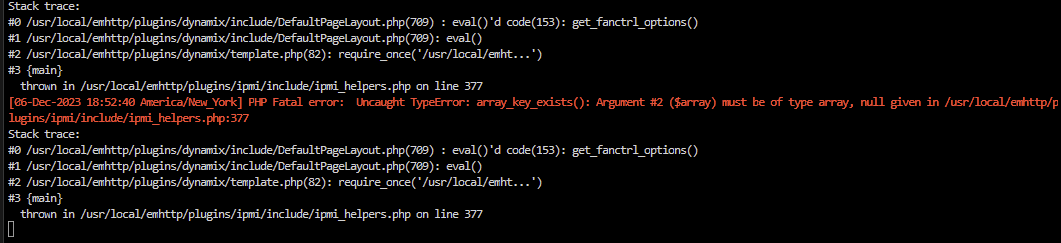

Also if running 6.12 can you look to see if any PHP errors. via tools->php settings view log.
5 hours ago, SimonF said:
Release 2023.12.06
Add secondary Temp check if HDD is primary and disk have spundown.
Add JSON to config page.
Also shows F in fans page.
looks great, would it be possible to seperate the hdd hi/low temp/speed and the CPU hi/low temp/speed? as cpu runs hotter then hdds, so the settings for the hdds don't work well for cpu. IE fans are alway spinning more when hdds spin down vs when hdds are spun up
Ah, I was wondering if there was a place for php logs thanks for the tip
[06-Dec-2023 18:52:40 America/New_York] PHP Fatal error:  Uncaught TypeError: array_key_exists(): Argument #2 ($array) must be of type array, null given in /usr/local/emhttp/plugins/ipmi/include/ipmi_helpers.php:377
Stack trace:
#0 /usr/local/emhttp/plugins/dynamix/include/DefaultPageLayout.php(709) : eval()'d code(153): get_fanctrl_options()
#1 /usr/local/emhttp/plugins/dynamix/include/DefaultPageLayout.php(709): eval()
#2 /usr/local/emhttp/plugins/dynamix/template.php(82): require_once('/usr/local/emht...')
#3 {main}
  thrown in /usr/local/emhttp/plugins/ipmi/include/ipmi_helpers.php on line 377

Looking at the line that threw the error, I was able to fake it out by adding a 2nd board with no fans on it:
    "ASRockRack": {
        "raw": "00 3a 01",
        "fans": {
            "CPU1_FAN1": "01",
            "CPU2_FAN1": "01",
            "REAR_FAN1": "01",
            "FAN_POS4": "01",
            "FRNT_FAN1": "01",
            "FAN_POS6": "01",
            "FAN_POS7": "01",
            "FAN_POS8": "01"
    "fake": {
        "raw": "00 3a 01",
        "fans": {
I think the issue is fundamentally the code makes assumptions about board functionality in the code itself, and doesn't utilize the config files as the source of truth for what to do.  Like in the ipmi_settings_fan.php where $cmd_count gets set, instead of counting the sections in the board.json to determine how many ipmi commands need to get run, it assumes it needs to send a command for each cpu socket on ASRock boards.
Stack trace:
#3 {main}
Can you tell me what the output of this is for your machine?
/usr/bin/lscpu | grep 'Socket(s):' | awk '{print $2}'
