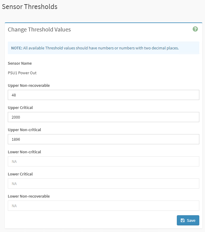

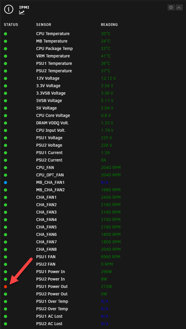

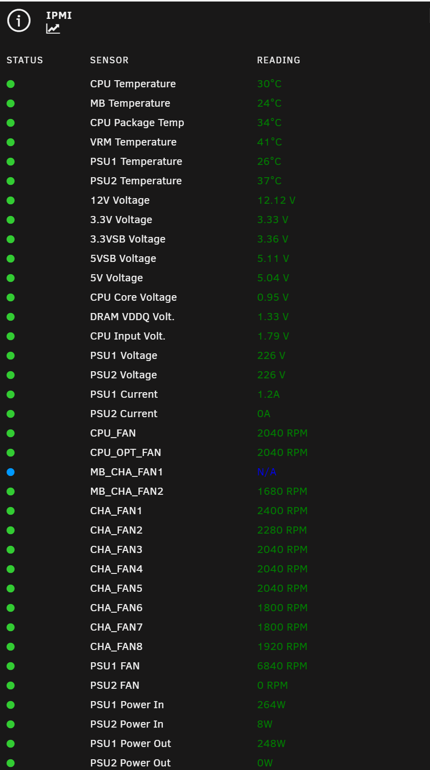

First what a GREAT plugin! - I just installed it and everything works out of the box!
I just have one question or two (Might be stupid ones, sorry)
I have a red icon on PSU1 Power Out is this a warning? (Haven't seen anything in the IPMI configuration.
IPMI interface:
And does all the N/A mean that I can remove them, or that they could get a value if for example the PSU2 would take over?
Also I could never get the IPMI e-mail notification service working, would enabling notification use the Unraid e-mail notification instead?
Thanks again your work is much appreciated.
IPMI interface:
Would you be able to send the raw sensor data
/usr/sbin/ipmi-sensors --output-sensor-thresholds --comma-separated-output --output-sensor-state --no-header-output --interpret-oem-data
Where are you setting this?
Yes of course:
# /usr/sbin/ipmi-sensors --output-sensor-thresholds --comma-separated-output --output-sensor-state --no-header-output --interpret-oem-data
3,CPU Temperature,Temperature,Nominal,31.00,C,N/A,N/A,N/A,98.00,99.00,100.00,'OK'
5,MB Temperature,Temperature,Nominal,24.00,C,N/A,N/A,N/A,60.00,70.00,95.00,'OK'
6,TR1 Temperature,Temperature,N/A,N/A,C,N/A,N/A,N/A,100.00,100.00,100.00,N/A
7,TR2 Temperature,Temperature,N/A,N/A,C,N/A,N/A,N/A,100.00,100.00,100.00,N/A
8,TR3 Temperature,Temperature,N/A,N/A,C,N/A,N/A,N/A,100.00,100.00,100.00,N/A
9,CPU Package Temp,Temperature,Nominal,35.00,C,N/A,N/A,N/A,95.00,100.00,105.00,'OK'
10,VRM Temperature,Temperature,Nominal,41.00,C,N/A,N/A,N/A,110.00,110.00,110.00,'OK'
11,PSU1 Temperature,Temperature,Nominal,26.00,C,N/A,N/A,N/A,50.00,63.00,63.00,'OK'
12,PSU2 Temperature,Temperature,Nominal,37.00,C,N/A,N/A,N/A,50.00,63.00,63.00,'OK'
15,12V Voltage,Voltage,Nominal,12.12,V,9.60,10.20,10.80,13.20,13.80,14.40,'OK'
16,3.3V Voltage,Voltage,Nominal,3.34,V,2.64,2.80,2.98,3.63,3.79,3.97,'OK'
17,3.3VSB Voltage,Voltage,Nominal,3.36,V,2.64,2.80,2.98,3.63,3.79,3.97,'OK'
18,5VSB Voltage,Voltage,Nominal,5.11,V,4.01,4.25,4.51,5.50,5.76,6.00,'OK'
19,5V Voltage,Voltage,Nominal,5.04,V,4.01,4.25,4.51,5.50,5.76,6.00,'OK'
20,CPU Core Voltage,Voltage,Nominal,1.00,V,0.00,0.00,0.00,2.11,2.21,2.30,'OK'
21,DRAM VDDQ Volt.,Voltage,Nominal,1.33,V,0.80,0.85,0.90,2.20,2.30,2.40,'OK'
23,CPU Input Volt.,Voltage,Nominal,1.79,V,1.20,1.26,1.34,2.32,2.42,2.53,'OK'
24,PSU1 Voltage,Voltage,Nominal,227.00,V,N/A,N/A,N/A,N/A,N/A,N/A,'OK'
25,PSU2 Voltage,Voltage,Nominal,227.00,V,N/A,N/A,N/A,N/A,N/A,N/A,'OK'
28,PSU1 Current,Current,Nominal,1.20,A,N/A,N/A,N/A,N/A,N/A,N/A,'OK'
29,PSU2 Current,Current,Nominal,0.00,A,N/A,N/A,N/A,N/A,N/A,N/A,'OK'
32,CPU_FAN,Fan,Nominal,2040.00,RPM,0.00,360.00,360.00,N/A,N/A,N/A,'OK'
33,CPU_OPT_FAN,Fan,Nominal,2040.00,RPM,0.00,360.00,360.00,N/A,N/A,N/A,'OK'
34,MB_CHA_FAN1,Fan,N/A,N/A,RPM,0.00,360.00,360.00,N/A,N/A,N/A,N/A
35,MB_CHA_FAN2,Fan,Nominal,1800.00,RPM,0.00,360.00,360.00,N/A,N/A,N/A,'OK'
36,MB_CHA_FAN3,Fan,N/A,N/A,RPM,0.00,360.00,360.00,N/A,N/A,N/A,N/A
37,MB_CHA_FAN4,Fan,N/A,N/A,RPM,0.00,360.00,360.00,N/A,N/A,N/A,N/A
38,MB_CHA_FAN5,Fan,N/A,N/A,RPM,0.00,360.00,360.00,N/A,N/A,N/A,N/A
43,MB_AIO_PUMP,Fan,N/A,N/A,RPM,0.00,360.00,360.00,N/A,N/A,N/A,N/A
44,CHA_FAN1,Fan,Nominal,2400.00,RPM,0.00,360.00,360.00,N/A,N/A,N/A,'OK'
45,CHA_FAN2,Fan,Nominal,2160.00,RPM,0.00,360.00,360.00,N/A,N/A,N/A,'OK'
46,CHA_FAN3,Fan,Nominal,2040.00,RPM,0.00,360.00,360.00,N/A,N/A,N/A,'OK'
47,CHA_FAN4,Fan,Nominal,1920.00,RPM,0.00,360.00,360.00,N/A,N/A,N/A,'OK'
48,CHA_FAN5,Fan,Nominal,1920.00,RPM,0.00,360.00,360.00,N/A,N/A,N/A,'OK'
49,CHA_FAN6,Fan,Nominal,1680.00,RPM,0.00,360.00,360.00,N/A,N/A,N/A,'OK'
50,CHA_FAN7,Fan,Nominal,1680.00,RPM,0.00,360.00,360.00,N/A,N/A,N/A,'OK'
51,CHA_FAN8,Fan,Nominal,1920.00,RPM,0.00,360.00,360.00,N/A,N/A,N/A,'OK'
52,PSU1 FAN,Fan,Nominal,6840.00,RPM,N/A,N/A,N/A,N/A,N/A,N/A,'OK'
53,PSU2 FAN,Fan,Nominal,0.00,RPM,N/A,N/A,N/A,N/A,N/A,N/A,'OK'
56,PSU1 Power In,Power Supply,Nominal,264.00,W,N/A,N/A,N/A,N/A,N/A,N/A,'OK'
57,PSU2 Power In,Power Supply,Nominal,8.00,W,N/A,N/A,N/A,N/A,N/A,N/A,'OK'
60,PSU1 Power Out,Power Supply,Nominal,240.00,W,N/A,N/A,N/A,1896.00,2000.00,2000.00,'OK'
61,PSU2 Power Out,Power Supply,Nominal,0.00,W,N/A,N/A,N/A,1896.00,2000.00,48.00,'OK'
64,PSU1 Over Temp,Temperature,Nominal,N/A,N/A,N/A,N/A,N/A,N/A,N/A,N/A,'transition to OK'
65,PSU2 Over Temp,Temperature,Nominal,N/A,N/A,N/A,N/A,N/A,N/A,N/A,N/A,'transition to OK'
68,PSU1 AC Lost,Power Supply,Nominal,N/A,N/A,N/A,N/A,N/A,N/A,N/A,N/A,'Presence detected'
69,PSU2 AC Lost,Power Supply,Nominal,N/A,N/A,N/A,N/A,N/A,N/A,N/A,N/A,'Presence detected'
72,PSU1 Slow FAN1,Fan,Nominal,N/A,N/A,N/A,N/A,N/A,N/A,N/A,N/A,'transition to OK'
73,PSU2 Slow FAN1,Fan,Nominal,N/A,N/A,N/A,N/A,N/A,N/A,N/A,N/A,'transition to OK'
76,PSU1 PWR Detect,Power Supply,Nominal,N/A,N/A,N/A,N/A,N/A,N/A,N/A,N/A,'Presence detected'
77,PSU2 PWR Detect,Power Supply,Nominal,N/A,N/A,N/A,N/A,N/A,N/A,N/A,N/A,'Presence detected'
80,PSU1 Over Curr,Current,Nominal,N/A,N/A,N/A,N/A,N/A,N/A,N/A,N/A,'transition to OK'
81,PSU2 Over Curr,Current,Nominal,N/A,N/A,N/A,N/A,N/A,N/A,N/A,N/A,'transition to OK'
85,VERSION_ERR,Version Change,Nominal,N/A,N/A,N/A,N/A,N/A,N/A,N/A,N/A,'OK'
87,Watchdog2,Watchdog 2,Nominal,N/A,N/A,N/A,N/A,N/A,N/A,N/A,N/A,'OK'
The email notification in the IPMI would require me to have my own e-mail server (Google have to many special steps for the IPMI to work)
Sorry I thought there was a integration between this IPMI and the Unraid Notification Settings.
I can see that its a event notification (My mistake)
UPDATE:
After running the command I now have it Green?
Edited by casperse

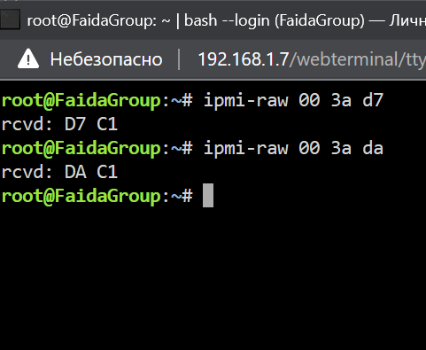

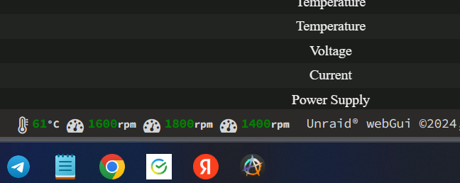

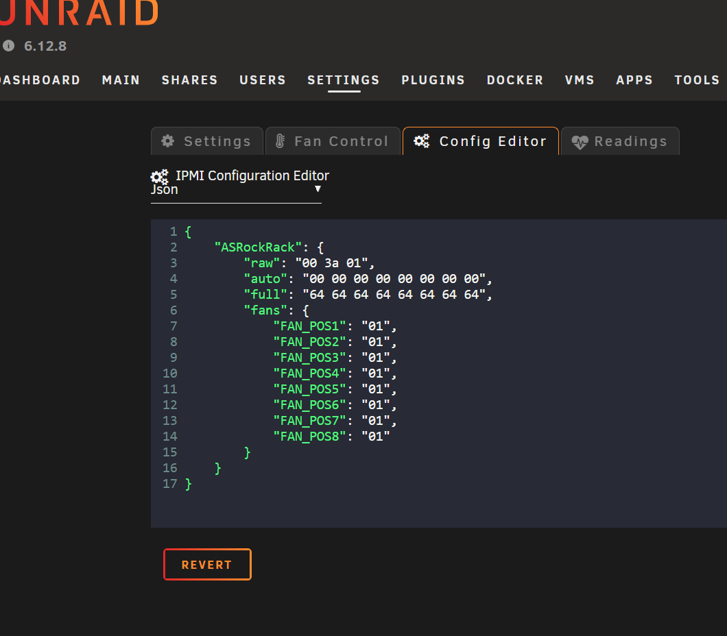

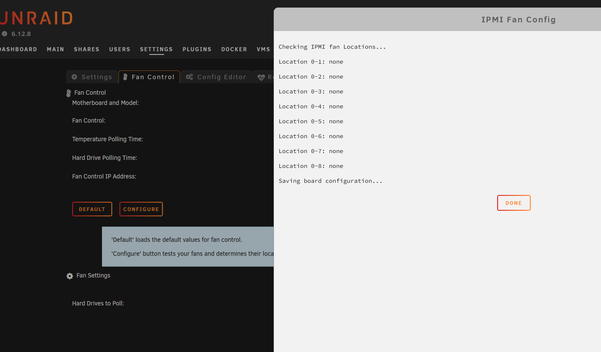

Asrock rack b650d4u-2l2t/bcm
not work fan control
Spoiler
Spoiler
Can you tell me what needs to be done to make the fan control work?
Indicators work, management doesn’t.
Spoiler
