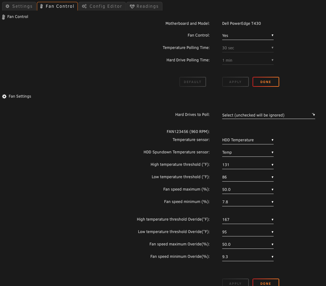

2 hours ago, spl147 said:
log on unRAID 7 shows html tags instead of symbols:
2025-01-21 09:36:49 Starting Fan Control
2025-01-21 09:36:49 Board: Dell Board Model: PowerEdge T430
2025-01-21 09:36:49 Setting fans to manual
2025-01-21 09:36:59 Fan:Temp, FAN123456(22%):HDD Spundown using Temp(100 °F)
2025-01-21 09:37:59 Fan:Temp, FAN123456( 9%):HDD Temp(79 °F)
2025-01-21 09:44:52 fan control config file updated, reloading settings
2025-01-21 09:44:52 Fan:Temp, FAN123456( 8%):HDD Temp(84 °F)
2025-01-21 09:50:25 Fan:Temp, FAN123456(10%):HDD Temp(88 °F)
2025-01-21 10:14:35 Fan:Temp, FAN123456(16%):HDD Temp(95 °F)
2025-01-21 10:22:38 Fan:Temp, FAN123456(15%):HDD Temp(93 °F)
2025-01-21 10:23:38 Fan:Temp, FAN123456(16%):HDD Temp(95 °F)
2025-01-21 10:25:39 Fan:Temp, FAN123456(15%):HDD Temp(93 °F)
2025-01-21 10:26:40 Fan:Temp, FAN123456(16%):HDD Temp(95 °F)
2025-01-21 10:29:41 Fan:Temp, FAN123456(15%):HDD Temp(93 °F)
2025-01-21 10:31:42 Fan:Temp, FAN123456(16%):HDD Temp(95 °F)
2025-01-21 10:36:44 Fan:Temp, FAN123456(15%):HDD Temp(93 °F)
2025-01-21 10:38:44 Fan:Temp, FAN123456(16%):HDD Temp(95 °F)
2025-01-21 10:43:46 Fan:Temp, FAN123456(15%):HDD Temp(93 °F)
2025-01-21 10:46:48 Fan:Temp, FAN123456(16%):HDD Temp(95 °F)
2025-01-21 10:47:48 Fan:Temp, FAN123456(23%):HDD Spundown using Temp(102 °F)
2025-01-21 10:49:19 Fan:Temp, FAN123456(21%):HDD Spundown using Temp(100 °F)
2025-01-21 11:38:39 Fan:Temp, FAN123456(23%):HDD Spundown using Temp(102 °F)
2025-01-21 11:39:39 Fan:Temp, FAN123456(21%):HDD Spundown using Temp(100 °F)
They have add the degrees symbol for the gui, Will add a change to strip out the html from the log.

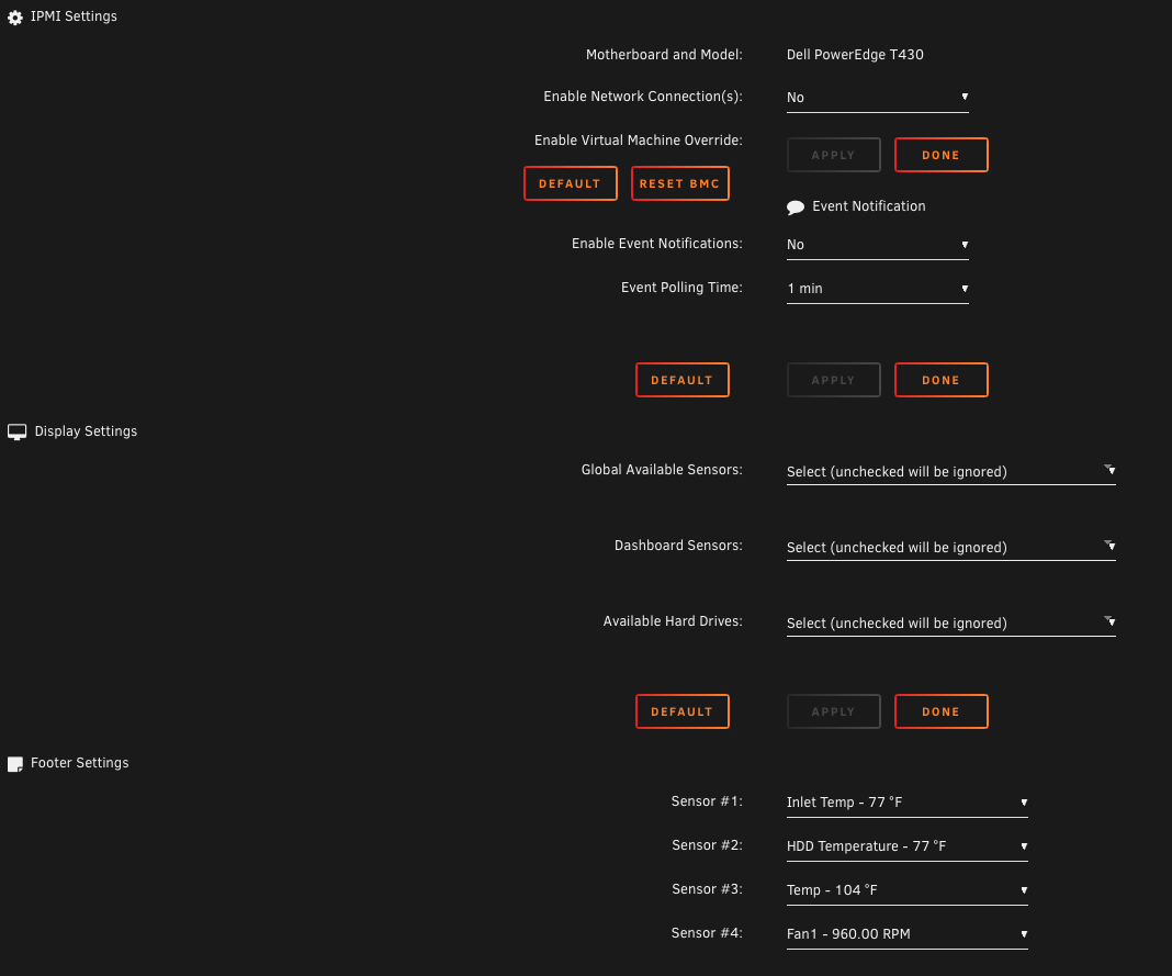

ok so i think i've actually solved it, i did the following:
Motherboard and Model: Dell
Enable Network Connection(s): No
Enable Virtual Machine Override: Dell
Motherboard Model: Any
then in Fan Control i set it to Yes, then under fan settings i had to enable Advanced View and set the temperature sensor and fan speeds there and it seems to have worked.
Have you set to version 2?
56 minutes ago, RazorX said:
for the IPMI support plugin, when i type in the ip address of the idrac or type in local host i get connection failed
You do not use ip for the ipmi plugin, you are on the machine you are controlling
no, should i?
9 minutes ago, RazorX said:
no, should i?
I think idrac needs lanplus which is version 2.
you do NOT need to use network connection!
right, with the network connection set to no now, i don't have to worry about that
