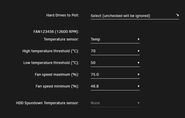

Your settings are crazy, if you are using cpu as your temp to poll you only have a 10c differential, no to mention your low temp threshold is below your current temp. Low temp should be close to your idle temp, and max should be close to the max temp you want when your fans are screaming. Min fan temp should be the lowest possible to maintain idle temp and max should be as loud as you want to deal with while being able to keep the cpu under max.
it’s a try and see to find the proper mix, i used the ipmi-raw command in terminal to play with fan speeds, and the cpu corefreq plug-in to load the cpu and adjust the fans using the ipmi-raw command to find the right balance
I understand - but I have a GPU and my fans go crazy unless I have my settings this way. These are dual Xeon 2680v4's, and they're currently idling at 53. I want the fans running at 46.8 constantly unless temps rise.
Everything was working fine earlier during our earlier chat, and saw the poller every 30 seconds in the log. Now, it only polled once upon initial start.
I appreciate your suggestions and will make some changes - but I still don't understand why there's no more additional polling.

Have you ran the command in terminal to override the pcie not supported issue (gpu not using dell firmware or not a supported card)
it’s because you settings are to narrow and the log will not reflect if nothing has changed

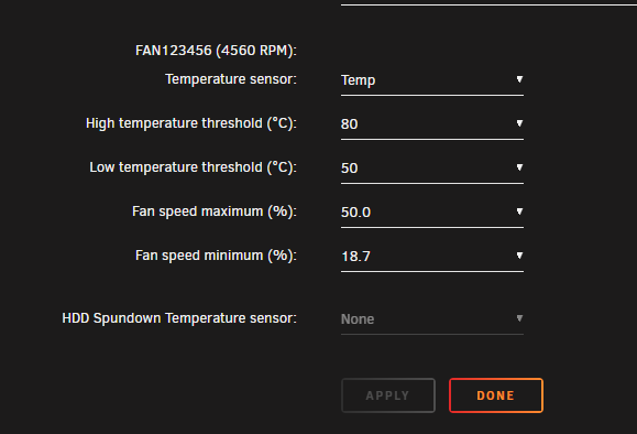

OK - I changed it to the following, and now I'm seeing it poll every 30 seconds:
it still polls at the time you set, but only posts to the log if it is actually making a change to the fans, as to not clog up the log with a bunch of redundant non-changes
you were below your low temp threshold, so the fans were just running at minimum speed

how how it is in the room where your server is? what is "idle" to you?
these are my settings (r730xd with 2x 2680v4):
my fans have been idle all day (at 18%) and my cpus are in the 44c-47c range.
something seems off. do you have the flat, low profile heatsinks or the tower heatsinks?
Inlet temp is 18c down here in the basement where I have the rack. Yes, low profile heat sinks because I have the midplane installed with 4 drives internally, in addition to the 12 3.5's in the front, and 2 2.5's in the rear. CPU's idle anywhere between 53-60c.

It’s because of the gpu, dell has a pcie override that blasts fans, there is a command to disable it but he doesnt seem interested
Yes I have already ran the command, however if / when the server reboots it has to be manually sent again. I was previously using a docker container that sends the command, but now I have switched to using this plugin instead.
ipmitool -I lanplus -H 10.69.xx.xx -U root -P calvin raw 0x30 0xce 0x00 0x16 0x05 0x00 0x00 0x00 0x05 0x00 0x01 0x00 0x00

your settings are still way incorrect, your cpu will never see 20c. put your low temp at the temp your cpu idles at, try 35c. min fan speed should be lowest speed to keep cpu at idle temp. max speed is as loud as you want it to be. try 50-60
with your low temp at 20c and your current temp at 58c it thinks the cpu is hot, thats why the fans are loud
