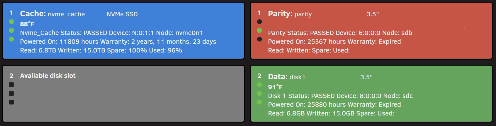

  1. @FlamongOle I updated both my servers to 2026.02.13 (and 2026.02.19) and wanted confirm: Commit #487 - BUG: Read/written values could be carried over from another device in some situations. Is fixed. Thank you for your hard work!
  2. @FlamongOle Happy New Year. I have noticed a bug in the last few versions of the app, my apologies for not posting this sooner. There is an interesting bug involving drive read writes. It appears that the first Data drive (disk 1) pulls the Read/Written data from the last NVME drive. Only Data Disk1 is affected, please see the screenshots below. This bug is also present in the on-hover of the dashboard version of the plugin. The bug is present in Unraid versions 7.1.4 - 7.2.3. Let me know if you need anything else. Thank you.

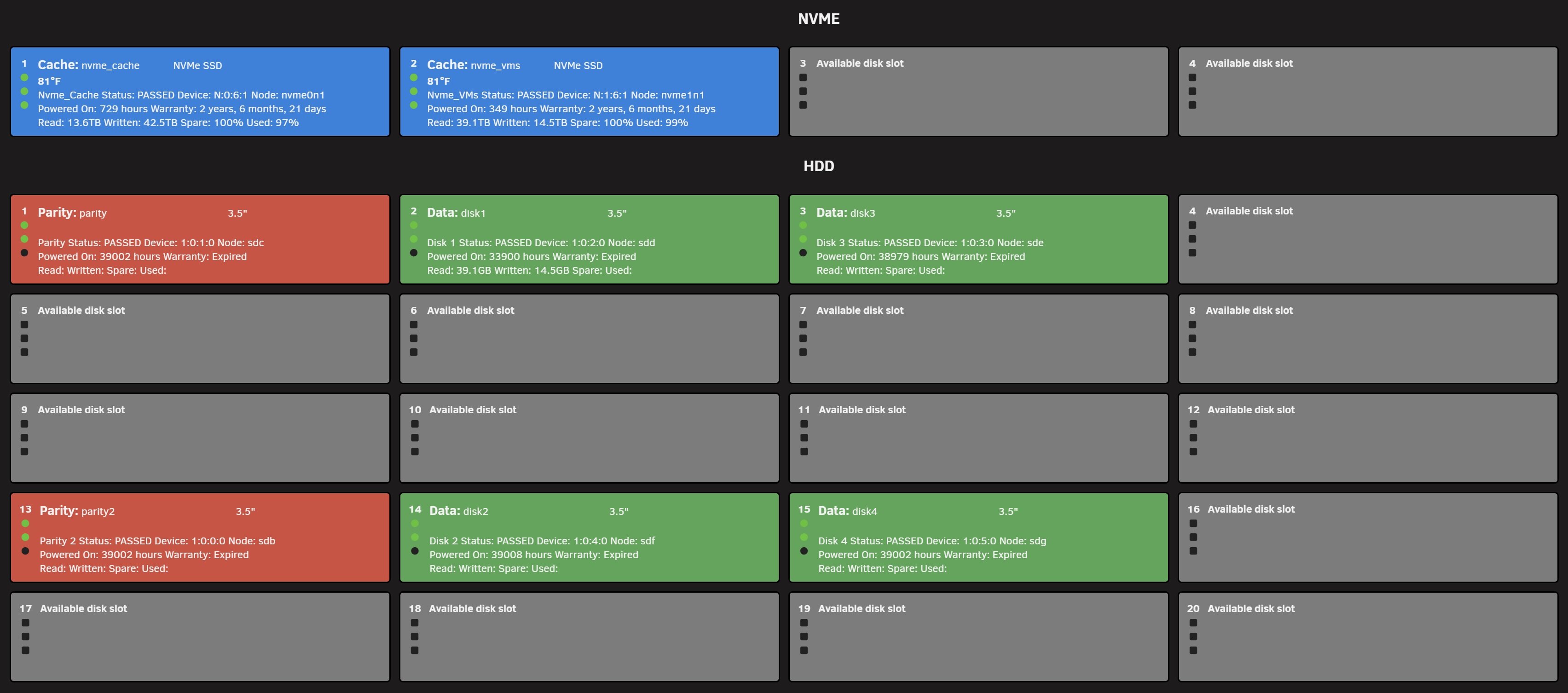

  7. @FlamongOle thanks for the manual backup info for this update. I updated to 2025.05.30, followed your steps for manual backups through UserScripts. The manual backups show up the same as the auto backups under the system tab. Below is the sample of the quick script I made to test and run the manual Disk Location backup through UserScripts. It appears to work fine for me but use at your own risk. 😁

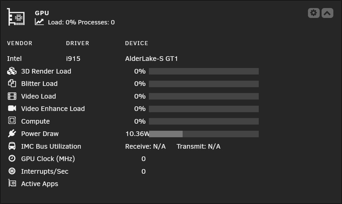

  11. @SimonF thank you for the fix of the device name in dashboard, much appreciated 😁. I noticed another area that could use a formatting tweak when you get a chance. For an Intel iGPU if the power draw line has 4 numbers in it, it pushes the "W" into the status bar. If the power draw line has 3 numbers the formatting is fine. Running 2025.05.17 version of the app on Unraid 7.01. Thanks!
