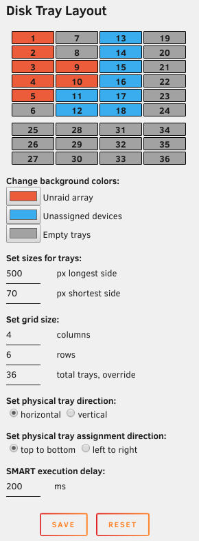

screenshot_04_config_override.thumb.png.197edb097412763eb393f9b110bc0daf.png2019.01.28 released: Added slightly better support for 36 tray servers and in general override tray optimization.
For 36 tray servers, set trays to ex:
Grid: 4 columns * 6 rows
Override: 36
This will make 2 sections, one for 24 trays and the last for the remaining 12: 4*6 + 4*3
Edited by olehj
