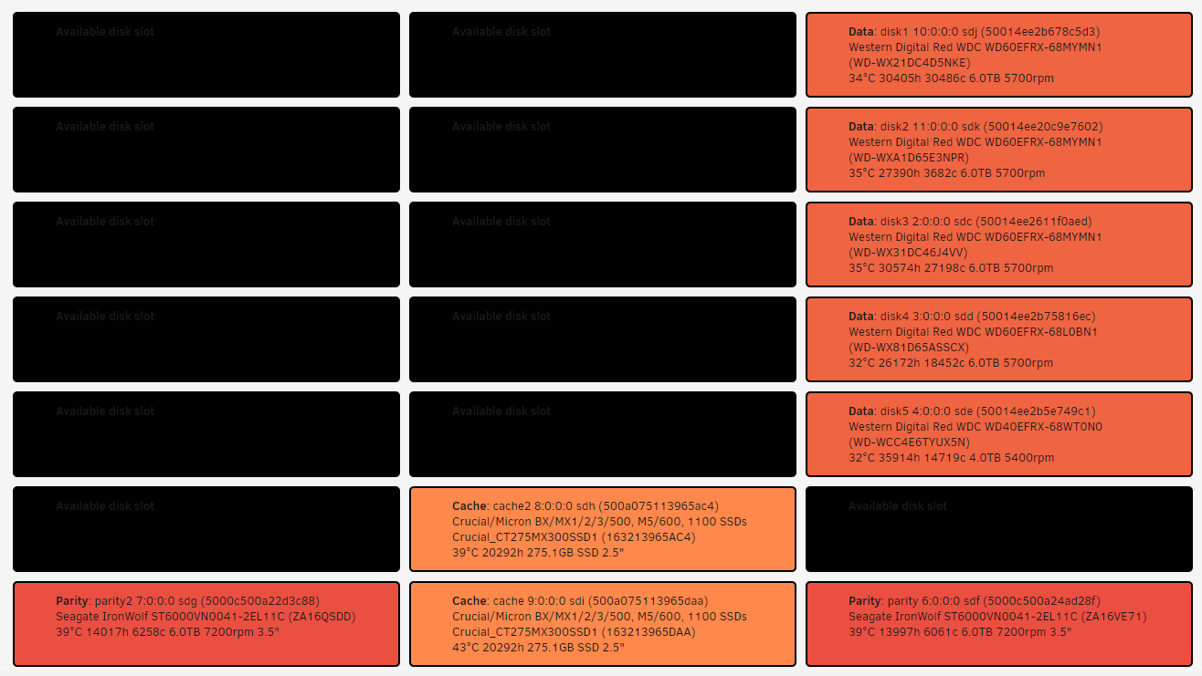

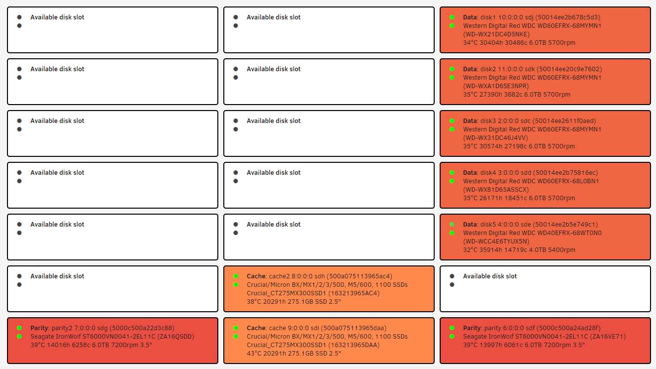

This is coming along nicely. One thing I would like is the ability to hide empty slots. In order to match my case layout, I have 7 rows x 3 columns, but there aren't really any bays to fill in many of these locations.

2 hours ago, olehj said:
Hiding empty slots won't happen as it will ruin the current design, empty slots are treated different from filled ones. Only way to hide empty slots is to assign them and skip the visible rows.
Maybe the word "hide" is where the problem lies. I don't mean hide it so that it doesn't take up any space in the layout. I want it to take up space in the layout. I just don't want the border around the rectangle or any contents in it. These are not "Available disk slots" inside my case. I don't see any way to make the override get me where I want to go.
Well, making the empty slots black is closer since the text can't be seen on that color.
Ah, well, that can probably be added in the nearer future. But it will be a simple config to hide the text and LEDs in that case.
Or simply change the frame, font, and fill of the un-assigned slots to the same as background color.
