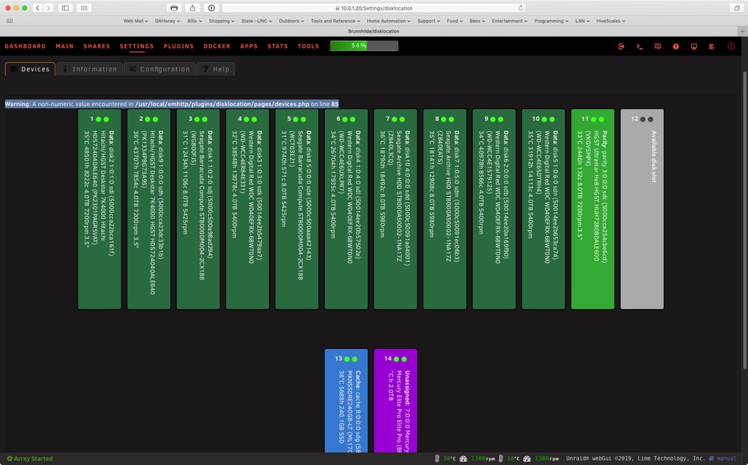

I've just been setting this plugin up for my 12 bay server. Entered a Total Tray Overide of 14 so that I could get assigned devices to show on the "Devices" tab. When I save this I get a php warning-
Warning: A non-numeric value encountered in /usr/local/emhttp/plugins/disklocation/pages/devices.php on line 85
Edit: Plugin version 2019.02.04
This is now fixed in the devel branch 2019.02.08a-dev, will be released at next stable.
