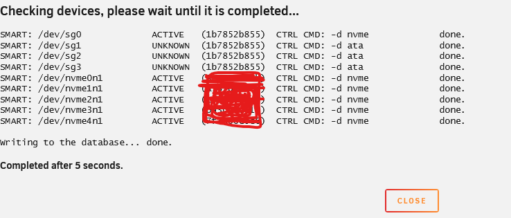

It finds my 5 Nvme drives. But my 3 SATA SSDs are missing in action. And it seems to add a 6th "ghost" Nvme.
When I run "Force Update All" I get the following:
So a few things:
1: sg0 doesn't exist in reality. There is no such thing. Yet it shows as ACTIVE? And to top it off, it shows as an Nvme?
2: sg0, sg1, sg2, sg3 all have the same ID? What is that ID btw? (1b7852b855)?
3: sg1, sg2, sg3 show up as UNKNOWN?
4: sg1, sg2, sg3 are the ones that does exist in reality. They're all SATA SSDs connected directly to my motherboard SATA ports. No extra controller or anything.
They're all Samsung_SSD_870_EVOs.
2 of them are 2TB and connected in Unraid with "Unassigned Devices plugin"
1 is a 500GB and is connected in Unraid as a normal cache pool.
Anything I can do to troubleshoot?
Bare with me. I'm a complete noob.

1 hour ago, PeterHS said:
I just installed this plugin for the first time.
So a few things:
I see that the "CTRL CMD" is active, but I don't really see the reason why it shouldn't just be auto detected. Per disk setting in Unraid, you might have set a "SMART controller type" manually instead of leaving it to "Automatic", maybe you must do it for a reason, but usually NVMe and SATA is auto detected. Also I think "ATA" is not really common these days anymore as SATA uses the SCSI protocol (correct me if I'm wrong)? Under "Disk Settings" (Unraid settings) you will find "Global disk settings", ensure "SMART controller type" is set as Automatic as well.
The sg0 is typically the USB drive containing Unraid OS.
Let the OS auto detect the SMART controller type unless you must specify it to work, but I think that's more common for special RAID cards and HD enclosures etc.
You are correct.
I have a PCIe to Nvme card for some of my drives. Because of that I had set default in Unraid to Nvme and for whatever reason the SSDs had turned into ATA. Turns out I could just force the 3 SSDs to Automatic and everything is as it should.
Thank you!
Solved!

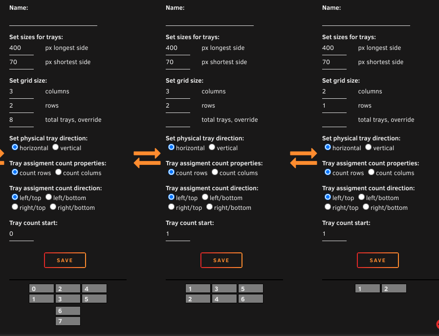

Firstly great plugin! very helpful
Now I have a slight issue with the columns/rows setup and was hoping there was an override somewhere i'm missing. My Drive layout looks like the picture attached, where bays 0-5 are in s standard layout but 6+7 are side by side and not ontop of each other.
Is it possible to override the plugin in some way so that my layout matches the physical one?
Thanks in Advance
Thanks in Advance
It won't match, is not intended to match all the various physical layouts out there, but the closest thing you can do is either create two separate groups (this will be closest to match the physical layout). Yon define the start number of each group.
Or you can set it up to 3 columns, 2 rows, 8 total, override.
examples:

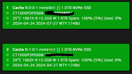

Hello,
I'm having this problem with Disk Location.
Both of my nvme cache drives, the manufacturer is not recognized.
I had a pair of Samsung before and I had to replace them.
Now, I can see the model but the manufacturer info is missing (Crucial Drives)
What can I do to force recognition of the manufacturer ?
