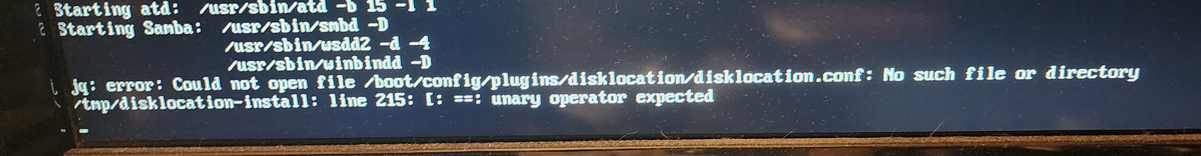

Had the same happen to me.  Server hung on a line saying that it could not open file /boot/config/plugins/disklocation/disklocation.conf:  No such file or directory...
- I booted into safe mode
- started the array
- installed the plugin from the link listed on the first page
- I then went into the plugin and to the System tab
- under System clicked on Force Update All.  It then created the missing conf file.
- I rebooted the server and the error was gone and it booted normal.20240321_025551.thumb.jpg.63a7d776b803dd1b632014b4dc46f428.jpg

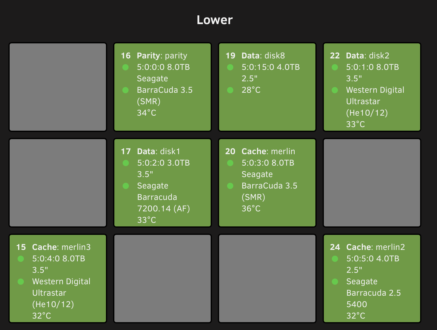

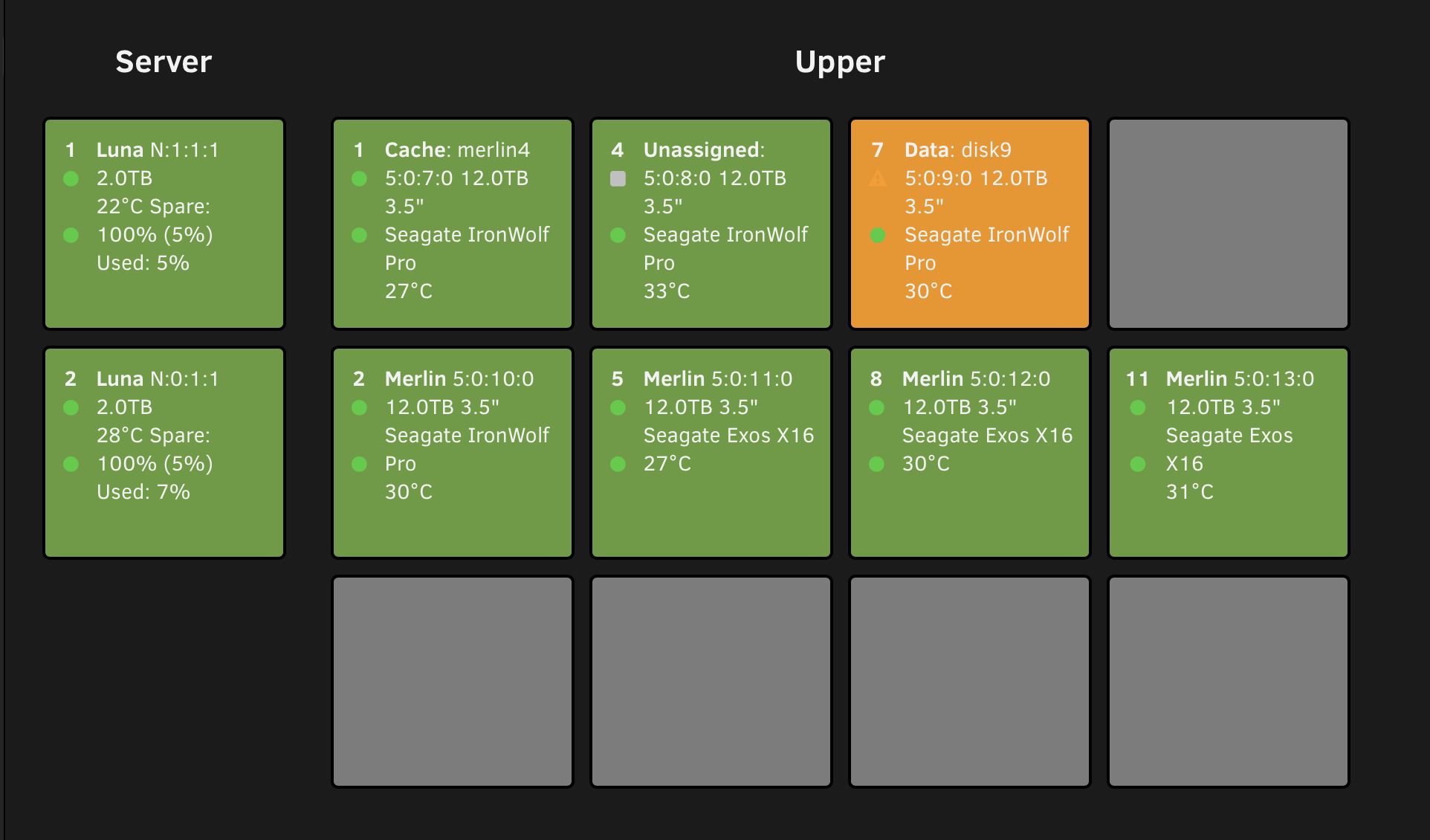

Had a disk fail.
Used this plugin to locate drive.
Then added 2x new drives in spare bays then rebooted.
For some reason it has messed up the disk location database.
Its labelling some drives as cache (I do no use the term cache) I have a luna, merlin & cctv pools.
Also why is it putting unassigned drives into the allocated bays?
odd.
Parity should be upper left corner.
There are only 4x merlin drives. It is saying there are more but putting them in cache...
moulin-rouge-diagnostics-20240408-1611.zip moulin-rouge-diagnostics-20240408-1512.zip
Edited by dopeytree
5 hours ago, dopeytree said:
Had a disk fail.
odd.
If the first name is either "Parity, Data or Cache", it is detected as a traditional Unraid pool. If it just has a name like "Luna" and "Merlin", it is detected as ZFS pools. "Cache: merlin*" and "Merlin" is not the same pool (or at least it shouldn't be).
Unassigned devices is only added if you add them there, for all I know, adding the new drives in the wrong slots might have caused this. Not sure how it would change anything otherwise. The serialized modelname+serialnumbers string are assigned to a drive slot (TrayID), and would not be moved anyhow by itself.
There has been modifications on how to prioritize the differnt pools, as for now the ZFS pools is sort of above the traditional Unraid array. It might be time to end the "traditional Unraid" way of labeling as they now allow for multiple pools etc. which was not a thing "back in the days." I haven't made up my mind what would be the best option here. There's more things to be updated and considered for this at this point.

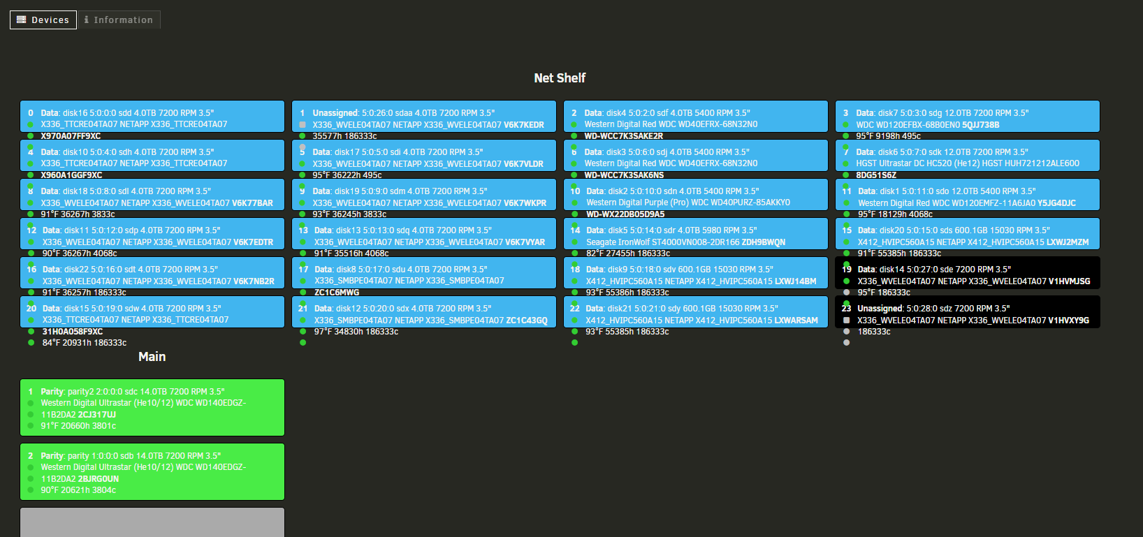

I may be overlooking something but I am not seeing any tabs other than 'Devices' and 'information' I can no longer configure or change any data. The below screen grab shows only the two tabs. Any help would be greatly appreciated.
Hard to say, which versions of things are you running? And anything special in system/php log files?
Edited by FlamongOle
