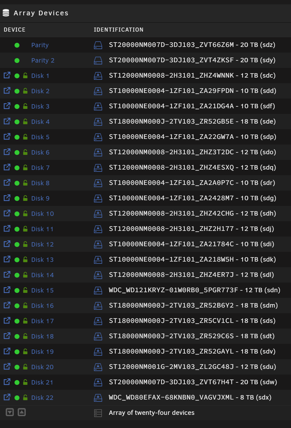

The diagnostics definitely show disk1 to disk22 present.   Are you sure that the message is not associated with disk23 disk24 which are not present.
23 and 24 is the Parity 1+2 above in my screenshot.
I am happy to report that all my drives is functioning in Unraid 🙂

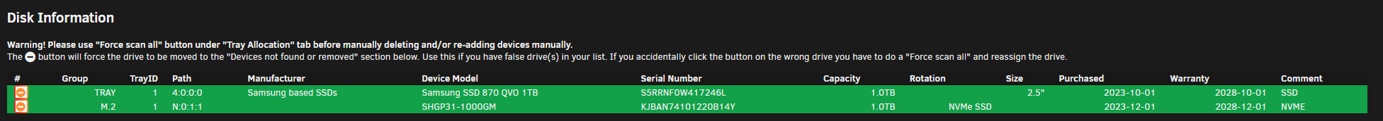

One of my hard drives shows most of the info, but it is missing the Manufacturer. I am so anal that this bothers me. Is there anyway I can add this so it shows the manufacturer? It is missing the part that says Seagate Exos X18. Thanks.

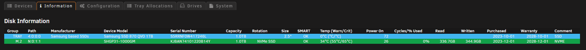

Apologies if this has been mentione before or addressed already, however, my array SSD temperature is not show in the dashboard whenever i restart my UNRAID host. I have to force scan all each time after a reboot for the temperature to be detected. It only does this for the single SSD that I have connected and not the NVME drive. Any ideas? Log attached.
After reboot -
After 'force scan all'
Also - update is always set to disabled after reboot. I have to set to hourly each time.

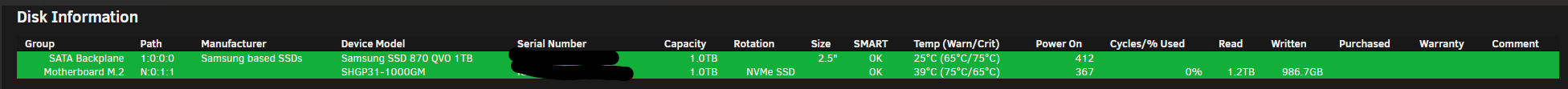

I have the strangest bug with this plugin i just noticed, i am not sure when it started but for whatever reason the plugin feels like one of my drives is "not present" yet it is detected in unraid and also detected in the disk location plugin itself so i can allocate it to a slot... Any ideas how to fix it? Unraid 6.10.3
EDIT: Force scan just fixed it
Edited by je82

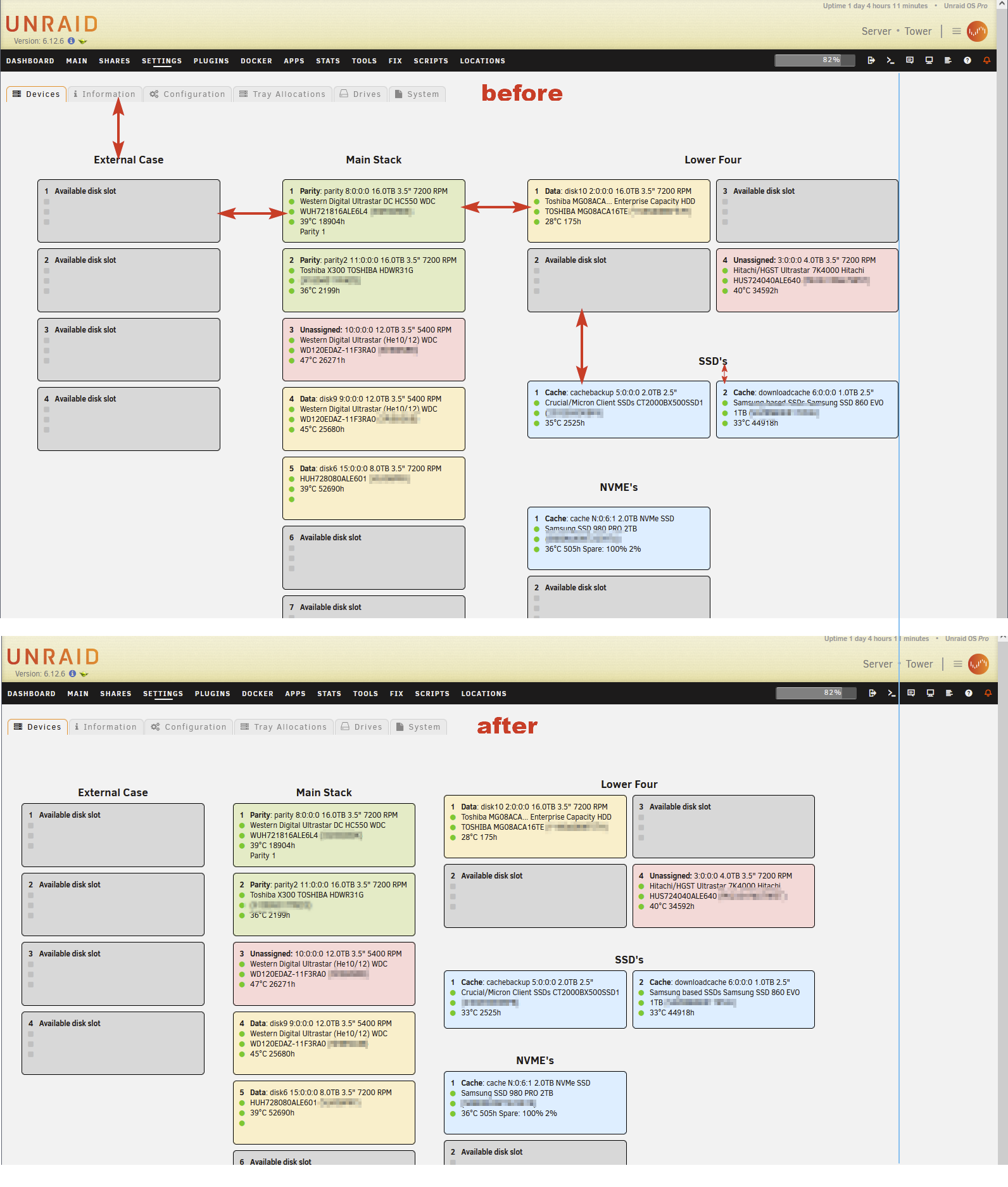

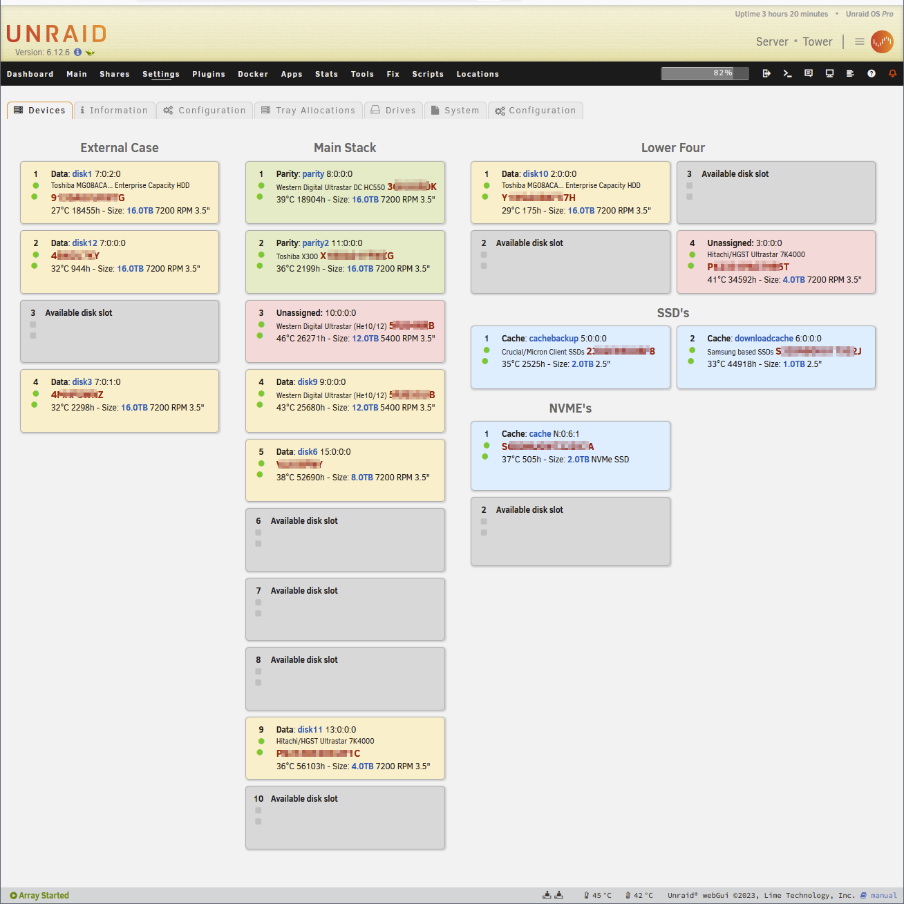

Hi @FlamongOle
Thank you for this very useful plugin.
If I may offer some visual design improvement ideas. Obviously the plug in is meant to help identify where the different drives are located within your server box. The typical way I search for a drive is by its serial number. Currently, on the main Devices page, it's kind of hard visually searching for the serial number among all the info that is displayed. It would be great to let the user change the font size, font weight, and font color of the Serial Number. Much like how you allow the color configurations. If this info is not easy to parse out, perhaps, with the Serial Number is always inside parenthesis, you can extract this and give it is own class name for CSS.
Second suggestion. Because of my server's layout, I have 5 separate Disk Tray Layouts. I find that the disk padding between the Layouts is quite large. This forces me to have to make my browser window wider than normal. Please consider either reducing the distances shown below OR add the ability for the user to control this like how you do w/ the colors. It would be nice to see more on the screen at the same time. Here is a quick mock-up;
Thank you again.
H
 I think I just entered The Twilight Zone.
At some point I do a refresh of the Disk Location Page.... and the changes I suggest in my post above are implemented!!! I am not sure what happened... I did reboot the server.
I had to spend time investigating. Turns out sometime last year, I manually edited files and stored them in /flash/config/plugins/DiskLocations. I have a script in my server that does some tweaking around. As part of this script, I have the below lines:

UPDATE #2:
The files did break the current version of the plugin. I cannot get into any of the Configuration screens.
I have edited the files from the latest release with those edits. I am attaching them here.
It's scary how I forgot I did this... and that after that script executed, all of a sudden, the changes are there.
Thanks!
disklocation_devices.page devices.php disk.css.php
Edited by hernandito

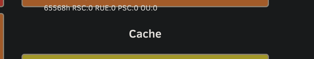

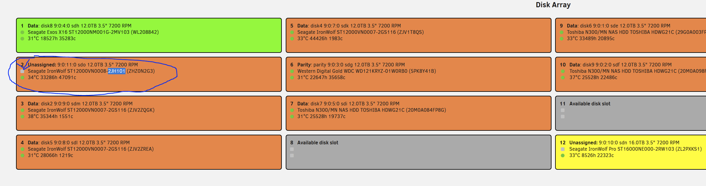

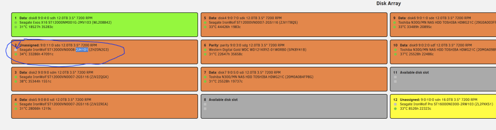

unraid 6.12.6 - after updating locations to 2024.02.10-o24, now i have a drive that is flashing which stops if i uncheck 'flash warning' but its not clear what the warning its trying to show... spun disk up, now instead of N/A it says 0 there.
<removed images>
1 1 1 are three different buckets, so i would imagine you would take the max value of all three buckets.. in this case 1 and compare to value which is less than 5.. so shouldnt be warning.
docs on the value and how segate does it
https://t1.daumcdn.net/brunch/service/user/axm/file/zRYOdwPu3OMoKYmBOby1fEEQEbU.pdf
** update ** per below, it was the plugin just not happy with the 'command timeout' value from segates. setting it to 0 to disable.
Edited by zoggy
8 minutes ago, zoggy said:
is the plugin just not happy with the 'command timeout' value from segates now?
I have this to. I set Command Time Out to 0 to disabled this lightning.

1 hour ago, zoggy said:
unraid 6.12.6 - after updating locations to 2024.02.10-o24, now i have a drive that is flashing which stops if i uncheck 'flash warning' but its not clear what the warning its trying to show... recheck and on hover its:
i'm guessing the warnings are from:
N/A would be the temperature of the drive, you might need to run "Force scan all" to get it back, if it has a sensor. The SMART warning message should be visible under the "Devices" tab.
Disable "Command Timeout" if you have Seagate, not going to make an exception for a manufacturer, or a series of devices. It's disabled by default in Unraid, and I might change that myself as default behaviour.
