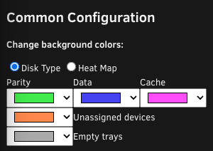

Minor bug I may have found.  Unless I just don't understand when the background colors should get updated.
I have 2 drives 1 that is parity, and one as an unassigned device, that both show up with the "data" color still.
Have you tried to go to "Tray Allocations" and check if the colors has been added as "Custom color"? They override the common config.
Also, you can try to "Reset All Colors" with the button at the bottom. If I remember correctly, this should only reset custom colors.
That was exactly my issue thank you!
I keep that window on a side monitor and never even noticed the custom color option as it was off the edge of the screen.
That reset fix it all.

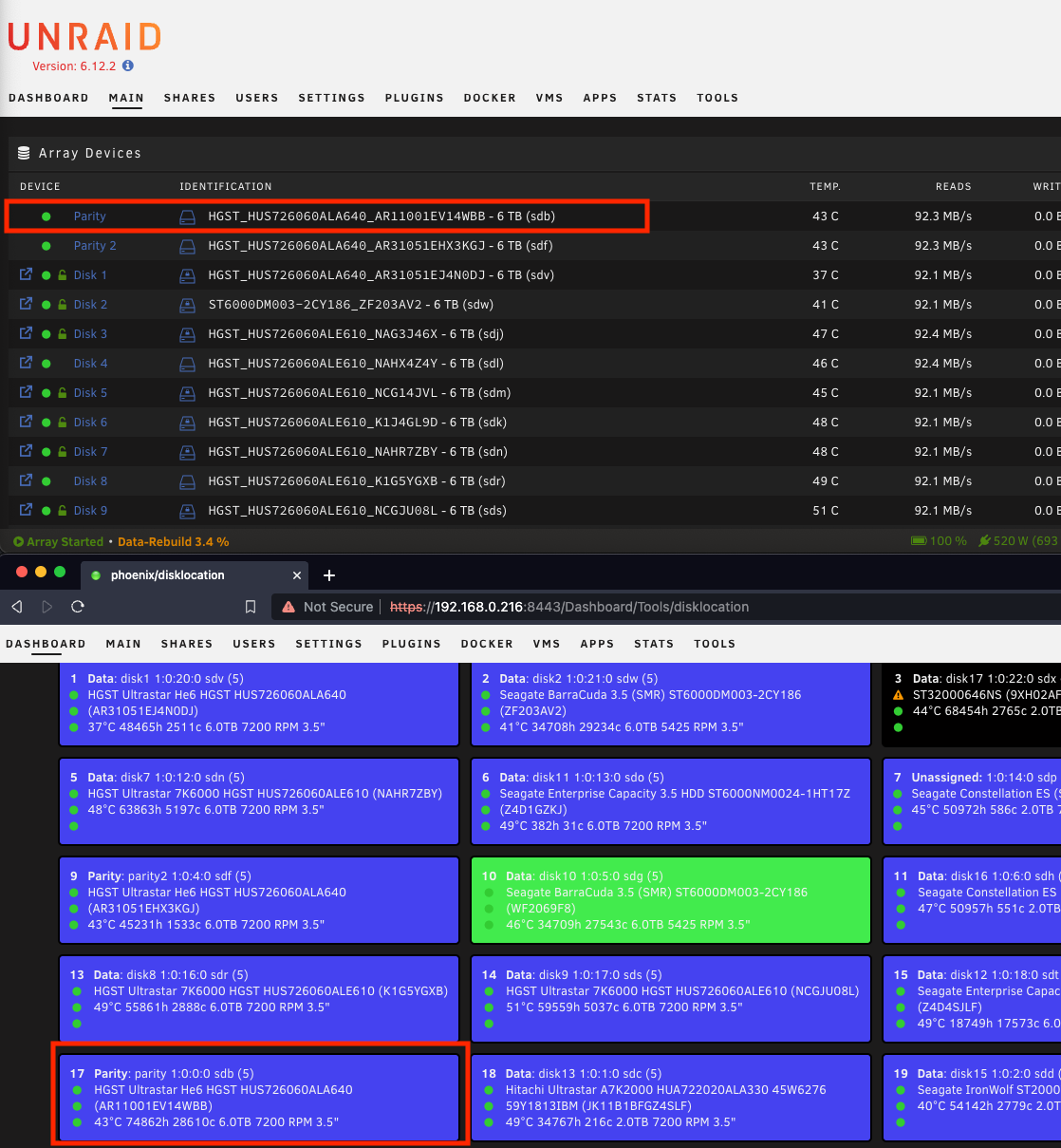

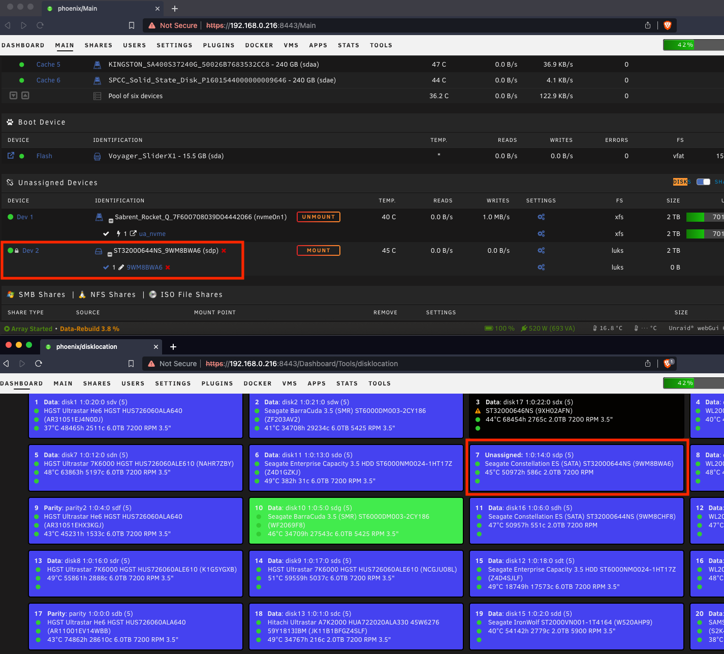

Found a bug with the main page mixing up the drives. It shows correct under all the other tabs.   See screenshots.
Mixes up the cache disks with the data disks.

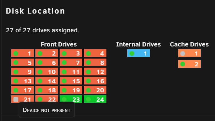

I recently noticed that I now have State "Device not present"
But all drive is running and working on Unraid?
I have tried running the scan but same issue?
Are you sure that Unraid has not disabled the device and is now emulating it?    It might be worth posting your system's diagnostics zip file so we can check there for a problem.
