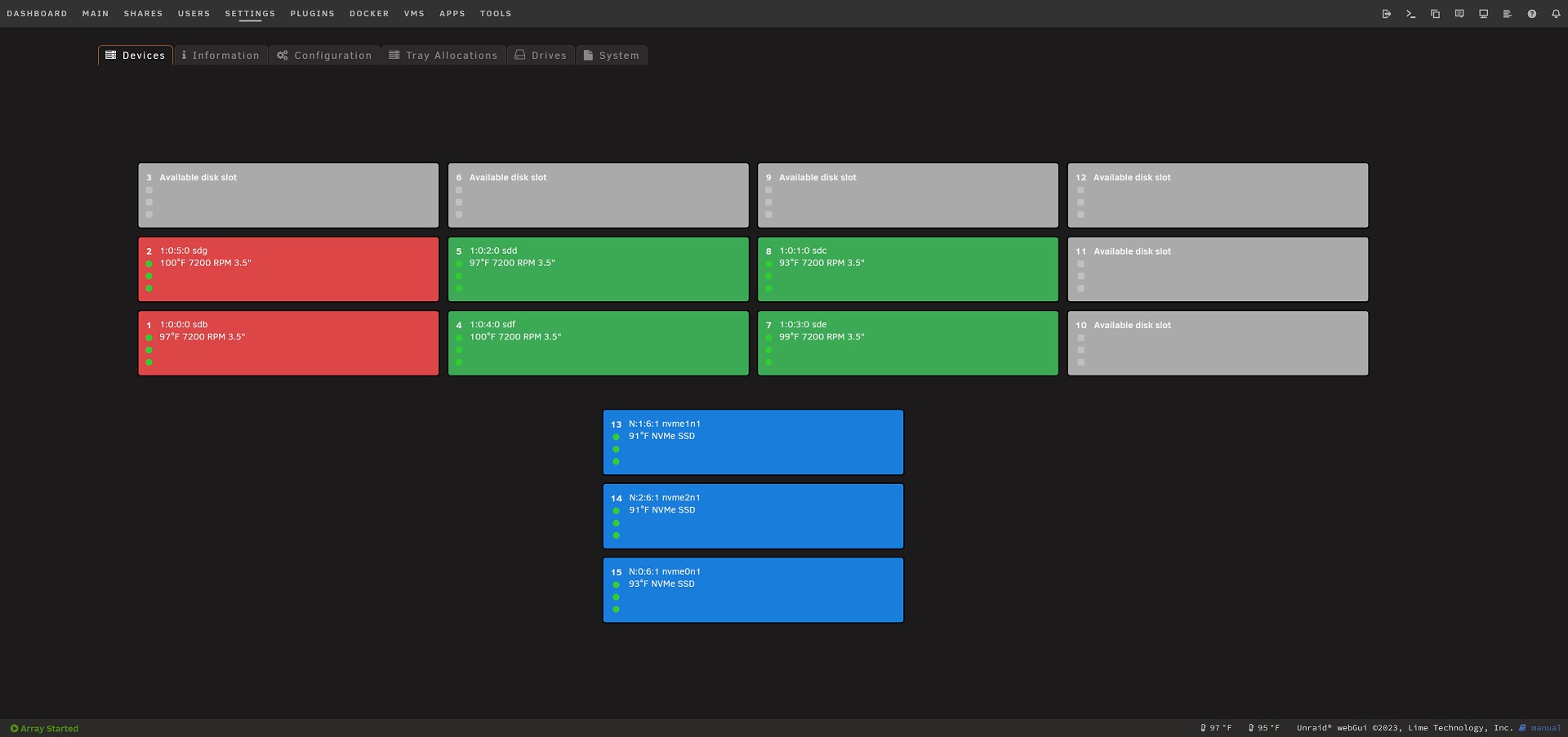

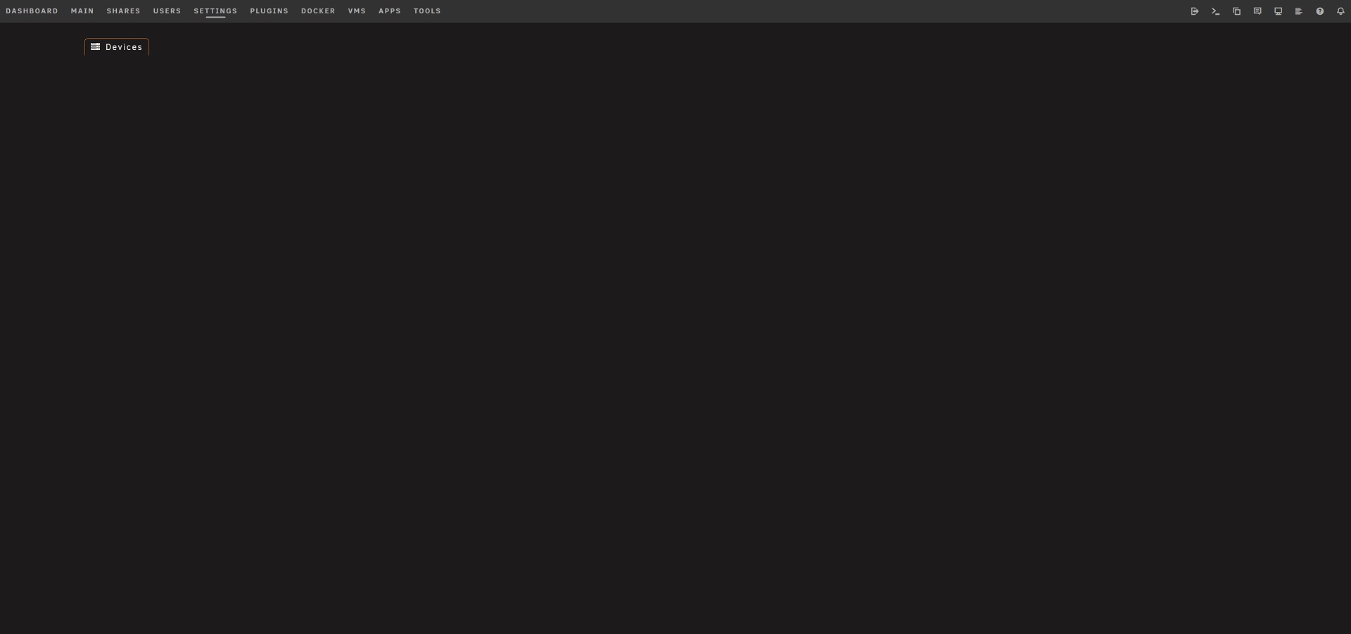

I pulled down the 2023.07.08c version this morning.  Unfortunately, like others I have same issue.  With the array spun down the dashboard is blank but there is a new issue the device tab in the app is blank too.  The app worked fine with 2023.05.30 only the dashboard was blank.  If I spin down a single drive in the array the dashboard goes blank and the device tab.  I tried Firefox and Chromium browsers and the issues were the same.  Let me know if you need a diagnostic.

I install this plug-in for the first time.  After saving the tray allocations I got a blank device page and the dashboard was also blank.  I had to uninstall to get the dashboard back.  Here is some debug info:

It's a known issue at this point.  If any of the drives are spun down, the dashboard and Disk Location device page will both be blank.  If you spin up all drives, they should re-appear.  At least that's how it is for myself and 1 or 2 others on this thread.
Update 2023.07.17
  •  Commit #224 - MAJOR ISSUE: Fixed a Dashboard crash when all drives were spun down.
Try now guys, hopefully this'll fix it. Sorry for the delay, haven't been home for a while.
@Mat W @krh1009 @Revan335 (USB drives are mainly not supported) @SShadow
@FlamongOle - I can verify that my dashboard (and Disk Location settings tab) now work when disks are spun down!!  Thank you for all your hard work.  As promised, beer money sent. ;-)

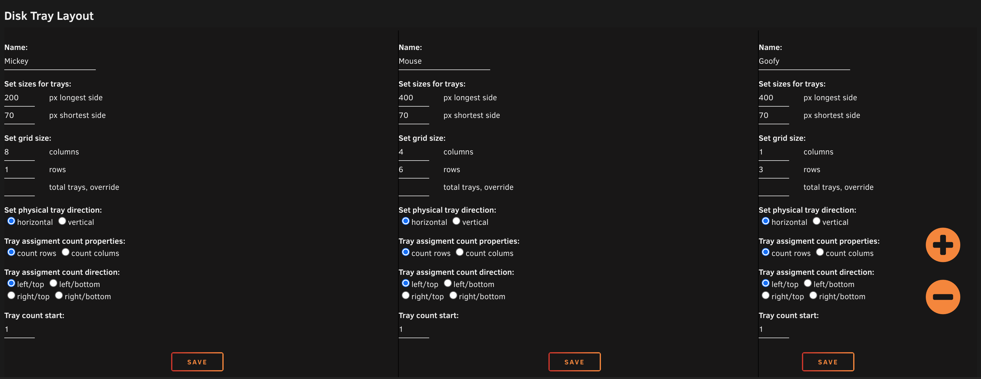

Hi, I was wandering if there is a way to delete one of the 'Disk Layouts'. It seems that I can only delete the last layout with the + - Signs but not able to custom select another layout like "Mickey" here in the screenshot. 1646628260_ScreenShot2023-08-09at11_53_19.thumb.png.2af71265b67c216b0f42da4d5d4f10d0.png
Sadly no. Might be something to add in the future, but no ETA or really any time atm.
